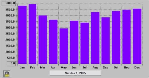

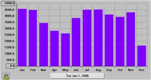

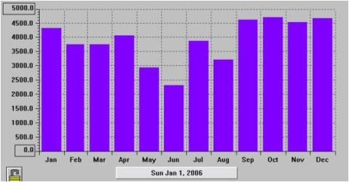

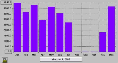

I think it may be interesting to show some recorded wind data from where my mills are situated. These are on the southern Fleurieu Peninsula, near Victor Harbor in South Australia. I would rate my wind site as OK. There are 4years of data, in some graphs. The data is Wind Run. This is an accumulated amount of the total wind that has passed a point in the timing period measured in kilometers.
There is some lost data in 2007 when the recording computer died. The logged data is at 10 minute intervals from averages taken from a 1 second update rate.
The wind is well proportioned during the year. There is no time without some wind. There is less wind during the winter months, that may seem odd.
I recorded the weather data for 12 months before deciding a windmill would be viable for useful power generation and not just an ornament.
I would recommend some data collection at the selected wind site prior to building or installing a windmill. I have seen some windmills that are ornaments, that have been paid for with tax payer dollars.
Gordon.

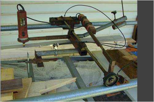

here is a photo of the business part of the copy machine. The main rails are shown, and the travelling router with stylus and counter balance.
This is a 1hp, 37000rpm router.
I have to set up the original with blank. The posts [far right] are for precise alignments.
Gordon.

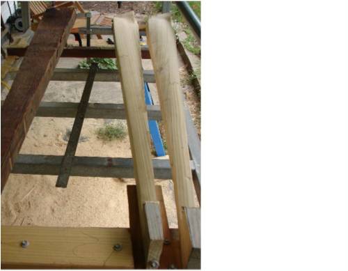

Posted: 08:19am 25 Dec 2008
Well, I have made a start with making blades. Here is a picture of the two templates, the left light coloured one is mounted, as is the blank on the left, for shaping. The photo does not really show the twist and undercamber very well.
The douglas fir cuts quite well, but does splinter. The last pass will need to be fine.
Will upload a photo when a blade is finished prior to painting.

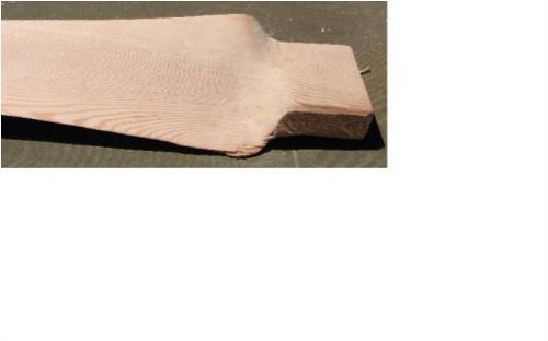

I have made a test profile from the two templates.
here is a pic, of the business end.
The machine is not CNC. I would imagine this type of application would challenge any programmer. I have found that the rough process would be difficult with CNC. I have made jigs for each half, to aid the alignments of the two halves. I went 0.5mm too thin, so this will be adddressed in the next blade.
I use an older cutter for the roughing. This is changed to a new one for the last pass. A light sand, and the blade is done. The flat mounting surface worked out well.
The blade has taken a bit more time than I hoped. The weight has come in at 690g. This will go up a bit with sealing and painting. This is less than the 1kg that I had estimated. The blade has come out at 1.35m long, so this will make a rotor of 2.9m dia, once bolted to the rotor hub.
I am hoping that the blade design will give a higher rpm, so I may have to use the series 80 rewire. This may increase the power to the magical 1kW, if the rpm increases from the 440rpm to above 500.
The blades on the machine are currently 1.9kg each. The mill should be more responsive with the new blades.
