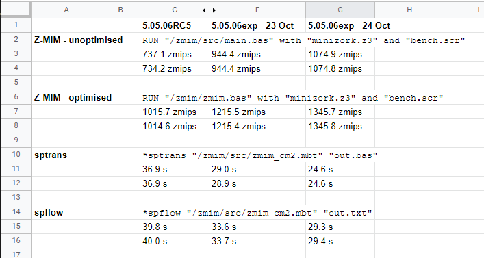

Posts: 4398
Posted: 01:09pm 24 Oct 2020

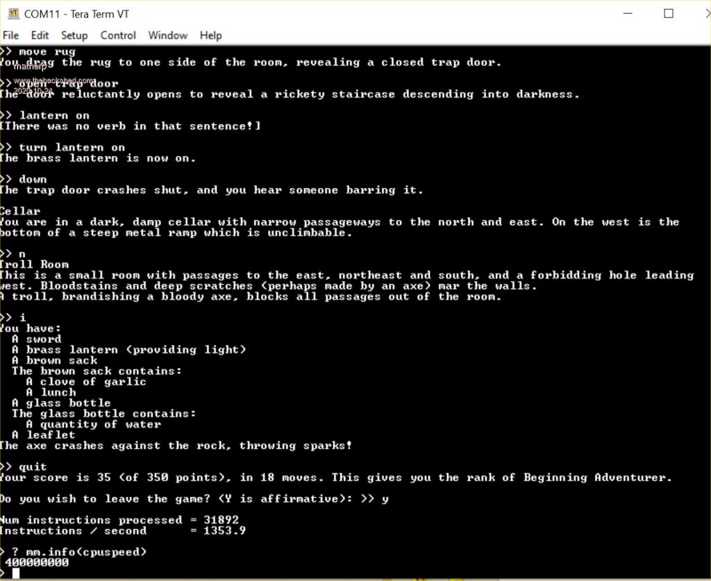

Very impressive, the unoptimised version of Z-MIM now reaches 1000 zmips.
I don't suppose there is any chance you'll stop now so that I can smoke test the Welcome Tape against a fixed target ?

OK, not sure this is the same bug but, "A:/crash.bas"
Function we.wait_for_key$()
 Local k$
 Do While k$ = "" : k$ = Inkey$ : Loop
 we.wait_for_key$ = k$
End Function
Play MP3 "TweakerRaySpaceFlight-160kb.mp3"
 k$ = we.wait_for_key$()
Download the MP3 file here: https://github.com/thwill1000/cmm2-welcome/raw/develop-r0.5/menu/TweakerRaySpaceFlight-160kb.mp3
1. EDIT "crash.bas"
2. F2
3. System fault
Doesn't happen if you just RUN "crash.bas" from the command line.
