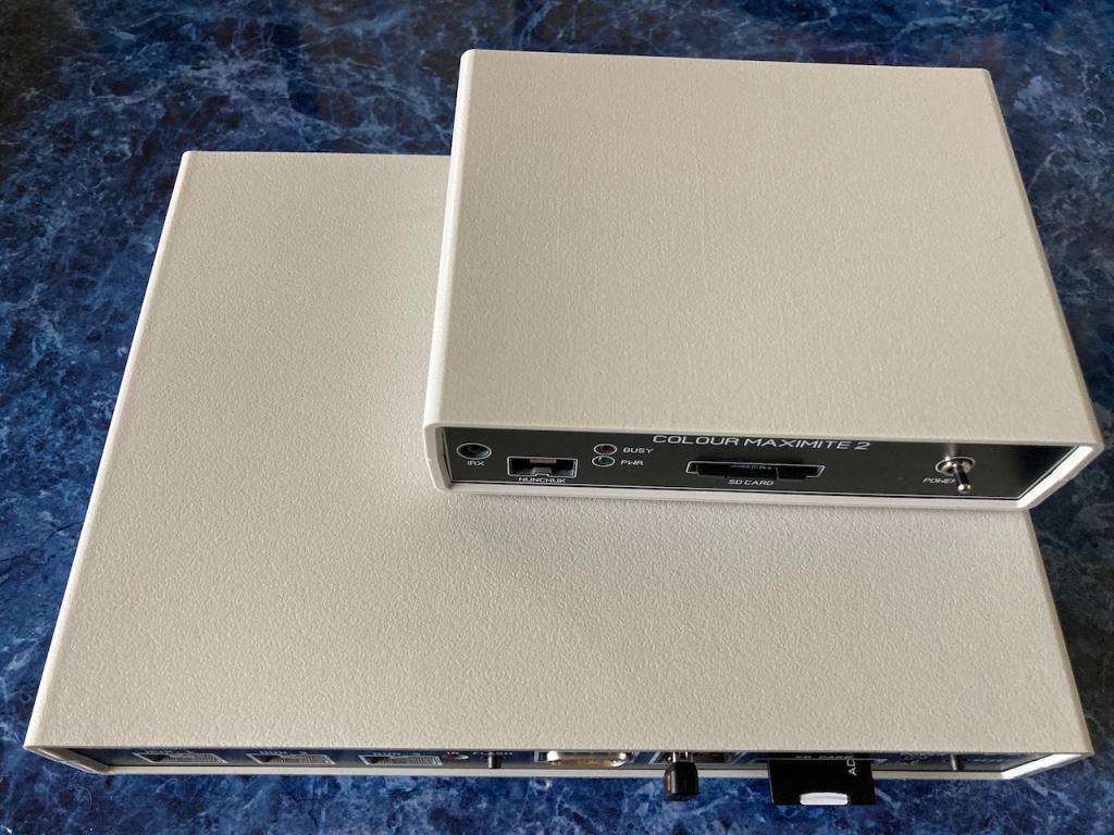

Thanks Piotr,
I have got the CMM2 deLuxe on Wednesday (ordered on Saturday), so I'm just putting here my experiences. In general I'm very satisfied with the buy. I will play with different FW for ESP, because this one is just for basic playing but is base for improvement. So here are my first impressions:
POSITIVE
• very fast shipping
• perfect packaging
• both USB A-B and A-A cables included
• SD card included
• Napoleon Commander serial communication works (python server needs change port name...)
NEUTRAL
• it didn't work with included A-B cable, picture is on the monitor, but keyboard not working (tried more sources, no change) - for me is neutral, because can be because of my enviroment
• tried 2 mouses, 1 works, 1 not
• WIFI firmware is really more for C64, but because in socket, can be easily flashed with something else
• SD card socket is different (not with spring) -just for info
• is VERY big compared to my other CMM2 (I didn't expect it)
NEGATIVE
• firmware update needed A-A cables (errors with A-B virtual serial), very complicated with MacOS (done through Windows virtualisation)
Jiri

Posted: 03:16pm 26 Dec 2020
  jirsoft said  Thanks Piotr,
Hi
Thank You for Your comments, Im happy that You reveived the unit safely. I would like to make replay to some of Your feedback:
Please tell me more, is it USB cable issue? If Yes I need to change supplier of that cable!
  Quote  • tried 2 mouses, 1 works, 1 not
Unfortunately not all mouses will work, the same as not all USB keyboards work on all maximites (original or not). Basic rule is more simple mouse or keyboard is, bigger chances are that it will work.
  Quote  • WIFI firmware is really more for C64, but because in socket, can be easily flashed with something else
I used Zimodem firmware because everyone wanted to connect with BBS, that is why I install it. Try it, it is a lot of fun! As You mentioned module can be unplugged and reflashed. The newest maximite version that will be available in January will have a possibility to reflash the WiFi module without taking it out. It will use Maximite hardware to do it.
Im the only one who hates spring SD sockets? :)
Unfortunately I was not able to pack so much features in smaller case, giggest issues much more ports that are added comparing to original there is still some space to add more in distance feature, like HDMI. An there might be more to come...
I would like very strongly replay to this comment as all units are tested for this method of flashing and I never had any issues with it. Please check this and return with Your findings, if still have problems with this method please contact me via email we will solve this problem together.
1. First of all please check different cable (maybe this one which Im adding is bad?)
2. Please follow flashing instruction explained here:
https://www.thebackshed.com/forum/ViewTopic.php?TID=13005&P=4#161071
Edited 2020-12-27 01:26 by siwypiotr
jirsoft
Joined: 18/09/2020
Location: Czech Republic
Posts: 533
Posted: 08:45pm 26 Dec 2020
Looks like it's the problem with cable, because my others cables are working well. The supplied one is powering the device and how I said, picture is shown on the monitor, but red LED not glows and also the green one is dimmed.
With the mouse it's OK, I have expected some issues here as you said...
I don't think ESP have to be programmed without taking out. Because of OTA, it's enough to flash it for example with some Basic OTA  + WIFI MANAGER. This will allow from the start to connect to everyone WIFI and be programmed from Arduino Studio Over-the-Air (for example with Zimodem). And yes, Zimodem is OK for communication with BBS, but better will be some basic WIFI library usable from MMBasic (TCP, UDP, maybe NTP..._) - I'm already trying to prepare something.
For me it could be more interesting (when you are planning some changes) to test and use SPI connection. It should be much faster then serial and with WIFI you can use the speed. But it will need some more pins on ESP side (NodeMCU?). I will try to compare speed over serial and SPI over the next weeks.
SD card slot is OK, I just mentioned it so everyone knows. You are right with spring loaded ones, but it has also some advantages - I have few SD with half length and the are much easier to remove with spring...
Size is also OK and I understand the reasons, I was just surprised by difference. Maybe the size should be somewhere on you web.
I know how to flash, but because I have Mac I'm using STM CLI version and I don't know how to use it with A-A cable. With A-B cable it's working with my other CMM2, but not with yours new one:
/Applications/STMicroelectronics/STM32Cube/STM32CubeProgrammer/STM32CubeProgrammer.app/Contents/MacOs/bin/STM32_Programmer_CLI -c Port=/dev/tty.usbserial-AD0JHH4Z P=NONE -W CMM2V5.06.00.bin
And cable it's OK, I'm using the old one and it's working with your CMM2 and serial communication (tested with copying SD card with Napoleon Commander).
So at last when somebody knows, how to use STM CLI tool with A-A cable, then it's much better. With included A-A cable and STM software over virtualisation it worked without problems (and it's really fast), but not everybody has on Mac (or Linux) virtualisation just for flashing CMM2. That's the reason I have write it...
How I said, I'm overall very satisfied (and I will use the inner space for next ESP with SPI connection).
Jiri

siwypiotr
Joined: 18/08/2020
Location: Poland
Posts: 127
Posted: 12:09pm 28 Dec 2020
Thank You for Your feedback, some more comments
Yesterday I had other customer from Poland telling me the same. 1 minute after I scraped all the cables I bought recently... They look very professional but it seams that quality is terrible. I already purchased different cables to be included in the set. Sorry for any problems this created.
I don't think ESP have to be programmed without taking out. Because of OTA, it's enough to flash it for example with ...
Good point, next units I will ship with OTA
I agree, please let me know about Your findings as I currently work on new design and I can implement on test batch.
Of course You are right, I will update web page with this information
I know how to flash, but because I have Mac I'm using STM CLI version and  ...
So You are using MAC for flashing? This might be the problem. For serial flashing interface I used original FT232 chip from FTDI company, original uses Chinese replacement. Try to update drivers for FT232 (I do not  use MAC so I do not know if that is even possible to do).
Once more thank You for Your feedback, I will be happy to hear about Your experience with SPI.
