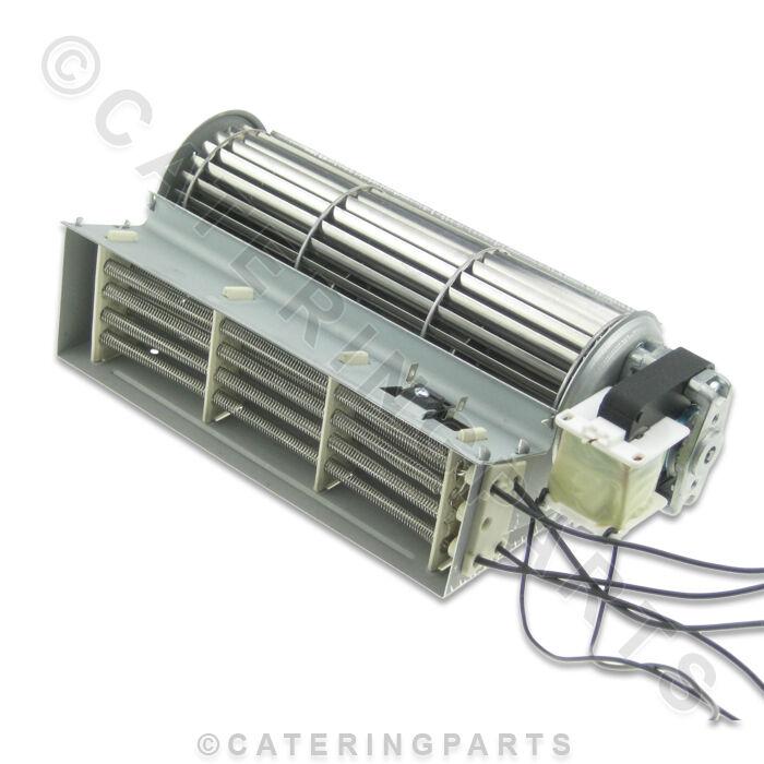

  Quote  The other idea is a way to measuring the actual heat output.
If you could fit an electric heating element to the hot air outlet, and adjust the electrical power so that the final total temperature rise was exactly doubled, the electrical power input should then be equal to the solar power input.
Again a cheapy e-bay plug in ac wattmeter might be the easy way to do that, along with a variac which I believe you already have. Just subtract the no load idling power of the variac from the final power reading, should be simple enough.
The bare heating element from a fan heater might be pretty ideal. Should be able to buy a dead one from the local rubbish tip for a couple of dollars.
With fairly simple basic equipment it should be possible to record some rather useful numbers.

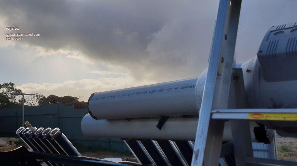

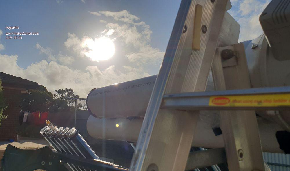

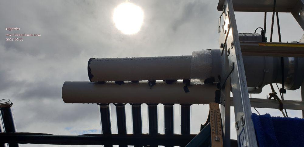

This morning before measuring anything, I pulled the tubes out and retrieved the one that fell through.
I drilled through near the top of each tube and once I pushed them all into the manifold again, I fed a 1mm copper wire through them all so they cant slide through. I doubt I'd get away with dropping a tube into the glass too often.

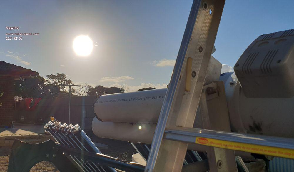

Forecast is for 19 today with some rain  ...  and it is overcast 100% cloud and quite dark  ...  and has rained a little.
12:19pm temp inside manifold with no fan yet = 33.3  ...  Ambient = 16
Fan on  ...
12:20  ...  44.6  ...  took a minute to climb to this
12.22  ...  38.6
12:27  ...  34.2
12:31  ...  32.4
12:43  ...  28.7
12:47  ...  27.8
1:10   ...  26.5
1:53   ...  22.9
It's still quite dark and gloomy with clouds in front of the sun.
The temperature inside our house is 19.6 at the moment  ...  so I don't know if a breeze of 22 degrees would help very much  ...  but there was a really useful amount of heat earlier for probably an hour.
And on top of it, there are only 6 tubes plugged in  ...  and for my first working unit I want to fill the rack with 18 tubes.
Can I assume that I should get 3 x the heat energy from 3 x the number of tubes?
Lots of clouds blocking my heat!!!

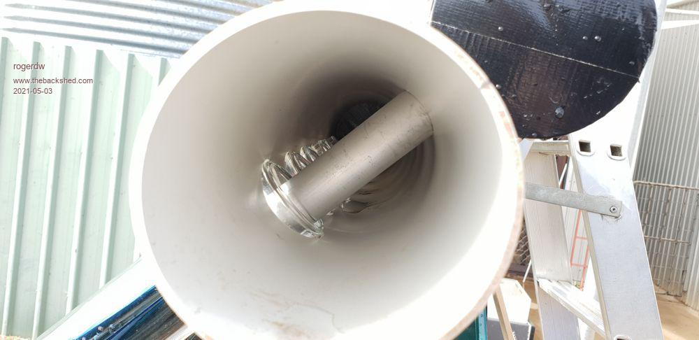

Looking into the air outlet

  Quote  Might be good to enclose the element and put it in front of the tube fan so there was a positive airflow through it to make sure it didn't overheat.  Unless it was more or less enclosed, I perceive the air might try to go around the element and not cool it sufficiently.
Probably better to add extra heat after the tube fan and solar, that way it doesn't effect how the solar functions on a cold day.
The heating element should be totally enclosed, it does not matter if some air sneaks past. Once the air is mixed in a decent length of pipe, all the heating power will go into the air, and it should be possible to get a reliable repeatable result.
Another use for the fan heater might be to just run it as a fan heater for a while, and judge how effective 2.4Kw of hot air warms up the living space.
Then you have some basic numbers to judge the effectiveness of the whole thing before you go to the trouble to build it all properly.
Can you expand a bit more on that please Tony, I'n trying to picture just how enclosed the element might be  ...  and with what.
  Quote  Another use for the fan heater might be to just run it as a fan heater for a while, and judge how effective 2.4Kw of hot air warms up the living space.
Yes, makes sense. I do need to find a fan heater and play around with it a bit to see just what volume of air it displaces and what actual temperature come out of it.

3:42    ...  18.3  ...  big thick clouds covering sun .. see photo
3:54    ...  23.4  ...  clouds just about clear of sun .. see photo
3:57    ...  24.2  ...  full sun at last

I went in to grab a coffee at 3:42 and there were thick clouds covering the sun again  ...  and I was surprised to see it as low as 18.3 degrees  ...  see photo of clouds.
When I came back out with my cuppa 12 mins later, the clouds had moved and sun breaking through  ...  again see photo. It was encouraging to see the temp back up at 23.4
A few mins later it was full sun which added .8 straight away.
I have to admit I was a little surprised to see the sun so far around to the west already by that time  ...  so really only hitting the array at less than 45 degrees.
I think I walk around with my eyes shut most of the time.

Posted: 10:53pm 03 May 2021
  rogerdw said
If you pull the guts out of a fan heater, you usually end up with something that looks pretty much like this:
If the motor and rotor are removed, and the whole blower housing cut away, you end up with just a metal frame containing just the heating element.
The whole thing needs to be totally enclosed by your pipe somehow, so all of the heat is transferred to the moving air. None of your heater should be exposed directly to outside air.
So basically your big plastic pipe going into a rectangular box of some kind, containing the heating element, with another short length of plastic pipe down stream to mix the heated air so you can read the overall final averaged air temperature.  Some air will go through the heating element, and some may leak around it, but that does not matter.
The heater box could be made from just about anything, plywood and duct tape might be the simplest.  You are not likely to be running the full 2.4Kw initially, and if you ever need that much power, there should be enough airflow to prevent the whole thing from catching fire or melting down.
Fan heaters do not blow huge volumes of air, and you should have enough airflow to prevent the element burning out.  These heater elements have a built in bi-mettalic over temperature cut out anyway in case the airflow gets blocked.  So it should be able to protect itself if you keep the existing cutout switch connected in series with the element.

Several fan heaters I have are just Fans with an element sat in front.  They can be had for $20 in many places, Kmart seems to have really cheap electrical stuff or you could try the bargain shops.
Might be possible just to  remove the fan blades and put the rest in line or take out the element. Must have some Heat resistant support.
You are certainly Correct about airflow Tony. Those fan type upright style units would barely blow out a candle from 10 Cm away. Having measured mine the other day, I noticed it is marked 2400W but only does High 1800's flat out.
The ones with a blower seem to be the better units and the fan ones are more like a spiralled element spread out to the approx size of the fan blades.
I think these may be easier to Modify.
You could have a look at what you have at home Roger and go buy a new one and cannibalise the old one so the Chief of Domestic affairs and corporate Finances is not displeased.
Thanks Tony, I get it now. It was the fully enclosed part that had me wondering.
  Quote  Fan heaters do not blow huge volumes of air, and you should have enough airflow to prevent the element burning out.  These heater elements have a built in bi-mettalic over temperature cut out anyway in case the airflow gets blocked.  So it should be able to protect itself if you keep the existing cutout switch connected in series with the element.
