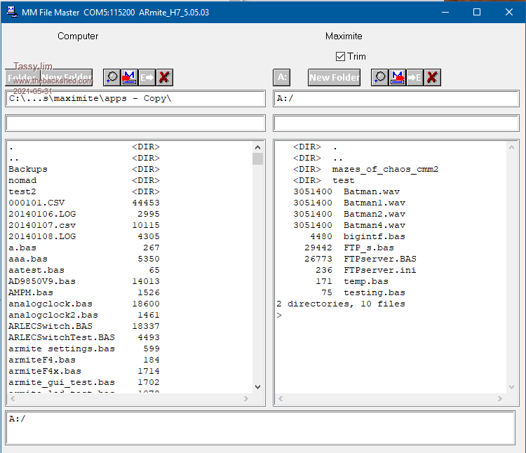

Posted: 02:43am 31 May 2021
Now I have updated the DLL that MMEdit uses, I can talk to the pico
The File Manager seems to work without jumping through any hoops.
Just select ArmiteH7 as the syntax.
Required DLL
LBcoms.zip
Put it in the MMEdit program folder
Even if this doesn't go any further, it has been an interesting couple of days...
Edited 2021-05-31 12:43 by TassyJim
