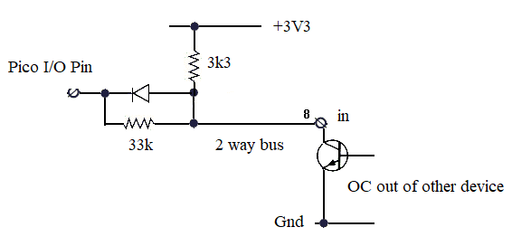

Posts: 3327
Posted: 01:41am 03 Jun 2021
Re no OC output state:-
Just put a schottky diode in series. Polarity depends on whether load is connected to + or -.
Re tristate leakage:-
If driving a transistor or FET put a bleed resistor from base / gate to ground.

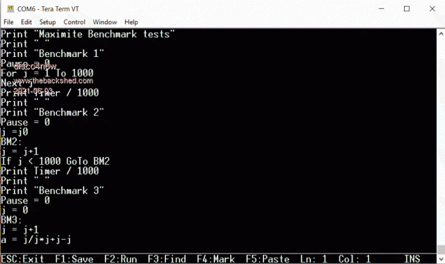

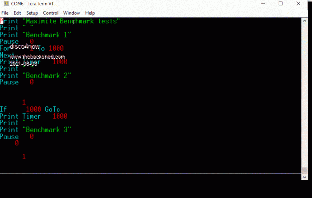

Posted: 06:27am 03 Jun 2021
Colours showing as BLACK in EDIT when OPTION COLOURCODE ON set.
Using TeraTerm certain colours are not visible/black in Teraterm. Teraterm with same settings is working on the F4.
The menu line along the bottom is not visible, normally a red colour I think.
e.g.
OPTION COLOURCODE OFF
F4 H7FotSF4xGT
Posts: 3327
Posted: 06:30am 03 Jun 2021
As the Pico doesn't have OC output there is a chance, on a 2 way bus, the other device could go low while the Pico output is high. This circuit will provide protection.

Posted: 07:27am 03 Jun 2021
  disco4now said  Colours showing as BLACK in EDIT when OPTION COLOURCODE ON set.
Try setting the Tera Term background to grey. I think you'll find that the bottom line stuff is black and isn't showing up on the black background. IIRC I had exactly the same problem with something else - it might have been the the F4.
It's pretty easy to tweak the TT colours.

Posts: 8981
Posted: 07:52am 03 Jun 2021
  phil99 said  As the Pico doesn't have OC output there is a chance, on a 2 way bus, the other device could go low while the Pico output is high. This circuit will provide protection.
or you can play in software:
setpin x,dout
pin(x)=0
setpin x,din  'pin(x) is effectively OC
setpin x,dout 'pin(x) is low
setpin x,din  'pin(x) is effectively OC again
Edited 2021-06-03 17:54 by Mixtel90
