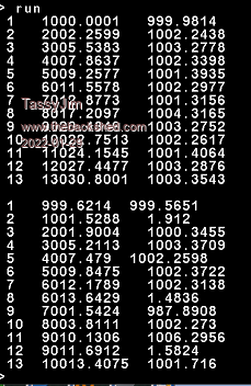

TIMER looks good.
PAUSE is usually used for >100mS pauses so is usable as is.
SETTICK fires very quickly at irregular intervals so is not very useful.
 DIM FLOAT starttime, laptime, midtime
   starttime = TIMER
 midtime = starttime
 k = 0
   DO
   PAUSE 1000
   ping
 LOOP UNTIL k > 12
 PRINT
 starttime = TIMER
 midtime = starttime
 k = 0
 SETTICK 1000, ping
 DO
 LOOP UNTIL k > 12
SUB ping
 INC k
 laptime = TIMER - midtime
 midtime = TIMER
 PRINT k, TIMER - starttime, laptime
END SUB

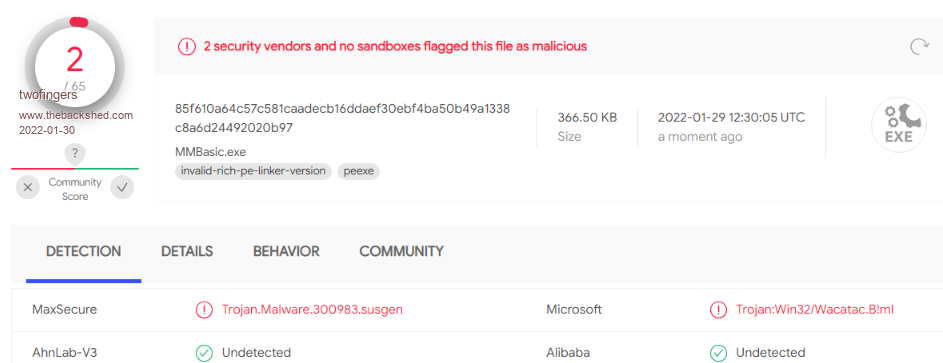

  TassyJim said  I am having intermittent startup problems. The console window opens but not the graphics window.
Me too!
I can't even start MMbasic. Only the 1st window.
The keyboard trial generated a trojan alert.
... I will use a sandbox for that.

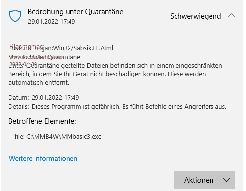

Plasmamac
Joined: 31/01/2019
Posts: 620
Posted: 06:33pm 29 Jan 2022
@matherp  -editor error is gone after virus is killed
dunno where it come from
Plasma

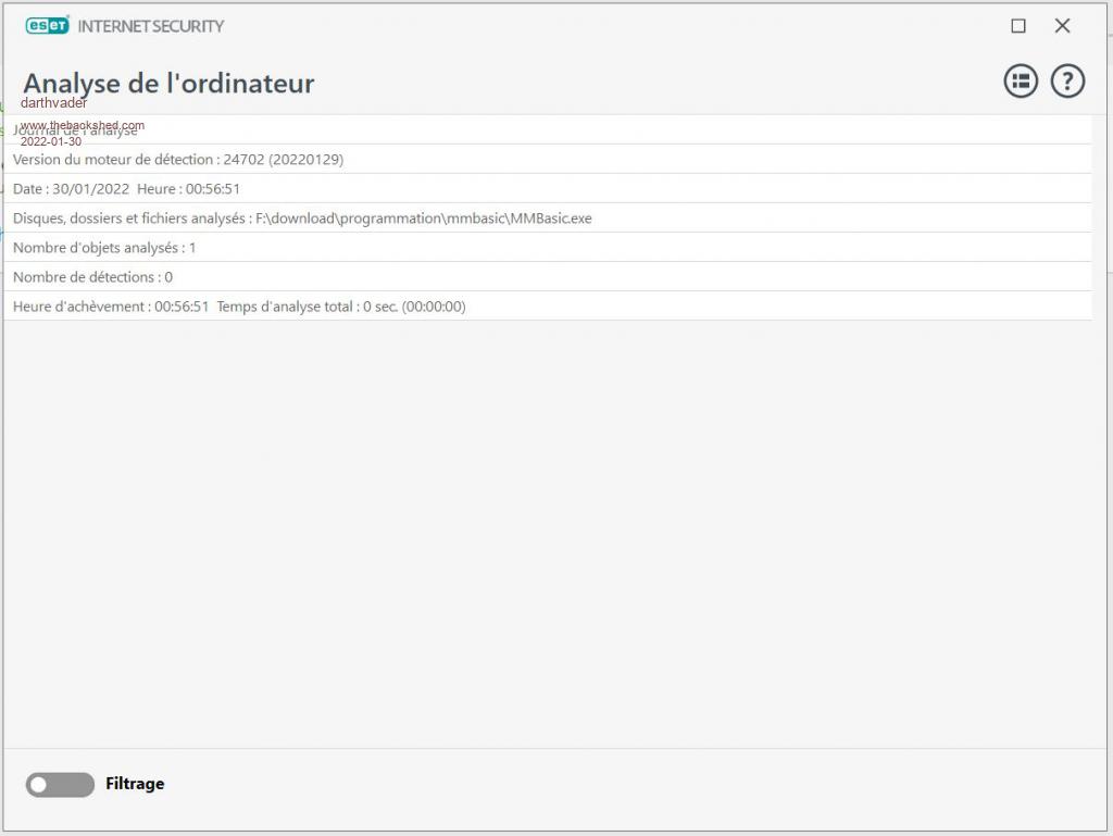

As i see some of you detect Trojan , viruses ans so far ...
Here i analyzed the executable with Eset internet security who never have let pass any of them on my system when my whole company was infected    .... here the result ...
As you see , nothing to be afraid comes out
Cheers.

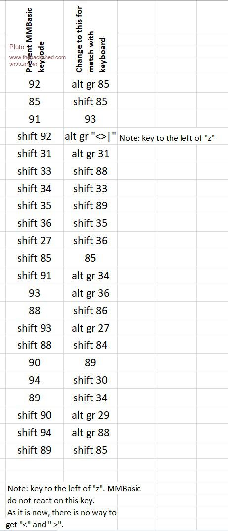

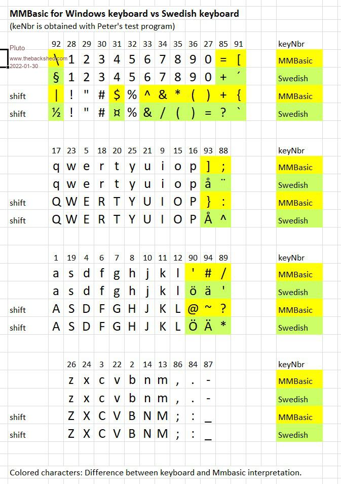

Pluto
Joined: 09/06/2017
Location: Finland
Posts: 411
Posted: 01:00pm 30 Jan 2022
Made a more precise check for Swedish keyboard:
/Fred
Posts: 11856
Posted: 04:23pm 30 Jan 2022
New version pa5
MMBasic.zip
Still no keyboard language support but most of the infrastructure is now there.
