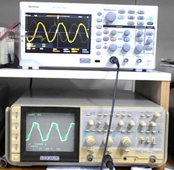

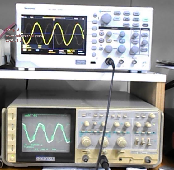

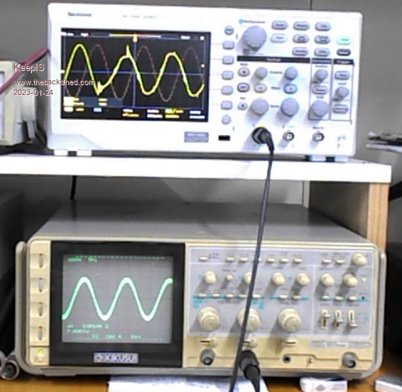

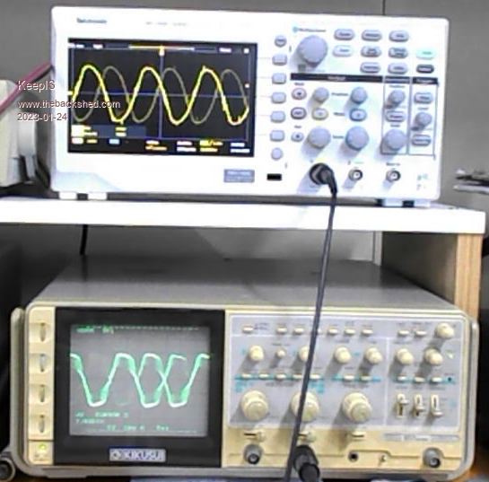

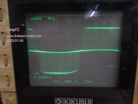

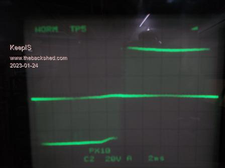

I managed to get some pictures of the inverter @ 220A 12kW startup.
I thought it would be a basket case, maybe it is?
This is a TEST setup using an Aerosharp transformer.
The 230v winding was closest to the core, I only unwound the 260v winding.
I wound 27 turns of 8 AWG 7.5mm2 wire for the primary, it's going to sag.
Output: set to 225Vac
Input: 54 volts DC
Batteries LiFePO4 : 100A all day, 300A surge 5 seconds.
53uH silicon iron Choke 8 stack toriods, 6 turns of 7.5mm2.
Current: 220A then starts to saturate very slowly.
Frame capture for the brief startup Surge
NOTE: Under 1 second total duration.
Top: Digital CRO AC waveform across the Toriod secondary terminals.
Bottom: Digital storage CRO across the Toriod Primary terminals
Instant of Induction motor start, hasn't reached the Primary yet:

Mike just for completeness do you have a picture of the CRO waveform with the heat-gun set to low (half-waving) you can post please? (with the filter now)
I am quite intrigued to compare what it did to the waveform of about 4 pictures ago labelled "800W of crap from Low Heat gun setting" compared to now with the filter that made so much difference and when the current went from 19.5A to 17.8A?

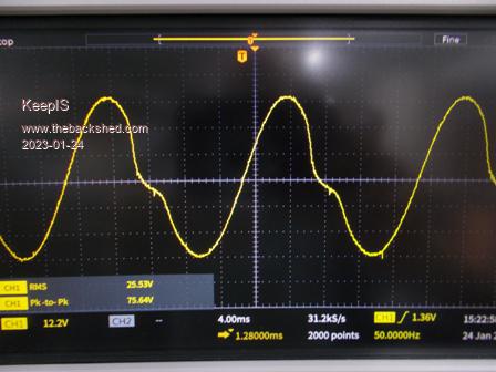

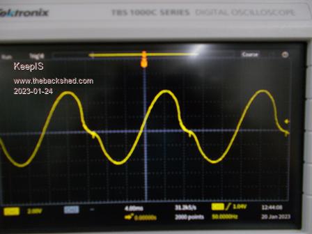

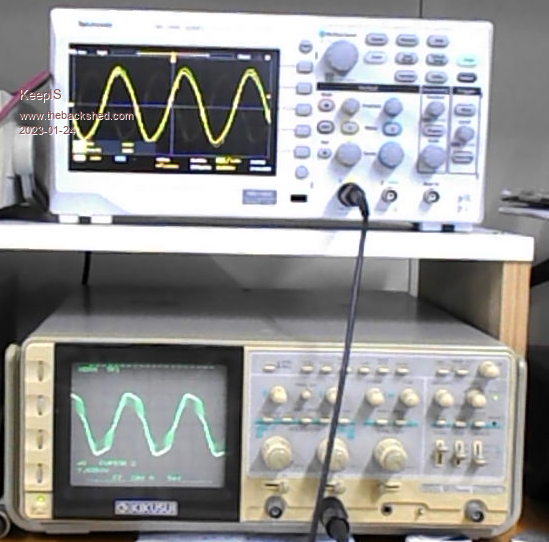

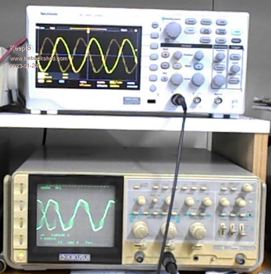

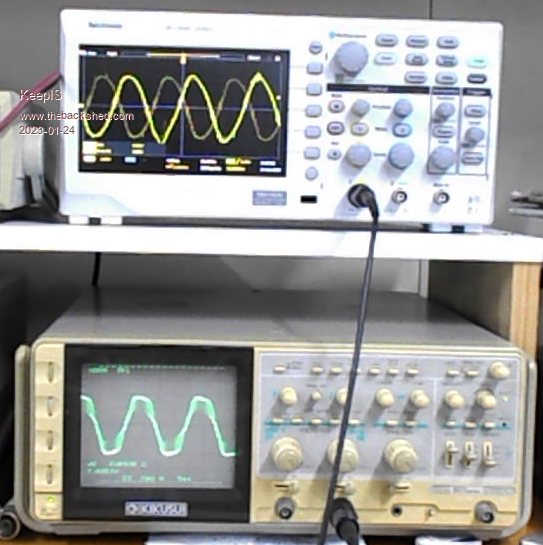

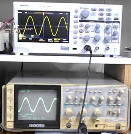

Hi Mike, actually it's down from 19.5A to 14A with the larger filter, this is the big thing that got me, I had been measuring the current a lot yesterday and today, trying different chokes, but it just proved again a bigger choke, ferite E choke etc was not as good as the 6 stack toriod, which is now around 53uH.
Hi heat current always remains the same, it's just the Low heat current that has reduced in response to the different mains filters that I've tried.
It's better to my eyes, inverter HI-LO drive more so, top is the other day.
I was rushing to take picture the other day, likely because of the nasty noise, not as nasty or as loud now.
EDIT: Had the bottom two around the wrong way.
Edited 2023-01-24 14:43 by KeepIS

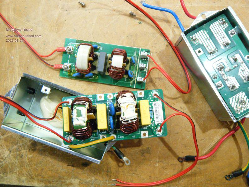

  KeepIS said  I have not been using an AC output filter in bench testing. I have two 7A mains filters from the aerosharp (I think) and an EMI filter also from the 3kW Aerosharp, looks like it's from the mains in?
Very thick wire with dual stage toriods, 0.22uF across the AC in, 2 x 0.01uf to ground between the input and output toriods, and 0.47uF across the AC out.
That's interesting, I have several of these filters and always thought they were used on the DC input side to the Aerosharp.
Anyway, I opened one up (the coils are potted to the case), here's what's inside:
At the back is the smaller version of these chokes.
The big one has 0.22uf at one side and 0.47uF the other & the middle. That side also has a 1meg resistor across it.
So, as the big one uses 2.5mm sq  wire coils its rated around 10A continuously.
I'm looking forward to see how you end up using these filters.

One thing I do after working with the 24V battery system for a year with twice the current of this 50v system is to check and recheck the clamp meter readings and position. Even going to the trouble to use shunts with a the CRO across them.
The current is measured in the negative leg of the battery and right at the battery terminal connection, clear of the toriods and close to a big low impedance sink, then I swap clamp meters. The two are very different in size and design, always check zero, one is manual adjust.
Take out the filter and it's back up to around 19A, sounds nasty, insert filter, sound a lot better and back around 14A, single stage filter 17A.
I plan on doing more tests with different mains filters to see if I get consistent variation and what works best.
The thing is, the filter makes a very noticeable difference to the sound of the toriod when driving a bad load, so something is changing for the better.
This is subjective, but the change in sound is like a smoothing of sharp current pulses in the transformer coming from the load.

Pretty much as I suspected, put an inductance in series with a sharp transient and in the simplest of terms, it's rounded.
I decided to go further and place the clamp meter in the center bridge lead of 4 series connected batteries. Same change and current in both directions under any condition using the H-Gun.
Putting a single 3.3mH choke in series with the one leg of the inverter AC out and the current drops by 1.3A, but Only with the H-Gun on LO causing a part rectified AC waveform, and the inductor gets warm as it pulls power out of the distorted sine wave.
I put the dual stage EMI filter back in and tested my 1.4kW UPS again. I mentioned it previously as it was flattening the top of the AC waveform slightly, that has been reduced "slightly" and it now looks like the AC waveform from the HF-HV inverter I previously posted, and the toriod is once again virtually silent.

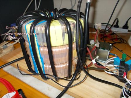

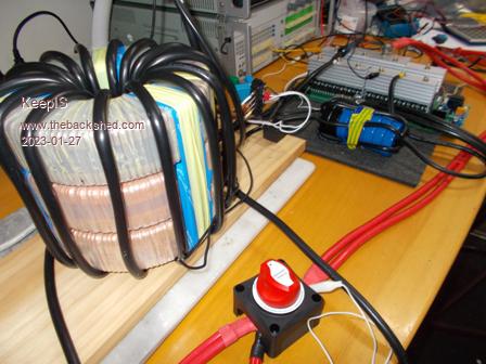

The devil made me do it.
I had 3 SMA SunnyBoy Toriods, these were 93v to 230v windings, the 93v winding was on the core. I removed the 230v windings and found that the 93v winding was wound with a single 2.6mm diameter copper wire with around 120 turns.
Thinks  3 x 93 = 279 vac, and using conservative values to keep saturation and idle current down, more likely around 260 vac winding.
So, did the unthinkable and stacked the three, bit of tape around them, and ended up with 14 turn on the primary. Primary turns were set for:
230v = 27.3v
240v = 28.4
250v = 29.8
Swapped out the Aerosharp troiod, added an extra 1uf to resonate at 3 cores at 75Hz.
Fired it up: No bang, 220vac out as before but increased it to 230v.
Sine wave great, everything cold, idle current 18 watts.
Vacuum cleaner, 124A @ 6,700 watts surge. No smoke. 230V never moved on the CRO.
Heat Gun on 1.6kW perfect, on Low DOES NOT LIKE IT, more growl then aerosharp from the 3 stack transformer's but still runs it.
BUT it pushes the AC output up from 230v to 239v? This primary is wound with 21mm2 and the Aerosharp test unit is wound with 7.5mm2, 26 turns on Aerosharp verses 14 turns on triple cores, although wire length is pretty close.
Now to play with chokes again. Good learning experience for me to see how far I can push. I will try bigger loads once more testing is done but I'm surprised that it went as well as it did. The Advantage of series meant voltage matching is not critical (within reason), obviously I have a bit more copper loss and it's not as efficient or tight etc etc but whatever.

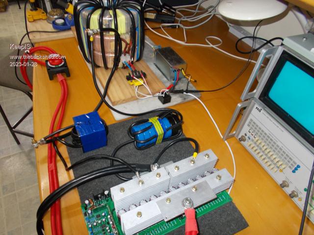

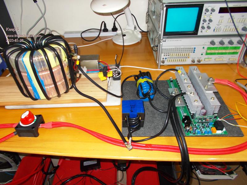

Re-terminated some of the connections I had made for the test of the 3 toriods.
I placed the 53uH 240A Silicon Iron toriod choke in the LO side to the transformer and a DOUBLE E71 Ferrite E-Core choke with 1.5mm gap and 31uH @ 160A in the HI side connection.
As I have someone here to start the band saw and the big Grinder, I was able to watch the various waveforms and hold the kill switch, Wow!
The Vacuum cleaner was first, didn't record that as it basically does nothing to the 3 stack toriod and inverter.
The Heat Gun, the problem of the AC going up on the Low power distorted waveform is gone, and surprisingly, the chokes don't get warm like they did with the Aerosharp.
I can only assume that this is because this 3 stack Transformer is not saturating.
The Grinder: 52A - 2.7kW on start for a good second. Wave forms were just nice sine waves with small ripples. Transformers barely made any noise. Chokes had a slight smooth sounding Hum that sort of matches the small ripples in the sine wave, the sine wave is measured across the primary of the transformer.
The Band Saw, Instant kick start (identical to mains 240v start) but that startup actually takes all of 2 seconds as it spins up the Heavy flywheels and 1/2" blade.
Band Saw startup - 255A @ 49V = 12.5kW
The waveforms did not show any clipping, just slanted slightly and small ripples, AC out did not budge and that was at the full 12.5kW 225A spike.
Transformer just a light hum, the chokes make more hum, but it was all very civilized and smooth sounding, just like the waveforms look
Once the Band saw and Grinder had spun up, of course everything was silent.
Idle power: 19.2 watts.
The tiny black transformer sitting between the chokes and the Toriod provides ground isolation of the CRO probe when displaying AC waveform from the Toriod.
Edited 2023-01-29 07:47 by KeepIS

This wins the prize for being the first inverter to start our 3HP dust extractor.
It's not the highest current draw at 248A and 12.4kW, but it's the hardest to start because of the long long startup time holding that current for almost 5 seconds as the huge impeller slowly spins up, the 230V AC dropped down to 210V but still maintained the same tilted sine wave with no ringing, flat top or spikes.
FYI the startup time and sound are the same when powering with mains AC.
The Air Compressor has the highest draw, 282A and 14.1kW on startup, but it's a quicker 1.5 second start. Started like on mains.
The Band saw, 250A and 12.5kW started up like on mains - no AC voltage sag.
The cable on the Silicon toriod ring Choke got warm starting the Dust extractor.
It's wound with 6mm solar cable as it's a test unit, I wanted to test an inductance of 53uH, so that was the only cable that would give me the number of turns.
The double Ferrite E-core cable only slightly warm as it's wound with heaver cable.
The Toriod transformer obviously still dead cold including the primary winding. A slight warmth to the High Side heat sink only.

Aluminum strap winding on the LH side and 240V spool winding on the Top side of the square, so the two windings form an L shape in the core.
Yes 18 Watts idle on this test inverter is so much nicer.

Just one thing that's getting missed in all the posts, my fault I guess:
The inverter board I was given was initially a 24V board, however I quickly converted that 24V board over to 48V input.
So a recap
1: This complete build / test has been with an Inverter running at a nominal 55V.
2: The scary currents are all measured between 48.6V to 56V Inverter DC input.
BTW: Currents under 285 Amps seem fine to me now after living with a 24V Transformer-less inverter nudging 500 Amps for some loads at startup
The way I feel at the moment I'll just use the 3 stack as it is. I really want to start putting together your version of the Inverter.
Thanks again for all the help and for the future help I may need with getting your inverter design up and running
