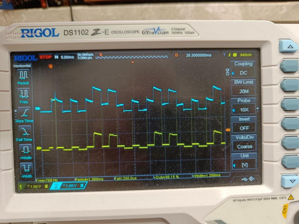

* I think all connections around the flash chip are ok, traced all out
* Clock... ok, I check, but I was thinking the RP2040 need to run to present me the Firmware update?
* Flash has power
Next I will poke a bit with the oscilloscope.
* Clock Xtal at 12MHz
C!
Edited 2023-06-10 01:17 by Calli
Calli
Joined: 20/10/2021
Posts: 74
Posted: 04:04pm 09 Jun 2023
* RP2040 gets a clock
* There is activity on the USB lines and I traced them ok
* I cant see a proper clock at the flash chip
* I can see some activity on DI of the flash when I reset.
Hmm clock and DI looks quite strange... Maybe they interfere...
(after Reset)
Need to look at a working board.

Posts: 8973
Posted: 04:18pm 09 Jun 2023
Often, when you see two different logic voltages above GND it means that a low is fighting a high and you are seeing a half-way level. It's not an analogue system AFAIK. Solder whisker on two pins?
Posts: 11662
Posted: 05:07pm 09 Jun 2023
I would guess at a short under the rp2040. You could try solderwick with flux all the way round the chip

Posted: 08:45pm 09 Jun 2023
  matherp said  I would guess at a short under the rp2040. You could try solderwick with flux all the way round the chip
Uhhh. That's all so small 🙄
I was able to look under the flash pins (bino) and thought that looks a bit suspicious. The pads of the rp2040 looked fine never thought there could be a short under the chip.
Maybe I try under the flash first an then at the rp2040. If I don't destroy the  board my colleague can fix it for me if i fail 😬

Posted: 10:36am 13 Jun 2023
So!
Board works at least to the point where the status led blinks slowly. More tests needed.
I first reflowed the contacts where the flash is bound to. I got the clock back.
However onto closer inspection today I did see that on the higher pins there was no solder on the pads (legs?) on the RP2040 chip. The pcb pads had solder but it did not flow up to the legs. So I put some solder on and drag soldered then and now it blinks.
