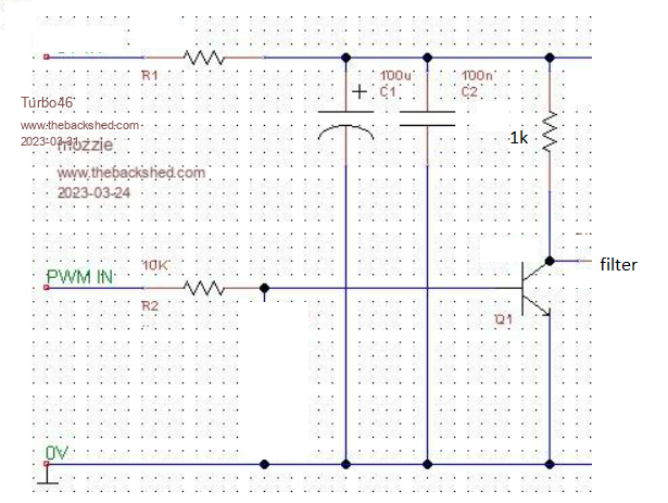

  Quote  With USB power to the Pico (4.8V at the amplifier) and the volume pot at ~6.5K the sound is quiet and has borderline acceptable noise.
With Battery power to the Pico (3.3V at the amplifier) and the volume pot at ~6.5K there is a noticeable whine of noise that pulses with the heartbeat LED.
Tom, the offending noise is coming from one of two possible sources (maybe both), the amplifier or the Pico itself. From that quote above: I would suspect the Pico.
While under battery power: Does turning down the volume control to zero eliminate the noise or at least reduce it to a level that does not bother you? If it does then the amplifier is OK, no need to mess with it.
If the noise level varies with the volume control then the noise is coming from the Pico via the filter, probably superimposed on the PWM signal because of the noisy Pico power supply.
The filter in your schematic has a corner frequency of around 3.4kHz, that is adequate for your needs. Changing the filter to one that has a wider frequency response will only increase the noise level.
Disconnect the unused PWM output that will increase the noise level.
Somebody else can help here: Because the Pico is running from a battery, should the internal (noisy) regulator be disabled? It is possibly the source of the whine.
If the noise is coming from the Pico via the filter then one way to reduce that has already been suggested. Use a switching transistor between the PWM output and the filter circuit. The supply for this switching circuit MUST be decoupled. Using the power supply for the amplifier will be OK. Any transistor 10k base resistor 1k collector resistor connected to the amplifier's decoupled supply, collector output to the filter.
Hope this helps. That last bit about the switching transistor may be all you need.
Bill

" Any transistor 10k base resistor 1k collector resistor connected to the amplifier's decoupled supply, collector output to the filter."
That is the proper way to do it, though a LED (any colour except blue or white) or string of 3 series diodes (cathode to Gnd.) across C1 to clip the top off the PWM signal might also work.
As the top of the PWM signal is at Vcc it will be carrying any noise produced by the 3V3 regulator or from the Pico itself.

  phil99 said  " though a LED (any colour except blue or white) or string of 3 series diodes (cathode to Gnd.) across C1 to clip the top off the PWM signal might also work.
Not sure that works phil99. You shoudl clip the 44kHz PWM signal. At C1 there is a residual of the 44kHz signal (first stage of low pass filter) combined with the demodulated signal. There is severe risk you also clip away part of the modulation, causing severe distortion.
As I understand how it works you should
PWM --- clip ----low pass filter ---volum control --- PAM8403 --- tiny speaker

Volhout, I understand what you say. Maybe use 220R, LED, 820R then C1. It will reduce the volume a little more but that may be OK.
The transistor approach will still give the best results providing the noise is coming from the Pico. I am becoming more convinced of that but turning the volume down to zero should prove it.
I don't want Tom to be pulled from pillar to post by suggestions of 'try this, try that' using fault finding logic is the way to go.
Bill
Edit: Volhout said "PWM --- clip ----low pass filter ---volume control --- PAM8403 --- tiny speaker". Sorry I think I said the same thing after re-reading your post.
Edited 2023-03-31 18:06 by Turbo46

  Quote  Use a switching transistor between the PWM output and the filter circuit. The supply for this switching circuit MUST be decoupled. Using the power supply for the amplifier will be OK. Any transistor 10k base resistor 1k collector resistor connected to the amplifier's decoupled supply, collector output to the filter.
I think I know what you want me to try, but could I suggest a snippet of schematic in case I don't .
As I understand it the switching transistor is the better alternative to adding an LED across C1 so I'll ignore the latter suggestion for the moment.

Hi Tom, this is the best I can come up with for now. My ability to draw a proper schematic is limited for now.
It's part of a schematic posted by mozzie. R1, C1 and C2 are the existing filter for the amplifier and don't need to be duplicated.
The transistor will be switching from a relatively quiet supply unlike the 'noisy' Pico supply so the resultant PWM should be relatively noise free.
Bill
