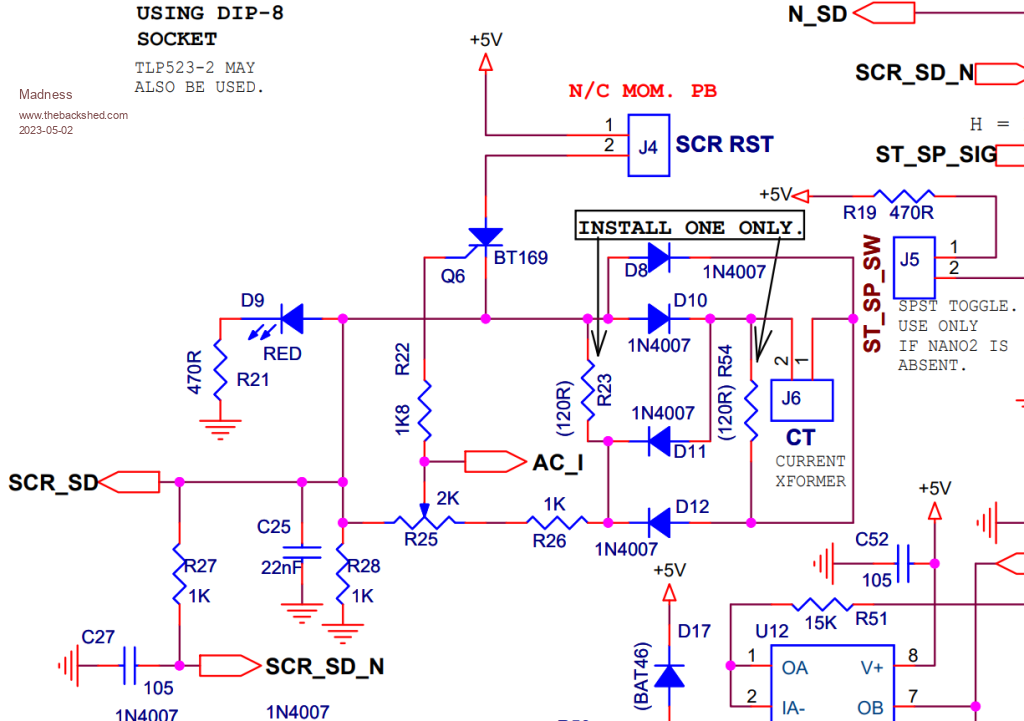

This is the first MOSFET failure I have had with the nanoverter card. Startups are normally so undramatic with the nice soft start and soft shutdowns.
After thinking about this further I remembered when I first started the inverter this morning that on the first attempt starting it and I turned on one circuit the SCR over current was tripped. I had not set the pot for this so it was probably set too low. On the EG8010 PCBs if overcurrent is tripped and reset the inverter will soft start. That did not happen it did a hard start that sounded quite brutal, it must have jolted the toroid as there was a very loud thump, I wonder how many thousand amps passed through the MOSFETs in those initial milliseconds. I was not expecting this behaviour, it all happened in a few milliseconds and the inverter was running. I had a switch on the SCR circuit as I did not have a suitable normally closed momentary push button switch. However, the correct switch would have still resulted in a hard start. So as the inverter was running I thought everything was fine but was it, chances are very high there was damage as a result of this causing the failure a few minutes later.
The power board is beyond repair, all 24 MOSFETs are blown and several of the totem pole transistors are burnt as well as quite a few resistors, PCB tracks and the PCB is burnt right through in one spot. I have not tested the nanoverter PCB yet but I doubt the MOSFET drivers survived going on past experience when a failure goes past the totem pole transistors.
I know some don't see value in having the SCR overcurrent shut down, is the software-driven shut down as fast? The scr shutdown has saved me before with an oven that blew an element a few times. The first time was before I had the SCR shut down and it killed the inverter, the same fault in the oven occurred twice after that when I had SCR shut down. They shut down tripped and no damage was done. We have since replaced that oven due to these problems.
Anyway, I will use a new power board with just 4 MOSFETs and test the inverter with the chokes and everything else as it was when the failure occurred. I think that there is a very high probability that the hard start was the issue. In the meantime, I will leave the SCR shutdown disabled until I can sort out the hard start issue.

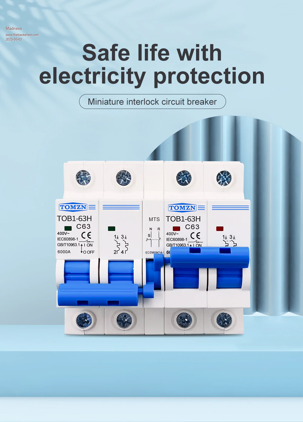

I fitted a larger DC Breaker, if I had stuck with what I have in my other inverter the MOSFETs would blow and the damage would stop there.
These Transfer Switches are cheap and prevent connecting two power sources. I have been using the same brand for at least 6 years.

The SCR shutdown is part of the Nanverter control PCB, there is a 2000 turn current transformer on the AC output of the inverter. This circuit is connected to the Shut Down pins of the MOSFET driver ICs. If the AC current rises too far the SCR turns on the shutdown and the ICs turn off the MOSFETs instantly. It was the resetting of this and not expecting that the MOSFET drive signals to the driver ICs was still present that caused the hard restart, an not do a soft gradual startup as I was expecting.

Thanks for that switch link above, Gary. I did not know such a switch exists.
I have a 3 position rotary switch; Inverter - OFF - Grid. This works IF  I remember to check it before connecting something.
I like your switch though, have put it on my list of modifications .
Regarding Nano inverter shut down, I never quite understood the SCR method Poida uses.
Instead I'm using the old method Oztules came up with, modified so that overload & undervoltage turn off the nano's ON switch.
This works for me.

Those transfer switches disconnect line and neutral, plus they are a breaker as well.
The Oztules SCR shutdown pulled the current feedback pin high on the EG8010, which shut down the SPWM as well as directly shutting down the driver IC's. So the when reset the EG8010 did a normal startup with soft start.
If you are running a standard Nanoverter PCB then Nano1's D6 pin is connected to the SCR shutdown circuit and the code you are using checks that pin every half cycle and stops if it is high. So there is no need to have it connected to the on/off switch, under voltage is in the code as well. That SCR part of the code is not in the early version that Poida wrote with the 2XSINE. Obviously, that is something that was added sometime later. I need to look more at the code, I was too busy just working on getting the back feeding working.
