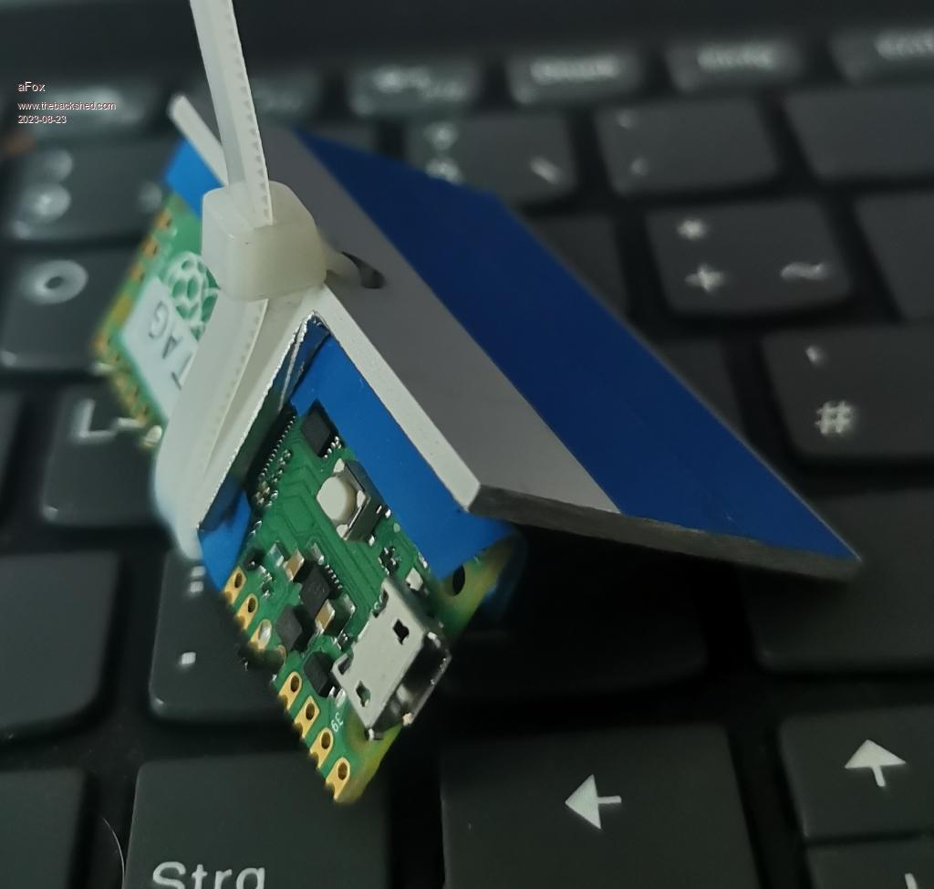

The use of a heat sink, here a double offset angle profile 30 x 20 x 2 mm made of aluminium, can increase the accuracy of measuring the ambient temperature. The outgoing heat flow from the processor only has a minor influence in relation to the heat sink surface.
