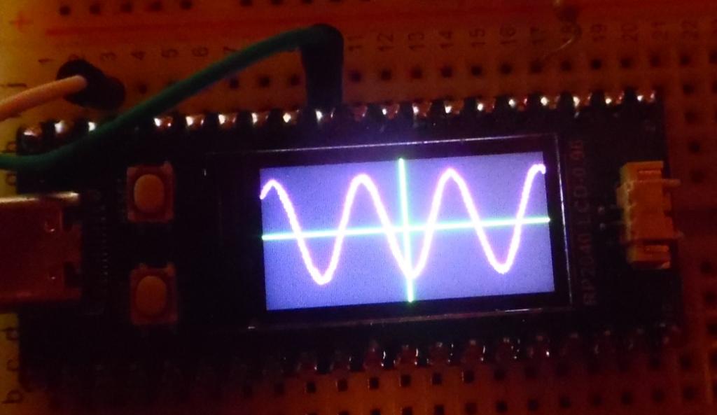

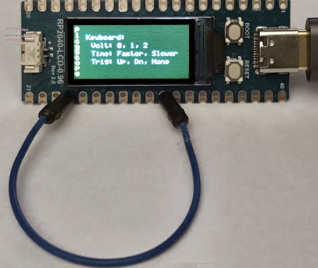

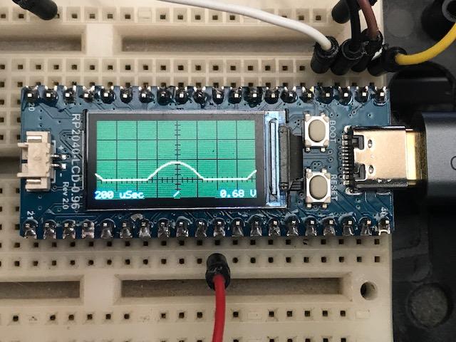

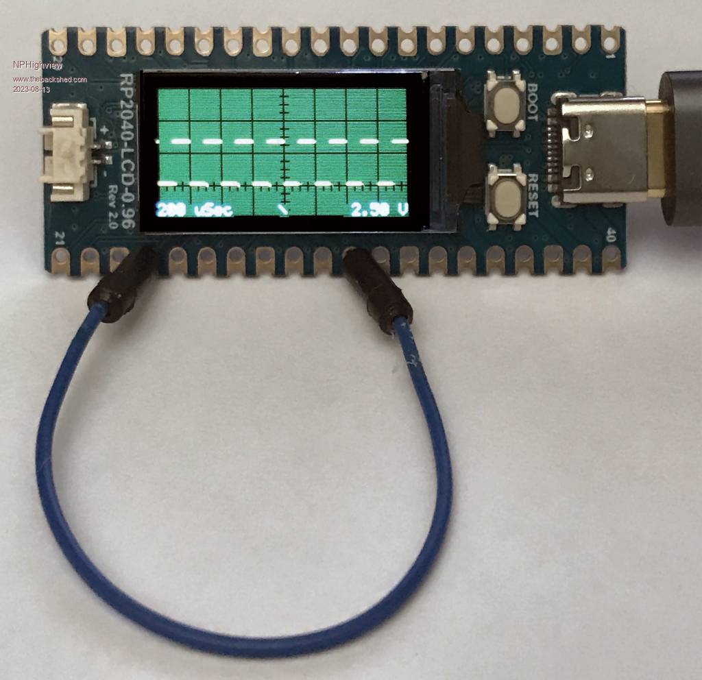

OK - now we're getting somewhere.  The listing below is for a fairly general purpose single-channel oscilloscope on the Waveshare RP2040-LCD-0.96. Three voltage ranges, six timing ranges, and three triggering modes are selectable via either terminal emulator or debounced front-panel switches. The code displays a "lost trigger" message if none has been detected in 2.5 seconds, and recovers when the trigger is restored or the trigger condition is changed.
Now, on to design for a carrier board with probe lead jacks, and a 3D printed enclosure!

Sub Display_Instructions
 FRAMEBUFFER WRITE L
 CLS Background
 Text   6,  Vres/2, "PicoScope", CMV, 7, 1, Signal, Background
 Text   18, 15,     "Keyboard:", LT, 7, 1, TxtColor, Background
 Text   25, 27,     "Volt: 0, 1, 2", LT, 7, 1, TxtColor, Background
 Text   25, 39,     "Time: Faster, Slower", LT, 7, 1, TxtColor, Background
 Text   25, 51,     "Trig: Up, Dn, None", LT, 7, 1, TxtColor, Background
 FRAMEBUFFER COPY L, F
 FRAMEBUFFER COPY F,N
 Pause 4000
 Text   20, 71,     "Waiting for Trigger.....", LT, 7, 1, Signal, Background
End Sub

Sub Draw_Graticules
 Local STRING T$, V$, A$
 FRAMEBUFFER WRITE L
 CLS Background
 Line HMinorx1(), HMinory1(), HMinorx1(), HMinory2(), 1, GMinor ' Draw minor horiz graticules
 Line VMinorx1(), VMinory1(), VMinorx2(), VMinory1(), 1, GMinor ' Draw minor vert  graticules
 Line HMajorx1(), HMajory1(), HMajorx1(), HMajory2(), 1, GMajor ' Draw major horiz graticules
 Line VMajorx1(), VMajory1(), VMajorx2(), VMajory1(), 1, GMajor ' Draw major vert  graticules
 A$ = Str$(H.Seconds(ADC_Select),3,0) + " " + H.Units(ADC_Select)
 Text    0, Vres, A$, LB, 7, 1, TxtColor, Background     ' Draw Time Scale at Lower Left
 V$ = Str$(V.MajVolts(Vselect), 2, 2)+" V"
 Text Hres, Vres, V$, RB, 7, 1, TxtColor, Background     ' Draw Volts Scale at Lower Right
 Select Case Trig_Type
   Case Trig_Up:   T$ = "/"
   Case Trig_Down: T$ = "\"
   Case Trig_None: T$ = "-"
   Case Else :     T$ = " "
 End Select
 Text Hres/2, Vres, T$, CB, 7, 1, TxtColor, Background    ' Draw Trigger at Lower Middle
End Sub
Sub Randomize_Test_Signal
 PWM 1, PWM_Freq, 45+10*Rnd  ' Randomize duty cycle to ensure displayed signal is refreshing
End Sub
Sub Get_Samples               ' Load ADC inputs into sample() array
 sample(2*Hres-1) = -1       ' Samples will never be < 0
 ADC start sample() : Do While sample(2*Hres-1) < 0 : Loop
End Sub

ps wonder why your photos don't show vertical trace. Is it the camera?
Edited 2023-08-13 23:18 by stanleyella
Posts: 8973
Posted: 04:29pm 13 Aug 2023
Speed up the scan or zoom in and you might be able to see the rising and falling edges of a square wave. If the square wave is being generated by a Pico then those edges are very fast and may be difficult to see.
It's also possible that if the square wave is being generated by the same Pico that is capturing the waveform then you may not be able to capture the edges anyway. Depends on the relative frequencies of the wave and the capture.
Posts: 4355
Posted: 06:44pm 13 Aug 2023
I don't have the board but that looks impressive!
Posts: 5998
Posted: 06:55pm 13 Aug 2023
Vertical lines are not visible if you are painting pixels. To see vertical lines you need to draw lines.
With sine wave input you would clearly see the pixels. But with square wave you dont, as long as there are enough samples.

As you play with this, please note that the jitter is deliberate in the test signal emitted by the PWM on pin 24. I wanted to be sure that the trigger and screen updates were taking place correctly. You can eliminate the jitter by commenting out the call to  Randomize_Test_Signal in the main loop.
Thanks for everyone's positive comments. This has definitely been a learning experience for me, too.
Posts: 2807
Posted: 09:13pm 13 Aug 2023
  Volhout said  Vertical lines are not visible if you are painting pixels. To see vertical lines you need to draw lines.
NPH and me both use join the dots vectors but my photos show vertical trace and NPH's  doesn't. Just wondering why. If I switch my camera to manual it shows the vertical trace changing on x axis.
NPHighview
Joined: 02/09/2020
Posts: 222
Posted: 09:24pm 13 Aug 2023
I'm not using "join the dots" vectors, just the PIXEL command using arrays. I guess I'm just a pixel sort of fellow (actually, thought about using LINE command using arrays, but then would have to do extra copying).

My bad. what's a sine look like?
10KHz
NPHighview
Joined: 02/09/2020
Posts: 222
Posted: 12:25am 14 Aug 2023
I found a 1KHz sine wave MP3, so here's the waveform played through a 17-year-old iPod. I don't have an external amplifier with adjustable offset, so the ADC only provides values of 0 and greater, clipping the negative voltages.
I did have to add a slower timescale, and another vertical scale to get this, but pixels look OK to me.
Time to break out the Op Amp Cookbook, or refresh my familiarity with GoldWave.
