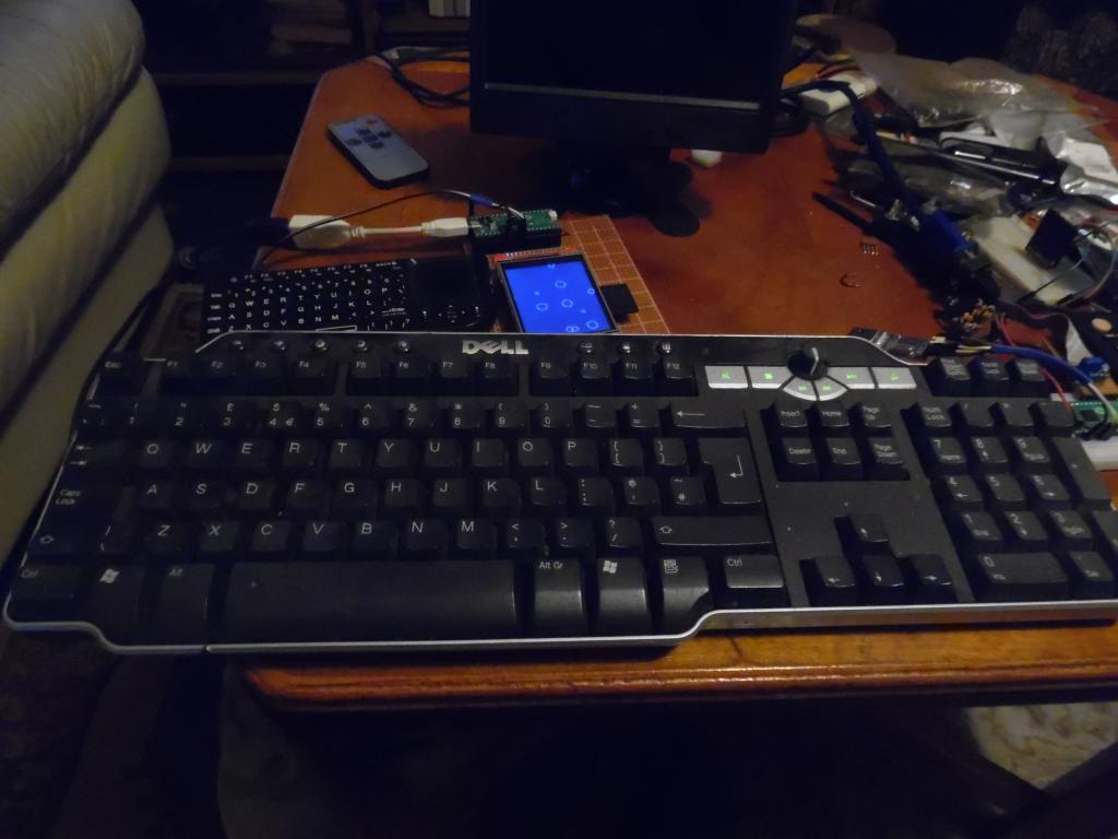

Posts: 2807
Posted: 10:33pm 18 Feb 2024
I tried this usb kb with 2 usb ports on the back, works ok with picomite usb.
