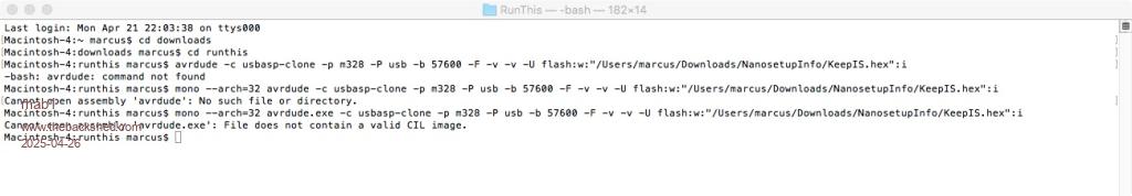

Actually we are going around in circles here:
1: The USbasp programmer does not have anything to do with the Nano USB port and driver, does need it in any way.
2: The programmer bypasses the USB port and talks directly to the Nano processor via the 6 pin ICSP header.
3: If ArvDudess can not expose the USB option in the Port[-P] drop down box, it means that AvrDudess is not communicating with the underlying iMac OS USB devices.
The IDE appears to be seeing the Programmer and is getting an ID back, that is the typical warning about device type though, so it looks like the USbasp driver is working.
I sent you a PM.
EDIT:
If you can run the following command it should tell us a few things:
I assume I have the path to your hex program file correct see the download at the bottom.
avrdude -c usbasp-clone -p m328 -P usb -b 57600 -F -v -v -U flash:w:"/Users/marcus/Downloads/NanosetupInfo/KeepIS.hex":i
NOTE: You do not need the Programmer connected to anything, No need for a Nano, just plug the programmer into the iMac USB port.
If you can run the command, it will allow avrdude to go through the programming and verification sequence and confirm if the Programmer and driver are working, the driver you have installed is the correct driver, it has the same driver signature as my Windows driver.
To make this easier download the following Zip, place the three files in a Directory, then try and run the command - I don't know how you do that on iMac, the command line is included in the text file in the download.
The download contains a later version of avrdude and required avrdude config file, the command will not work with the older versions installed with the IDE.
RunThis

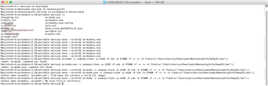

OK, I followed your 1st instruction first from the open Terminal window - i hope that is what you intended,rather than running it from within avrdudess? (various attempts to make it work):-
then using the files in your zip:-
doesn't seem to run, although i thought it did run from within avrdudess.
Edit:
I'm just wondering: because i have to run avrdudess within 'mono' .net framework thingy, is the problem actually that mono doesn't allow access to usb ports? not that that gets me any closer
Edited 2025-04-26 07:41 by mab1
mab1
Joined: 10/02/2015
Posts: 287
Posted: 10:50pm 25 Apr 2025
OK, had a though about what you were saying that averdude must run on the mac (without mono) for the IDE to function, so looked for the command line in the previously posted IDE attempt to use the USBasp:-
/Users/marcus/Downloads/Arduino.app/Contents/Java/hardware/tools/avr/bin/avrdude -C/Users/marcus/Downloads/Arduino.app/Contents/Java/hardware/tools/avr/etc/avrdude.conf -v -p atmega328p -c usbasp -P usb -U flash:w:/var/folders/2s/n4lnvcqs55g0zlsbjg2tlsl80000gp/T/arduino_build_174515/Blink.ino.hex:i
so what happens if i graft in the path to the .hex file we want:-
/Users/marcus/Downloads/Arduino.app/Contents/Java/hardware/tools/avr/bin/avrdude -C/Users/marcus/Downloads/Arduino.app/Contents/Java/hardware/tools/avr/etc/avrdude.conf -v -p atmega328p -c usbasp -P usb -U flash:w:/Users/marcus/Downloads/NanosetupInfo/KeepIS.hex:i
paste that into Terminal and:-

Just got to the computer, the terminology is throwing me slightly.
The text I sent is a command line argument that is passed to avrdude to process and run.
For this to happen, and this is where I have no idea what the iMac OS limitation is in this case, I will tell you what is meant to happen.
In Windows, you would place the 3 files I zipped into a directory, you would then open a command line window, and copy the command from RunThis.txt into the command window and press enter.
avrdude.exe (which is inside the directory) will run, I don't have to tell the OS where avrdude.exe is located, it assumes that it's in the current directory, avrdude will run and will look first in the current director that it launched from for the config file and process the entered command line argument.
Also in windows, you could rename the file "RunThis.txt" to RunThis.bat and simply run it, the .BAT extension (batch file), automatically passes the command to the command interpreter.
Without knowing how your OS processes a command or the structure of the command or the registration of programs to the OS makes it difficult.
What I was trying to do was to remove the GUI interface program called AveDudess from the process, as it having trouble finding the programmer - IE it's not working correctly, but we have already proved that the command line program avrdude.exe can work.

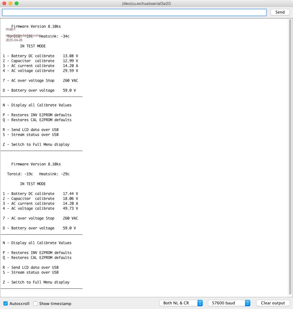

Thanks - Is that better?
Edit: - oh! i've already reprogrammed with -F
OK... where's the usb lead?...
Edited 2025-04-26 09:18 by mab1
mab1
Joined: 10/02/2015
Posts: 287
Posted: 11:29pm 25 Apr 2025

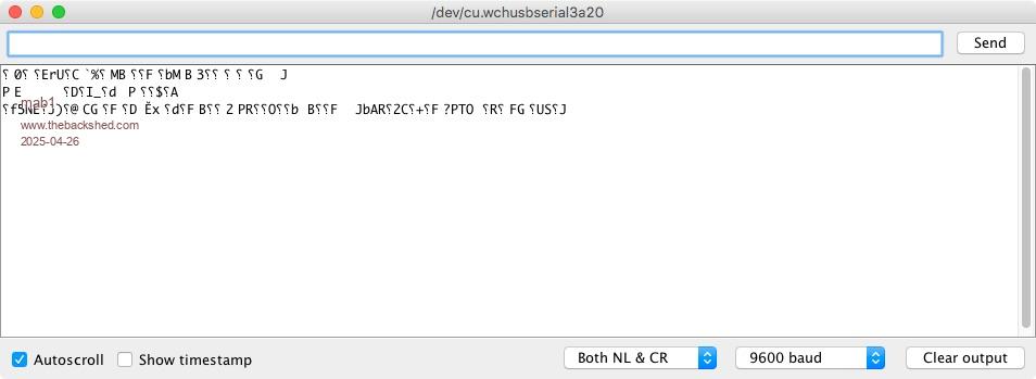

Umm...is it ? to get the menu?
I get this as a response:
Edit:
Wrong baud rate!
edit:
actually,  feels a bit tame - i feel more like:
Edited 2025-04-26 09:36 by mab1

So glad to see it going, Ideally, we should get the fuses set and the boot loader removed.
However you should be able to test the boards and it will run. Just have a look at the help file for how to use the Menu.
Basically, you don't press Enter at all, enter key is only used to accept a voltage or current value typed in if the Menu asks you to do that.
You also need Local Echo on in the terminal application to see the keys you press, the Nano Menu does not ECHO back your key strokes to the Terminal program.
IE without having local Echo on, you wont see anything you enter - it will look like the Nano is not responding to you

I might have another play with the winxp machine: avrdudess would run but not avrdude (but the arduino ide works on that OS too IIRC).

With XP it will be the driver for the programmer, I will look to see if there is a version for XP, I'm sure I saw one a while back, from memory the IDE uses two different applications to program, so it would work for USB programming but likely fail when directed to us a Programmer.
BTW the Menu display you posted was in Simple Menu mode, pressing Z will reveal the full menu.

Thanks very much! I fear you're doing a lot of work to help me with my obsolete computers.
As I had the working nano, I was doing electronics testing with it on my inverter boards yesterday (found a fault on the powerboard - highside out A not turning on - investigating).
Today I've got XP running and seeing if I can get avrdude.exe to actually run on it (I do have a version of the ide installed, but it falls over when you actually try and compile/verify, let alone program, so I'm following your links, and looking for old versions of the ide...
But I will try your command lines on the mac too when it's on: just curious - will they remove the bootloader if it's already loaded?  do they remove the protection for the bootloaded if it's there?

Still working on avrdudess on winXP   : getting closer i think, but not there yet...
