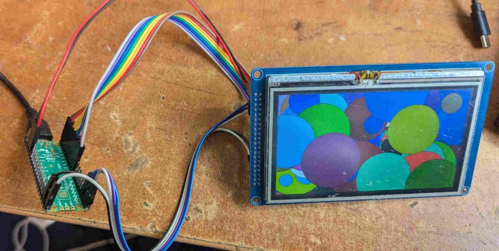

I am using the standard 2350 firmware RC4 (ie nonHDMI/nonUSB) on a RPI Pico2.
Connecting a 5” SSD1963 as per Pico manual (DB0-DB7 to GP0-GP7, etc).
Known working display as it works on 44pin MM (configured for 5V operation, with SSD backlight control, on 8080 interface).
I can successfully control the backlight intensity with the BACKLIGHT xx command which confirms all signals and DB lines are correctly connected.
BUT the display remains ‘black’ and it is not possible to see anything on the display (apart from the backlight ‘bleed’). Trying GUI TEST LCDPANEL as well as CLS RGB(colour_name)
I have tried OPTION LCDPANEL SSD1963_5,L and also _5A (and 7 and 7A just in case this made a difference!) but no matter what I try the display remains ‘blank’.
Is anyone able to test RC4 with an SSD display to confirm if they’re able to see something on the display.
I will try a 7” and 9” sometime in the coming days, but really want the 5” to work for a specific project.
Any confirmation (or suggestions) would be greatly appreciated….
Posts: 11830
Posted: 06:29pm 04 Oct 2024
Can't test the RP2350 but RP2040 RC4 definitely works on SSD1963. Suggest you get that working first and then substitute.
How are you powering the display 5" is the hardest to power and you may be overloading the 3.3V rail
Edited 2024-10-05 04:32 by matherp
Posts: 2991
Posted: 07:21pm 04 Oct 2024
  matherp said  Can't test the RP2350 but RP2040 RC4 definitely works on SSD1963. Suggest you get that working first and then substitute.
Good call to drop in a 2040 as you have been able to confirm that it works.
Powering as a 5V unit from a 3A RPi PSU (common GND with USB to laptop running TeraTerm).
3.3v power rail on SSD reads 3.28v so happy with that.
Let me try your suggestion of a 2040 with RC4 tomorrow…..
Posts: 2991
Posted: 10:09am 05 Oct 2024
Still no joy here with either a 2050 or 2350 connected to known working SSD displays using RC4 (but note I have not tried an SSD on any previous versions of firmware)..
Is the following connection guide 100% correct?
Posts: 11830
Posted: 10:23am 05 Oct 2024
Tested on RP2350 PicoMiteV6.00.00RC4 firmware wiring as in manual
OPTION RESET
OPTION LCDPANEL SSD1963_4,l
