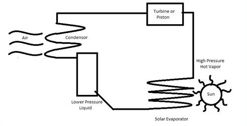

  tim c cook said   Lubrication is one of the reasons I am using refrigeration fluid rather than water, Oils are intended to dissolve in the organic frig fluid and be carried through the system with no nead to be seperated, that, and the fact that it can be vaporized at temps far lower than water, this allows solar heat collection using more simple flat plate collectors. By reworking the top end of a 2 clinder automotive York frig compressor you have a 2 cylinder 10-12 cubic inch single ended engine that is designed for the frig fluid, these have sealed crankcases that contain liquid lube oil for the bottom end and are also sealed against the loss of any frig fluid to the outside world.
I would be really careful. Heated Liquid refrigerant can easily reach 1000+psi if not controlled precisely. And unless you use a high enough pressure you will have to cool the vapor well below ambient to liquefy it again. On a 100*F day you would have to have a pressure greater than 200 psig for R-22. Then after you heat it the pressure will skyrocket. And for R-134a for a 100*F you would only need around 125psig. Unless of course you water cooled down below 60*F. That would lower R-22 down to around 100psig and R-134a down to 60psig for the liquid side. And never allow liquid refrigerant to enter a pump it will destroy it faster than anything. The only type of compressor that can handle a LITTLE bit of liquid refrigerant is a scroll compressor. Piston ones will be destroyed from the tremendous hydraulic pressures when operating as a compressor.
Is this kinda what your were thinking about? Just a crude drawing I drew up.
Only thing would be figuring out how to keep the high pressures evaporator vapor from going back into Liquid reservoir while keeping a flow of liquid to the evaporator. You'd have to have feed pump. In my opinion a low pressure water steam system would be so much easier and safer.
On a side note if you guys used superheated steam you wouldn't have to worry about lubrication problems. Dry steam works great with oil.

Seems to me, if my memory serves me well, R-12 at least, turns into some kind of poison gas called "phosgene" or something like that, so if you're using a concentrating collector with refrigerant, be careful. Also, seems to me the figure of 1620*F was where it happened; maybe not, I dunno.
Of course, it's been 40+ years since I went to AC&R school in the military. AC&R stands for "air conditioning and refrigeration"; I remember that much for sure!
If your interest in all this is merely hobby, I'd use steam and just let the oil-water emulsified mess drip on the garage floor. If on the other hand, you're on a first-name basis the folks over at the Guiness Book of World Records, well, that's a horse of a different color!
. . . . . Mac

Here's the thing alot of them when exposed to too much heat will decompose into acids, and toxic gases similar to mustard gas. That's why when a compressor burn out happens it's recommend to do a flush. And the acids will eat away the pipes. So you really need to regulate the temperature below 125*F.
Best would be to set up a water solar collector and pump it into a storage tank keep the temp below boiling and then mix with cold water to get the temperature you want. R-22 tanks warn against heating above 125*F because all the liquid could flash and cause a tank explosion.
"Off Topic"
Beside unless you have a license all you gonna be able to buy is R-134a or use propane, or butane maybe a couple others. Some say high refined propane is better than R-22 but manufactures won't use it because of the liability of gas leaking and causing a fire. It uses lower pressures and some claim higher energy savings compared to R-22. It's actually sold as a drop in replacement for R-22 too.

I actually do have a universal frig tech liscence but the intent is to use propane, cheap, and I happen to have a 1000 gallon tank of it on hand. The propane tank pressure rarely causes the 425 pound pop-off safty valve to trip even when in full sun but even poor solar exposure will create over 200 pounds pressure. The propane will also condense back to liquid at around 100 pounds pressure if cooled below 100 deg f, I converted an old window air conditioner to use for sucking propane vapor from smaller tanks, condensing it back to liquuid, and pushing the liquid back into the big tank. on a hot 90 deg day I have to spray a bit of water on the condensors to keep the condensing pressure down below around 150 pounds so I need to use more condensor area than is available from the two smallish radiators found in the small 5000 BTU window air conditioner that I am using for this.
I have been running temp tests on a cheap-n-dirty swamp cooler to possibly use to create cooler air, so far the swamp cooler shows it can convert 102 deg f air temps into about 78 deg f air if the relative humidity is under 10%, it evaporates about 2 gallon/hr of water in the process (testing this in Arizona).
The idea is to collect and store the solar heat in used deepfry vegitable oil so it can supply heat to the system 24 hrs/day, I have lots of used veg on hand also as I run my diesel pickup with it as well as heat my shop with it. Collect heat as long as the collectors are hotter than the insulated storage tank, use a veriable speed DC pump to move the hot oil through a small boiler tank to vaporize the propane in several feet of coiled frig-rated copper tubing inside the small boiler tank. The amount of heat storage fluid pumped through the boiler will control the pressure/volume of the propane vapor being supplied to the expander engine based on engine rpm which is based on generator load. A DC automotive generator will be used to charge batteries for electrical storage. I have a couple salvaged 24 volt 1100 amp-hr forklift batteries to use for the battery bank and a few old 24 VDC 1 and 2KW inverters to create 110 VAC. The solenoid operated hydraulic reversing valve used as the steam valve for the york engine dictates that the engine receive pressurized vapor for the full down stroke of the piston due to the other half of the valve exhausting steam for the full up stroke of the other piston, this is not the most efficient approach but produces high torque at some lower rpm. The york compressors also have a water jacket space around the outside of there cylenders so passing more heated storage fluid through that might cause some extra vapor expansion inside the cylinders to help with efficiency, still have to try it?). I have several 18-24 inch pulleys to put on the engine to spin the 2.5 to 3.5 inch pully on the 100 amp chrysler auto alternator(s) and/or 1 to 1.5 KW 90 volt permanent magnet treadmill motor(s) (I also have an old 2KW 90 VDC-to-110 VAC resonant inverter)). The older 100 amp alternator (70's and 80's chrysler products vehicles) has a larger diameter than modern ones and can produce the full 100 amp output at around 2000 rpm so the engine only needs to run at 300-400 RPM, if the setup has more available power I have more alternators.

Well it's good to hear you have a license messing with frig systems. And it sounds like you have a handle on things so I'd be glad to see how it all turns out keep us updated. Hopefully you'll get more out then you have to put in to run it. I bet it's gonna be one heck of a balancing act getting it running and running good.Edited by GreenD88 2010-06-14
