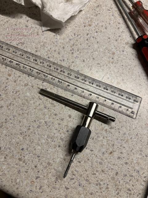

OK, I've recovered from the transcendent meditative bliss of drilling and thread tapping, went pretty well really, only broke one drill bit early in the piece.
My drill press won't hold a 2.5 mm bit so I tried drilling with the cordless drill. Murphy's friend is right, a drill press is necessary for this, got a drill bit with a hex bit on the end (meant for an impact driver) and used that in the drill press and no further problems. Slow and steady wins the race here.
Tapping just needs patience and a bit of light oil. A small tap holder so you can feel what's going on helps. I used a tapered tap, 1 1/2 turns in then 1 turn back and take it all the way out and clean it as soon as you feel it tighten up.
The way my heatsinks were originally drilled meant there was no way of having all the fets clear of the existing holes. To fix this I put some thermal paste on a screw, tightened it firmly into the hole and cut it off with a dremel. Ground it down just below the level of the heatsink and filled the gap with some thermal paste before sticking on the insulating thermal mat.

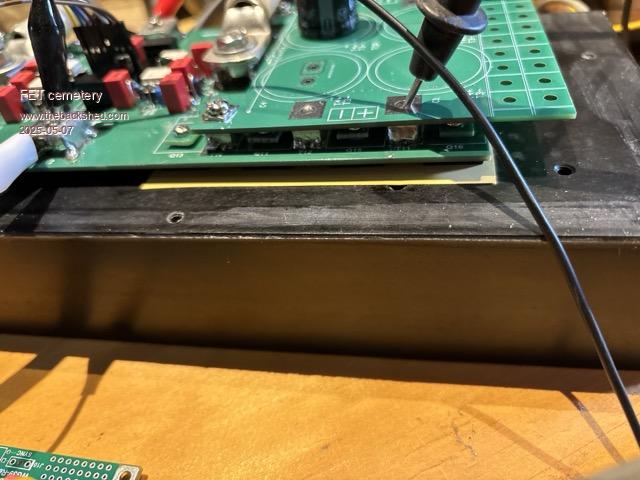

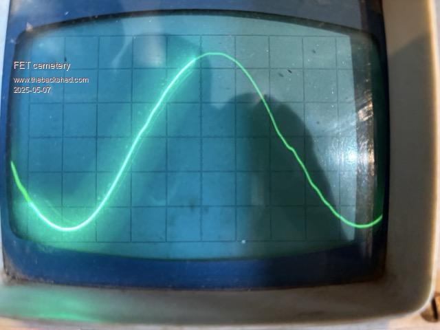

Started testing today using the big transformer and something is clearly not right.
I don't have a proper current limited power supply so I've been using 18V cordless drill batteries with an automotive tail light globe in series as a current limiter.
At 18V unloaded all seems well, a good enough sine wave on the scope and about 600mA idle current.
At 36V the transformer has a noticeable hum and the sine wave is starting to look a bit gnarly.
At 54V the pwm is down to about 70% but the hum is still there and the sine wave is not great:
This was all with 2x 470uF capacitors on the power board, the 2 chokes with 4 turns through 8 sendust rings each and 4.7uF across the transformer output.
Thinking this could be due to the temporary wiring to the boards and the ancient 470uF caps, I put a 5600uF cap on the power board. Got about 2 seconds in to the slow start at 18V and pulled the power, horrible noise from the transformer and the waveform (out of the corner of my eye, not really looking at it) was all over the place.
Any ideas? I haven't checked anything yet except to confirm the same behaviour with both my nano boards (didn't try the 5600uF on the second one!). Probably won't get a chance till the weekend.
Idle power at 54V was 35W. Nothing was running even remotely warm, no magic smoke.

I'm thinking it has to be one of the bias supplies or something downstream of them. Wondering if I didn't cook one of the low side Zeners when I soldered them in.
Fets all check out ok with the meter, drain - source resistance 1M9 and a bit.

The drive to the primary needs to have perfect symmetry. Any difference between the half cycles produces a DC component**. Your primary circuit DC resistance may be just a few milliohms so even a small DC voltage can produce a large DC current pushing one half-cycle toward saturation, which increases the current on that half cycle even higher. This positive feedback can result in full saturation.
Magnetic amplifiers and saturable reactors work on this principle.
A DC ammeter in series with the primary will show if this is the problem.

  FET cemetery said  Started testing today using the big transformer and something is clearly not right.
Idle power appears quite high. What was the secondary voltage at the 54V & 35W input?
I do understand your series light globe, but probably a better method is to use a fuse holder and 2A, 5A, 10A, 20A fuses as appropriate as testing progresses.  Keep in mind that the 4 x FETs combined have around 1,000A capability, yes I know the DC caps can supply large momentary destructive high currents.
What is the idling current at 54V and no choke/transformer connected?  I need some ball park figures to try to get a better handle on whats happening.

Secondary voltage at 54V & 35W was 240V. Will get back to you on no choke / transformer current. Thanks.

"Idle power appears quite high." Yep, the transformer was humming loudly enough to be annoying in a quiet-ish room. I'd imagine 40+ kg of transformer is a pretty inefficient loudspeaker, could easily see 5 or 10W being dissipated there. Could feel it vibrating when I touched it.
Just so we're all on the same page the power board is WG30-Rev2 and the nano board is WG39-Rev7.
With nothing connected to the output it draws .128A at 53.3V, a touch under 7W.
R4 has -2.7V across it measured from B-, D5 has +12.2V.
The high side supplies are ok too, 12.43V across pin 5 and pin 8 of OC1, 12.50V for OC2.
C10 is listed as Tantalum or Al on the circuit diagram but not the BOM I was using, I've missed that and used a 10uF electrolytic. Could this be causing problems?
The 5600uF capacitor was tried at 36V not the 18V I originally said. At the higher voltages I was using an automotive headlight globe to limit current. With 2 x 470uF the globe was cold, adding the 5600uF (and not changing anything else) sent the current way up, the globe was properly glowing when I cut the power. I would estimate a good 3 or 4 Amps plus.
The nano board was in test mode with only AC voltage feedback connected.
Just because changing nano boards makes no difference doesn't mean they're off the hook, they were both assembled together and it's not beyond me to make a stupid systematic error.
Lastly, I know I haven't followed Wiseguy's test procedure to the letter but starting with low voltages and small capacitors has no doubt saved me from living up to my username again!

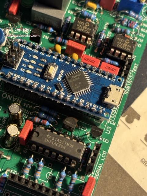

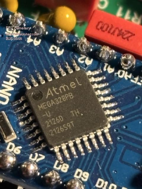

Could it be dodgy nanos? The Atmel logo looks a bit suss.

  Quote  Could it be dodgy nanos? The Atmel logo looks a bit suss.
I had the exact same nano's with the micro usb, they run fine in the inverter , I just had issues with the USB on the old computer, So I ended up using them for running the LCD, you can try other Nano's if you have some, But I think something else is a bit off, will have a look later.
I have also an Electrolytic for C10.
