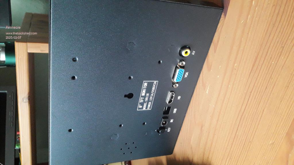

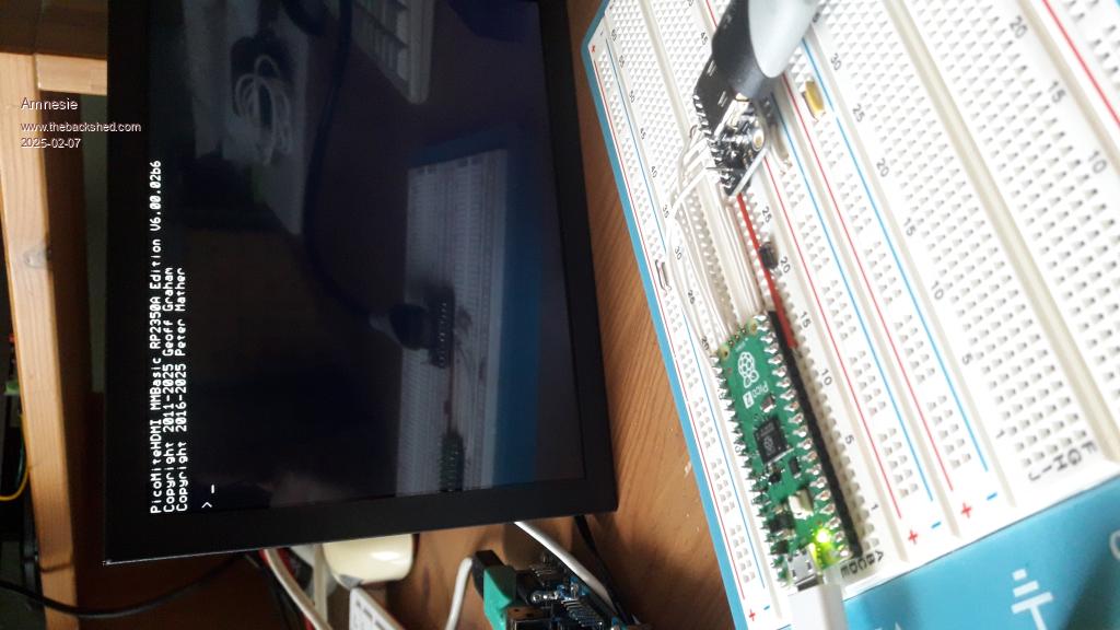

Hello everyone!
Today my new Eyoyo (China) Monitor arrived. And as I've predicted to you:
IT WORKS without any problems in every resolution (HDMI) VGA does work too, love that little 4:3 thingy
Just out of curiosity I knocked on the breadboard-cables, bend them around. ROCK SOLID. There must be some kind of buffer (?) circuit? Otherwise I can not explain why there is no degradation at all.
Thanks to the metal frame I may build a project around it. For around 60€ insane. Built-in speaker, and adjustment menu (something the raspberry pi monitor doesn't have!)
I can't understand why the raspberry pi monitor is so freaking bad.   I'm glad I returned it.
EDIT: Forget to mention it even is an IPS display, looks bright and sharp!

Posts: 4354
Posted: 01:59pm 07 Feb 2025
  Amnesie said  Today my new Eyoyo (China) Monitor arrived. And as I've predicted to you:
Good!
What size is it please? And how much did it cost?

Amnesie
Joined: 30/06/2020
Posts: 763
Posted: 02:28pm 07 Feb 2025
Good!
As mentioned: 8" 4:3 format IPS display and in germany it costs around 60€ it was even shipped from germany (china seems to have a stock here).
