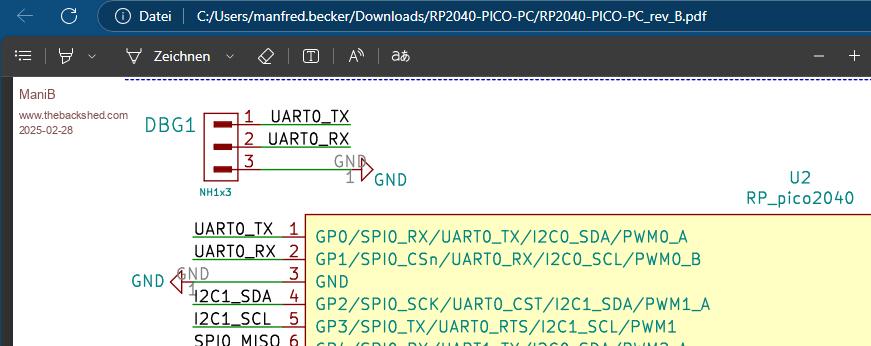

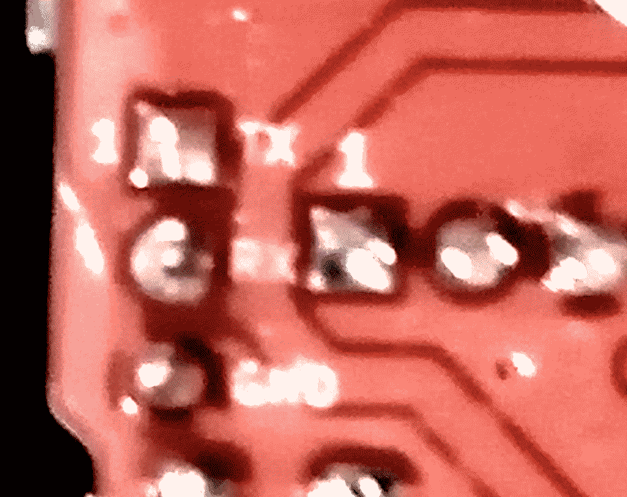

  matherp said  Use OPTION RESET OLIMEXUSB and connect to the serial port header next to the USB
Found it, thank you Peter.
Unfortunately, the Olimexboard did not include a description or circuit diagram, hence the question

  Martin H. said  Unfortunately, the Olimexboard did not include a description or circuit diagram
Which board is it?
Usually they provide both :)
ManiB
Joined: 12/10/2019
Posts: 145
Posted: 09:38am 28 Feb 2025
It is also shown in the schematic:

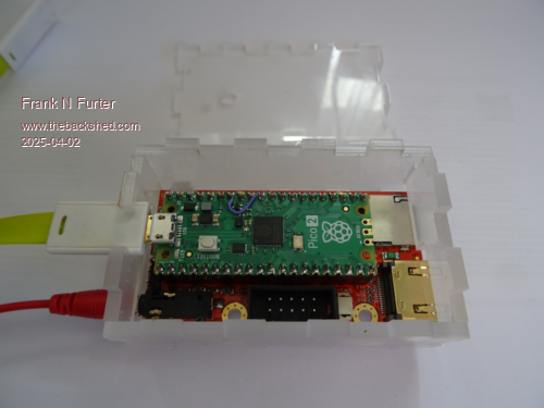

Hi Christian,
1. What kind of documentation are you missing? Actually, everything is right here:
https://github.com/OLIMEX/RP2040-PICO-PC
3. I have a very small wireless keyboard here - but I first have to test whether it works with the device...
4. Where do you come from? I lasered this housing at FabLab here. I may still be able to get hold of the data:
Frank

Hi Frank,
thanks for your information. I'll have to read through the source code to understand better. As it is open source hardware and software, we all can contribute. Let's see - i only just started with PicoMite.
The keyboard looks exactly like that, what i am looking for. Thanks for the link.
I am living a bit south to Münster - from your nickname i assume you're close to the river Main.
If you could send the data for the case, that would be very kind. I'll see if i can find a fablab close to my home town. Thanks!
Thanks again for your efforts!
Best regards,
Christian

  Xian said  I am living a bit south to Münster - from your nickname i assume you're close to the river Main.
Not really! I live near Nuremberg.
  Xian said  If you could send the data for the case, that would be very kind.
It will take a little while. I have to contact someone first (I should have taken the data with me when I helped design the housing...). I would also like to have a few of the housings laser cut again.
Frank
