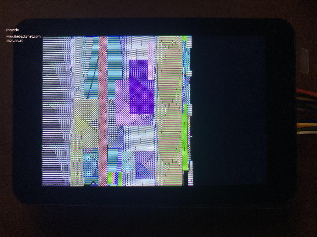

Some further testing of V6.01.00b7 has shown a possible gremlin with the LCD SPI versions.
The FRAMEBUFFER MERGE command either locks up the PicoMite, requiring a reboot and occasional loss of all options and program, or "Incorrect Address - Resetting" (I think) possibly depending on whether the buffered driver is used or not.
Same with ILI9341, ILI9488 and ST7796S LCD's
This does not appear if the LCD is connected to SYSTEM SPI.
Also noticed the Waveshare ST7796S LCD with the buffered driver on LCD SPI:
CPUSPEED OUTCOME
48-172MHz Works
176-180MHz Corrupt/No display
184-300MHz Works
304-332MHz Corrupt Display - Photo to follow
332-344MHz Works most of the time
344-360MHz Corrupt/No display
The LCD SPI / Circles per second wrap @ 180MHz so the above makes sense, possibly just reaching the maximum data rate this display can handle.

Further to previous post, this is a photo of the corrupt display on ST7796S:

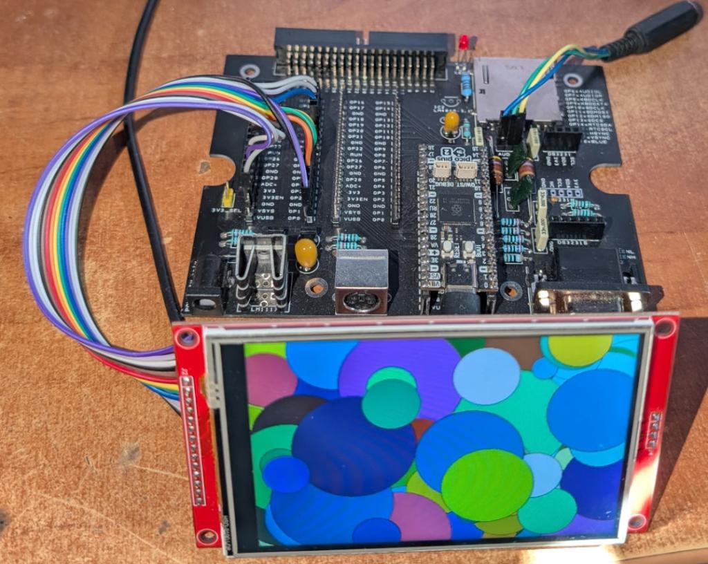

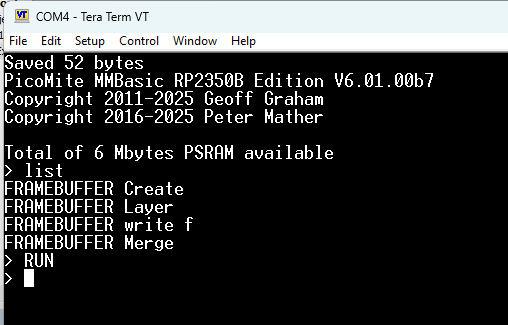

  Quote  The FRAMEBUFFER MERGE command either locks up the PicoMite, requiring a reboot and occasional loss of all options and program, or "Incorrect Address - Resetting" (I think) possibly depending on whether the buffered driver is used or not.
Just run your Lissajous program all night on an ILI9341 with the buffered driver and no issues. Also tested with the non-buffered driver and again no issues
FRAMEBUFFER MERGE 0,b '<======== copy both layers to the screen

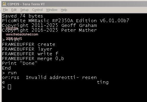

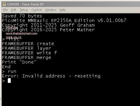

This will completely lock up the Pico, no output to LCD screen or USB console, though the heartbeat is still flashng, it requires a power off and on. I have done a full Option Reset and manually put everything back in and the problem was still present.
Regards, Kevin.

Did a Option Reset, so completly default, then only put back the LCD SPI and the LCD definition itself, then using the simpelest test below, the screen goes white, then clears, but the Pico looks like it has rebooted, ie I'm seeing the re-initialisation of the USB ports message, as below.
> run
> US USB Keyboard Connected on channel 1
> USB Mouse Connected on channel 2
If I attempt a background merge with:-
Framebuffer Merge 0,b
I do get a invalid address error.
> RUN
Error: Invalid address - resetting
Framebuffer Create
Framebuffer Layer
Framebuffre write f
Framebuffer Merge
'Or Framebuffer Merge 0
'Or Framebuffer Merge 0,r,100
Hope this helps.

I dont have a non USB 2350, so I've installed the non USB firmware onto my USB.
I can confirm that the Merge command does work on :-
PicoMite MMBasic RP2350A Edition V6.01.00b7
OPTION LCD SPI GP26,GP27,GP28
OPTION FLASH SIZE 4194304
OPTION COLOURCODE ON
OPTION CPUSPEED (KHz) 150000
OPTION LCDPANEL ST7796S, LANDSCAPE,GP12,GP13,GP14,GP15
As does the Lissajous program now as well. :-)
Regards, Kevin.
