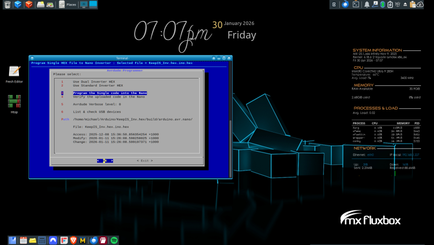

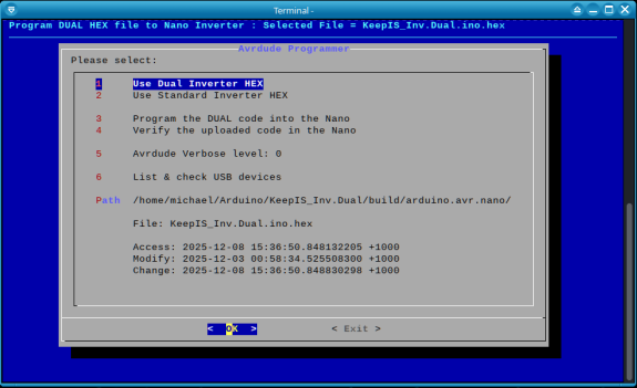

I have written some nice GUI Bash scripts that replace some old Windows GUI apps for the Programming hardware I have.
I actually found the hardware setup easier under Linux when compared to Windows, for the same hardware. That was once I got comfortable with the terminal though, and the real Linux File construct, everything makes sense now.

  KeepIS said  [...] I have written some nice GUI Bash scripts that replace some old Windows GUI apps for the Programming hardware I have [...]
are you by any chance able to post some screenshots and code for these bash scripts? to date i've used zenity to add very primitive/clunky GUI dialogs to bash scripts, but not managed much more. instead, most of my programming is done in lazarus/FPC, which unfortunately does produce enormous binaries when creating GUI applications.

Hi rob, I use a bash GUI package called dialog. It comes pre installed in a lot of distros. I tested Ubuntu and it was missing, about 10 seconds to install with atp.
This script is used to program the Nano via an USBasp programmer using avrdude, it has a launcher in my Main menu under my Programming TAB.
Obviously there are many ways to make this better, but it works perfectly for me, and for a script that's all that matters at the moment, the avrdude programming state and progress are shown in the same terminal running the script, once avrdude terminates it returns to the GUI Menu.
Mouse and keyboard all select correctly.
From memory there were quite a few demo scripts included with the install.
Package: dialog
Version: 1.3-20250116-1
Architecture: amd64
Uncompressed Size: 505 k
Depends: debianutils (>= 1.6), libc6 (>= 2.34), libdialog15 (>= 1.3-20250116), libncursesw6 (>= 6), libtinfo6 (>= 6)
Description:
Displays user-friendly dialog boxes from shell scripts
This application provides a method of displaying several different types of dialog boxes from shell scripts.
his allows a developer of a script to interact with the user in a much friendlier manner.
The following types of boxes are at your disposal:
yes/no           Typical query style box with "Yes" and "No" answer buttons
menu             A scrolling list of menu choices with single entry selection
input            Query style box with text entry field
message          Similar to the yes/no box, but with only an "Ok" button
text             A scrollable text box that works like a simple file viewer
info             A message display that allows asynchronous script execution
checklist        Similar to the menu box, but allowing multiple selections
radiolist        Checklist style box allowing single selections
gauge            Typical "progress report" style box
tail             Allows viewing the end of files (tail) that auto updates
background tail  Similar to tail but runs in the background.
editbox          Allows editing an existing file
Homepage: https://invisible-island.net/dialog/dialog.html
#!/usr/bin/env bash
DIALOG_CANCEL=1
DIALOG_ESC=255
HEIGHT=0
WIDTH=0
avrCmd="/home/michael/avrdude_Linux_64bit/./avrdude"
avrSing="KeepIS_Inv.hex.ino.hex"
SingPath="/home/michael/Arduino/KeepIS_Inv.hex/build/arduino.avr.nano/"
avrDual="KeepIS_Inv.Dual.ino.hex"
DualPath="/home/michael/Arduino/KeepIS_Inv.Dual/build/arduino.avr.nano/"
filePath="?"
avrFile="?"
HexSelect="?"
TmpModFile="FileMod.txt"
vbl=""
vblcnt=0
while true; do
cnt=1
clear
ftime2="No File selected or missing File or Path"
if [ -e $filePath$avrFile ] ; then
  stat $filePath$avrFile | (grep -C1 Modify) > $TmpModFile
  exit_status=$?
  if [ $exit_status == "0" ]; then
    while read -r  fc fd ft; do
     case $cnt in
      1 )
        fchg=$fc
        fdat=$fd
        ftime=$ft
        cnt=$((cnt + 1))
       2 )
        fchg1=$fc
        fdat1=$fd
        ftime1=$ft
        cnt=$((cnt + 1))
      3 )
        fchg2=$fc
        fdat2=$fd
        ftime2=$ft
        cnt=$((cnt + 1))
      esac
    done < $TmpModFile
  fi
fi
 exec 3>&1
  selection=$(dialog \
   --backtitle "Program $HexSelect HEX file to Nano Inverter : Selected File = $avrFile" \
   --title "Avrdude Programmer" \
   --cancel-label "Exit" \
   --menu "Please select:" $HEIGHT $WIDTH 0 \
  "1" "Use Dual Inverter HEX" \
  "2" "Use Standard Inverter HEX" \
  "3" "Program the $HexSelect code into the Nano" \
  "4" "Verify the uploaded code in the Nano" \
  "5" "Avrdude Verbose level: $vblcnt" \
  "6" "List & check USB devices" \
  "Path" "$filePath" \
  ""  "File: $avrFile" \
  "" "$fchg $fdat $ftime" \
  "" "$fchg1 $fdat1 $ftime1" \
  "" "$fchg2 $fdat2 $ftime2" \
  2>&1 1>&3)
  exit_status=$?
  exec 3>&-
   case $exit_status in
    $DIALOG_CANCEL)
     clear
     exit
    $DIALOG_ESC)
     clear
     echo "Program aborted." >&2
     exit 1
  esac
  case $selection in
      1 )
       clear
       filePath="$DualPath"
       avrFile="$avrDual"
       HexSelect="DUAL"
      2 )
       clear
       filePath="$SingPath"
       avrFile="$avrSing"
       HexSelect="Single"
     3 )
       clear
         $avrCmd -N -c usbasp -p m328P -P usb -b 57600 -F $vbl -V -U flash:w:$filePath$avrFile:i
         read xx
       fi
     4 )
       clear
         $avrCmd -N -c usbasp -p m328P -P usb -b 57600 -F $vbl -U flash:v:$filePath$avrFile:i
         read xx
       fi
     5 )
       case $vblcnt in
          0 )
            vbl="-v"
            vblcnt=1
          1 )
            vbl="-v -v"
             vblcnt=2
          2 )
            vbl=" "
            vblcnt=0
        esac
     6 )
      clear
      echo "Checking VanOoijen USBasp programmer in USB list:"
      echo ""
      lsusb | grep "Van Ooijen"
      echo""
      echo "ID 16c0:05dc should be shown above, if bank then USBasp device not found or not plugged in."
      echo ""
      echo "Listing all USB devices:"
      echo ""
      lsusb
      echo ""
      echo "!!!! Unplug the USB programmer, wait a few seconds then plug it back in."
      echo ""
      echo "Press any key to continue."
      read xx
      echo "Checking connected USB devices:"
      echo ""
      sudo dmesg | tail -f | grep USB
      echo ""
      echo "The Output above should show something like the following:"
      echo ""
      echo "[4895.789204] usb 3-1.3: new low-speed USB device number 16 using xhci_hcd"
      echo "[4895.904154] usb 3-1.3: New USB device found, idVendor=16c0, idProduct=05dc, bcdDevice= 1.02"
      echo "[4895.904166] usb 3-1.3: New USB device strings: Mfr=1, Product=2, SerialNumber=0"
      echo "[4895.904169] usb 3-1.3: Product: USBasp"
      echo ""
      echo "Any Key to continue"
      read xx
      esac
   done

FYI. The desktop screen capture of "Monitor 1" that I posted, shows mx fluxbox on the image, but that is a desktop image from an older version of MX fluxbox, I really liked the image "as is" so I used it.
I'm using MX-25.1_x64 Infinity ahs (advanced hardware support) which has now upgraded to the latest stable release Kernel, just below the latest release candidate.
