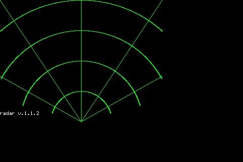

Ok. I had some 2mm female header. Soldered it on to a 2.54m female header after bending pins on both, and plugged that into the white connector on the HLK-LD2450. I plugged it into a USB-serial module, plugged it into my PC, set the baud rate at 256000, and could see characters. Mostly not printable ASCII.
I plugged it in to a Pico1 with latest firmware and ILI9488 LCD, downloaded the .bas file from Radar_v.1.1.2-blit.zip, set the serial port (double checked pin # and Rx/Tx, but could be wrong), and got this:
So that's a good start, but I have no dot, so 2 questions:
How should I determine whether I'm getting serial input, and
Where do I make changes for the ILI9488 480x320 LCD?
Posts: 6626
Posted: 08:32pm 09 Dec 2025
Try this
 ARC MM.HRES/2,MM.VRES,60,,285,75,RGB(GREEN)
 ARC MM.HRES/2,MM.VRES,120,,285,75,RGB(GREEN)
 ARC MM.HRES/2,MM.VRES,180,,298,62,RGB(GREEN)
 ARC MM.HRES/2,MM.VRES,240,,318,42,RGB(GREEN)
 LINE 0,0,MM.HRES/2,MM.VRES,,RGB(GREEN)
 LINE MM.HRES/2,0,MM.HRES/2,MM.VRES,,RGB(GREEN)
 LINE MM.HRES,0,MM.HRES/2,MM.VRES,,RGB(GREEN)
 LINE 0,150,MM.HRES/2,MM.VRES,,RGB(GREEN)
 LINE MM.HRES,150,MM.HRES/2,MM.VRES,,RGB(GREEN)
The target should appear after it sees movement. Wave a hand in front should be enough.

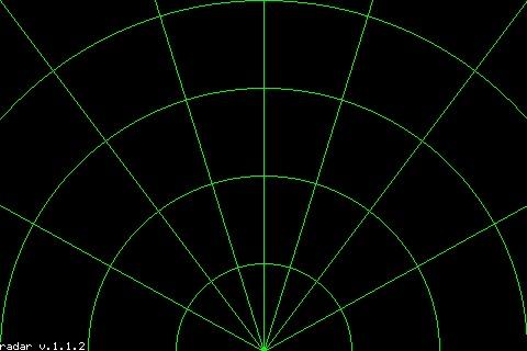

Posted: 11:41pm 09 Dec 2025
have just made a version that adapts the radar-grid automatically to the lcd (or whatever is used) size and also extends the straight lines up to the lcd borders. Also arc is replaced by circle because its easier to code and probably faster. The BLIT technique is kept, as it really saves cpu cycles and/or ram compared with redrawing the grid or using layers.
Introduced a new sub "get_intercept" which gets the nearest intercept point with one of the lcd borders in order to draw the lines up to the border. It's a simple intercept calculation of 2 lines, border and gridline using good ole substituion method. See my comments in the code ....
Radar_v.1.1.2-blit-2.zip

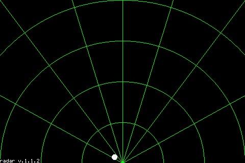

Posts: 3885
Posted: 01:57am 10 Dec 2025
Beautiful screen now with Radar_v.1.1.2-blit-2.bas.
But still no dot. I swapped Rx & Tx just in case, but no difference. Tomorrow I'll hook up those Rx & Tx pins from the PicoMite through a USB-serial module to confirm whether I've got them right.
BTW, "H", "P", and "Z" did not result in any output.
Are the arcs at any predictable distance from the module?
Edited 2025-12-10 12:01 by lizby

Posts: 3885
Posted: 07:55pm 11 Dec 2025
Working now, thanks, all. The pin labelled "0V" on my PCB was not actually connected to 0V.

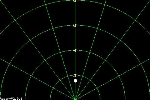

ville56
Joined: 08/06/2022
Location: Austria
Posts: 646
Posted: 01:48pm 12 Dec 2025
Lizby,
no need to interrogate AI, this is natural NI (No Intelligence) answering
- as I wrote, a good GND connection is always your friend (had that already myself several times)
- the max range of the sensor is 8000 mm as of the datasheet. It certainly also depends on the size of the target how far the actual range will be.
- the attached V2.0.1 has now distance labels. You can modify the parameters as you like. They are at line 101 onwards, please read the comments. But labeling in feet and inches may be a bit of a challenge ... at least for me as a metric guy.
Radar-V2.0.1.zip
Gerald
73 de OE1HGA, Gerald
