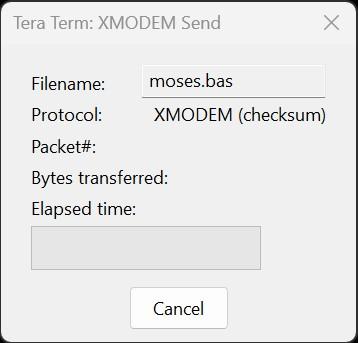

  matherp said
Note: one user is reporting issues with XMODEM, can anyone confirm any problems? I can't replicate.
XMODEM RECEIVE
works fine but
XMODEM RECEIVE "structest.bas"
hangs up. The transfer never starts but Ctrl-C exits OK. I'm using EXP5 on a Pico2350DIL V1.2.

Posts: 12059
Posted: 12:04pm 01 Jan 2026
You don't say what you are using to transmit. Works perfectly for me EXP5 Pico2350DIL V1.2 with W11/Teraterm. Paste line delay set at 20mSec

  matherp said  You don't say what you are using to transmit. Works perfectly for me EXP5 Pico2350DIL V1.2 with W11/Teraterm. Paste line delay set at 20mSec
I'm using Tera Term 5.40 on Windows 11. The box below never changes
Here are my options:
PicoMite MMBasic RP2350B V6.01.00EXP5
OPTION SERIAL CONSOLE COM2,GP4,GP5,BOTH
OPTION SYSTEM I2C GP6,GP7, SLOW
OPTION FLASH SIZE 16777216
OPTION COLOURCODE ON
OPTION CONTINUATION LINES ON
OPTION CASE UPPER
OPTION DEFAULT COLOURS GREEN, BLACK
OPTION PICO OFF
OPTION CPUSPEED (KHz) 396000
OPTION LCDPANEL ST7796SP, PORTRAIT,GP14,GP15,GP13,,INVERT
OPTION SDCARD GP17, GP18, GP19, GP16
OPTION PSRAM PIN GP0
Edited 2026-01-01 23:12 by toml_12953

Re the xmodem issue, what exact version of the firmware are you using USB? normal? What options?

  matherp said  Re the xmodem issue, what exact version of the firmware are you using USB? normal? What options?
I'm accessing the Pico2350DIL through the USB port. When I do an OPTION RESET, XMODEM "filename" works. When I use the options below, it doesn't. I've tracked it down to the SERIAL CONSOLE option. If I remove that option, XMODEM transfer works with a filename.
OPTION CASE UPPER
OPTION PICO OFF
Edited 2026-01-02 01:29 by toml_12953
