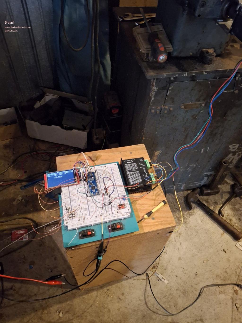

So today thought to have a play with this Y axis and at first I just used the inverted circuit with the transistors and found the stepper motor was nice and noisy and hammered when trying to do some steps so stopped it straight away.
Went and found some 1K and 22K resistors and wired it up to Lyles circuit next thing the stepper was working
So been having some fun calibrating the stepper and settled on 3200 steps with 2.7 amps which at full current when switch 4 is on gave a holding current of 284mA.
Found 258 steps to be pretty spot on using my dial indicator and just spent an hour so resetting the thrust bearing on the rear of the leadscrew and found 1.92mm backlash repeated several times.
Now on reading the stepper PDF with the Stepper Close it states it releases the resources and shuts down the Stepper sub system now by using my programmable power supply that 284mA is still there holding the stepper in position. So I did think after a Stepper Close the holding current for the stepper would be off.
So it good to see this Y axis does work
Here is a pic of the breadboard setup
Regards Bryan
Posts: 3416
Posted: 05:47am 03 May 2026
  Quote  So I did think after a Stepper Close the holding current for the stepper would be off.
In that case after Stepper Close use SetPin GPxx, OFF for all the pins.
Stepper close
SetPin GP26, off
Setpin GP25, off
Ok tried that and the power supply didn't change and the holding 283mA current is still there.

I think the holding sets in when enable is high.
Edit: I think the higher the micro stepping, the lower the torque. 1/100mm can usually be done with 1/16 stepping

To reduce the holding current to zero you need to use the enable pin, otherwise the driver will stay powered

I suppose it might be a case of whether braking is wanted. Disabling the driver, by killing the current, will remove the braking. I've absolutely no idea what is wanted here. :)

As others have pointed out, the ENABLE input on a lot of these stepper drivers is really a DISABLE input, if you APPLY a signal it will DISABLE the driver. The circuit posted a while back has the base resistor for the enable transistor going to +3v3, this applies the ENABLE signal when the stepper system is closed and disables the driver (I hope)

As the DM556 has the enable on by default I left the connection off yesterday so yes another BC337 needs to be added so the enable can be hooked up which I will do today so  can test when the program ends the holding current is turned off.
One thing I didn't do yesterday was work out the resolution per step
258 step per mm equates to 0.0038 mm per step   Now when setting up the Z axis which is the next kettle to boil getting close to that resolution or better can mean when putting on a cut with the grinding wheel only 1 or 2 steps are needed.

 gui page 3
   else
  if click(val)(Z1) then : rgb(green)
  else
 gui page 4
 end if
 end select
 end sub
 gui setup 2
 gui caption xsetup, "X Axis Config" 60, 20, rgb(green)
 Gui setup 3
 Gui caption ysetup, "Y Axis Config",60, 20 rgb(green)
 gui setup 4
 gui caption zsetup, " Z Axis Config", 60, 20 rgb(green)
Those consts will need to be cleaned up but for the first day of coding in a longtime I will get there.
It will be good for some assistance to get the multi page setup going so all the other pages can get started.
Regards Bryan
Edited 2026-05-04 17:35 by Bryan1

Posted: 08:09am 04 May 2026
select case click(ref) is CMM2 I think
SELECT CASE TOUCH(REF) is Picomite
It most likely thinks click(ref) is an array where you have not defined ref
