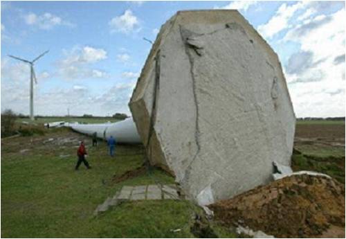

No matter how well you design something, the wind is a powerfull beast.
There is always the unexpected.
WHOOPS!
Pete.
