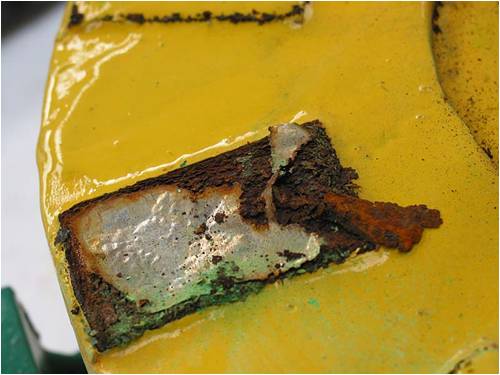

i dont doubt the adhesives you mention are extremely strong and i,m sure they would bond very well to the nickle coating on neos but heres my concern...
the coating itself has at best a very tentative grip on the neo material beneath and its microns thick , i dont think its purpose is for mechanical strength ....but thats just a personal opinion
if the coating is compromised in any way due to corrosion , bad handling or even a scrape it can blister and can be easily peeled off...try it with an old neo its very easy...
once the coating is damaged you'll peel lumps of it off with your finger nail in a second or two
the adhesive properties of nickle to the magnet beneath
are similar to a banana skin and the fruit beneath
this is just some off my experience with them ... all be it the bad ones...maybe i,ve been unlucky but i,ve seen a fair few nickle coated ones fail this way in open axial machines
heres a worst case scenario ..the nickle coating is in freefall , its only a matter off time ,
not pretty... but in some cases that can be the level of protection and strength nickle gives , the rotor above came out of a working machine with no signs off rubbing the stator yet the coating still failed , why it happened is anyones guess
its not all bad ...and i really dont want to be negative but neos can be a pain in the ass sometimes ....theres nothing new here , magnet problems on rotors seem to crop up and frustrate people ..me included , how to minimize the problem is the big question
ps ...climate seems to be a major factor... here its perfect for corrosion , maybe that colours my thinking ...

i'm out of my depth here, personally i cant see any problems with running magnets on both sides of a disc,
BUT i think it would be better to use the magnets both sides so perhaps something that grabs them down their sides?
Bury the whole things in epoxy, should solve all these corrosion issues (and fly away magnets)
Tules has suffered some neo cancer recently too!

Epoxy wont stop fly aways as it has little strength except on face to face surface contact.
It has been said many times that several coats of epoxy paint over the magnets for enviromental protection is required, and i think Oz has stated this many times to.
I see no reason back to back magnets can not be used as long as the poles were reversed either side of the plate.
