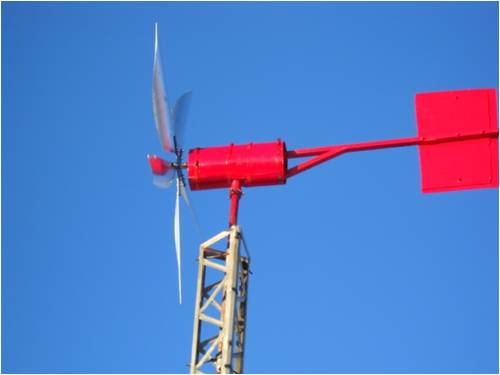

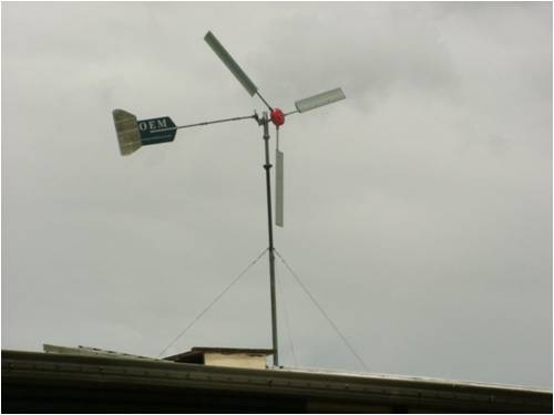

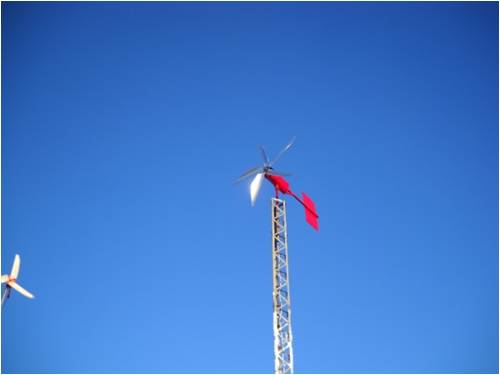

This is Isaiah on Bub's laptop but we have some pic's for you!
I had some help and the weather wasnt too real bad so we stuck it up or we may have taken more pictures.
The mill is a ECM 180 volt 10 amp rewired JERRY.
AND YES when it went up the blades lopped over a couple of times and quit so we wont have wind for 5 days now!! ''
At this time 8:38 pm yesterday the temp is 5 deg f. and for once a nice blue sky.
We had a great solar day but my gloves froze to the shed roof while we were putting the mill up!
When we get a breeze we will see if the mill still puts out!
The second picture is with the zoom and looks like the blades may hit the tower but this is not the case,just camera angle and camera operator.
Isaiah ''
VK4AYQ
Joined: 02/12/2009
Posts: 2539
Posted: 03:37am 16 Dec 2010
Hi Isaiah
Thats Murphy law of wind section 2.
Looks good though and very visible no plane will run into it.
Will be interesting to see how much power it makes.
You did a good job with the photos, its no to hard once you get the hang of it.
I am in town today getting some bits and pieces and there is another big storm happening, not much wind here but will be interesting to see if the mill survives today as I am not there to hold its hand.
Don't hang onto the roof so long, and dont try to lick off the ice.

isaiah
Joined: 25/12/2009
Posts: 303
Posted: 05:23am 16 Dec 2010
Hi All
That is a piece of galvanized stove pipe I made into a weather shield.
It covers the ECM Motor and the pivot area and back to the tail support.
It is held on with large hose type clamps.
That is snow froze to the tower half way up in the first picture.
My other mill I used a piece of 10" pvc to make the weather shield and that gives around 2'' a side clearance this worked good except the birds started building nests in it!! The birds would land on the tail and go in to the shield from the back side weather the motor was running or not!
The next project is to pull that mill down as it sometimes make a non funny noise!
It is either debris in the cooling fan or a bearing going bad It has been up over a year in several heavy storms.
This motor (DAYTON 180 VOLT @1710 RPM4.5 AMP.) has the two big horse shoe magnets and the wires are on the armature.

It bothers me somewhat with how you have your tail and yaw bearing setup.
To me it looks like an accident waiting to happen.
Or is this mill not meant to furl??
Pete.

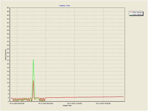

VK4AYQ
Joined: 02/12/2009
Posts: 2539
Posted: 01:45pm 16 Dec 2010
Hi All
This is a capture of the front coming through today, disregard the reading to the right of the frontal peak as the memory filled up and as a result it didn't catch the second front later in the day. Mill survived OK so far even not furling properly.
All the best

isaiah
Joined: 25/12/2009
Posts: 303
Posted: 03:34pm 16 Dec 2010
Hi
Pete, Bub said the ECM you don't have to worry about furl!
So that is a non furling tail.It is though offset to one side.
Jim I'm in southwest Michigan25 miles n of the Indiana line.

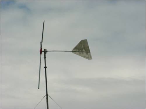

VK4AYQ
Joined: 02/12/2009
Posts: 2539
Posted: 12:39am 22 Dec 2010
Hi All
To carry on with the effort to get the mill to track the wind and furl better I have fitted a larger area but slightly shorter tail vane, in the light winds thismorning it was tracking better and more stable with the wind direction, so that side is a positive.
How the furling will go remains to be seen when a bit of wind comes along, the new tail is a piece of 1.4 mm marine alloy so is quite stiff and reduces the tail weight by 1.8 kilo. I am hoping this will reduce the furling moment to get it to furl by 12.5 ms as thats full power + a bit total amperage 50 amps.
The new tail Vane.
Compared to the other vane extension.
As you can see it is quite a bit larger and higher to get it out of the turbulent air in the middle of the disk, time will tell if it is an improvement.
All the best
Bob
