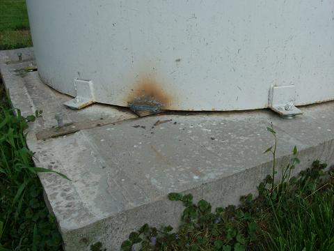

After the thunderstorm past I looked things over, no damage, and everything is shower fresh and clean.
I did notice though...I had'nt welded the "tank" down to the main frame, it is ancored to the cement by tie bolts every 18 inches. I installed flatwasher shims under these brackets and tightened everything down again. Then brought out the welder and welded the tank to the main anchor frame.

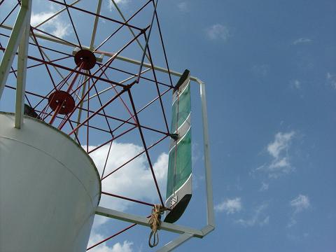

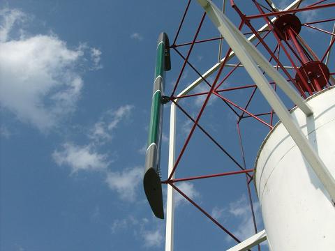

I also took a picture of the inside of one the mounted wings, I thought you guys might not be clear on how they bolted on to the rotor assembly. You can see that the vertical part of the frame is flush with the wing surface.

Yes, the "beast" is literly tied off by a rope leash. I've put up another picture of the inside mounting of the wing details. In this picture you can see the leading edge profile, in the last picture,(previous post), you can pick out the 1/2* dehedral in the trailing eddge.
As I stated in an earlyer posting, I have'nt decided or made final plans for the alternator. I'll need to see what the average rpm will be "loaded" in a 10 mph wind, and then be able to fit a proper size alternator.

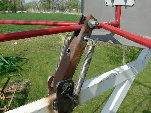

I made up two parking arm assemblies and welded them inplace this afternoon.
I've taken the rope off.
As you can see in the picture, take out th top bolt and then piviot the arm inward and down and it will rest there until needed again. Its Spring loaded so it does'nt rattle around in the wind. Its made out of 3/8ths.x4 inch plate, and 2"x2" heavy wall sq. tubeing. Welded with 6010 root pass, 7018 middle and top passes.DC-.
Maybe tomorrow I'll be able to get to the "break system".

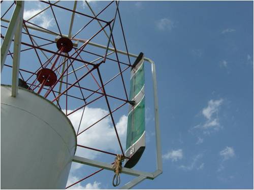

mac46
Joined: 07/02/2008
Posts: 412
Posted: 10:16pm 10 May 2011
I made a mistake on that last picture as you can see...ths one.
