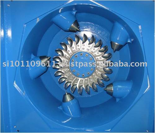

If you are interested in water turbines of all shapes and sizes this guys gear is worth looking at. I see his stuff everywhere.
Mr. Tomaz Razpet TINCK INZENIRING Cerkno Slovenia
he does Francis, Kaplan, Denki, crossflow and Pelton from the size of your hand up to 3 MW.

On the topic of the suitability of different turbine types for your application, there is a measure called turbine specific speed, which relates the desired shaft speed, power output, and available head. Wikipedia and other internet references give a reasonable explanation of how it is calculated.
This measure suggests the most suitable turbine type for a given application. Impulse turbines such as the Pelton operate with low specific speeds (around 4), while propellor type turbines, such as the Kaplan operate at 100 and above.
Note though that this measure only indirectly allows for the amount of flow available, in that the P or power element of the calculation would not be sustainable if you sought to extract more power than your water supply flow could consistently give.
While the available head is low for an impulse turbine in your application, so is the available flow on a long term basis, so an impulse type turbine is probably the best choice. You just have to accept that you can not get more electric power from the set up than the available hydraulic power.
Incidentally, with regard to your Pelton wheel, I realize now that it is intended to work only with a single nozzle, with the flow being split (and reversed) by the bucket pair, and discharged from the sides of the buckets. If you are re-working your Pelton wheel, it would be worth paying attention to the area where the buckets touch and the split occurs, as this needs to happen as cleanly as possible.
A dual nozzle, of the type that I previously suggested, would not be of any value, and this is apparently consistent with your test results. Accurate aiming of the single nozzle is, however, quite critical, again as you have found.

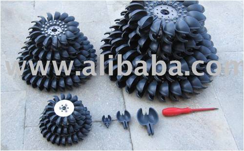

Cups should be 5 times the size of the largest nozzele used. I have cups here that are about 30mm but i am sure there is a supplier in the States.
Cost here is about $5 (nz)
However the efficiencies you Have been getting here seem justify you proceeding with your approach. I have build a lot hydro's been involved with a lot more and with micro hydro's the efficiencys range from 30% to 60 %.
when the water hits the wheel it ideally should deflect 180 degrees this is immpossible pelton designs for 165 .
Water hiting a flat plate will in theory max eff possible is 50% so bearing losses etc are on top of this.
