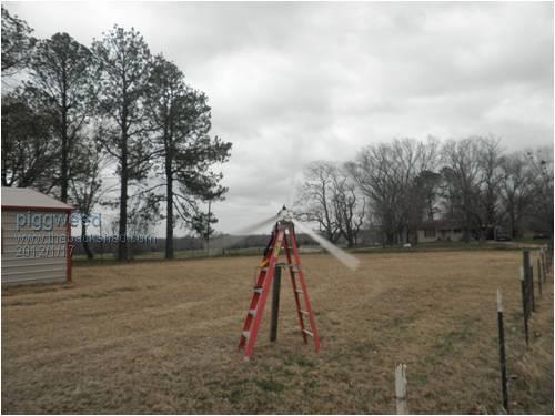

Posted: 08:02pm 16 Jan 2012
I am going to make some new blades, the pic shows a 18 mph winds and the servo rpm is 140.

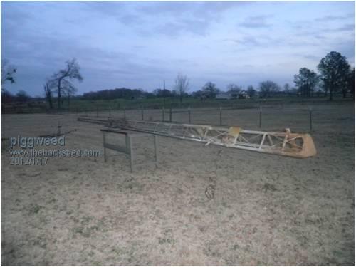

Posted: 12:28am 17 Jan 2012
Bub73, I took your advise about making, and weld a pivot tower. I got this old tv pole for free, all I had to do is take it down. It's almost 40' tall. It looks pretty sturdy. It uses a winch to drop it almost hafe way down and has two guy wire locations, one set at the top and the other about hafe way up. If anybody see's a problem with it, please post.

Posted: 12:32am 17 Jan 2012
I don't know if anybody has posted about this, but theirs a lot of tv towers out there not being used since tv went digital and you might be able to get them just for taking them down. I did.

Posted: 05:40pm 20 Jan 2012
Warpspeed you where right, I a have the rectifer hooked up and it going to low battery. At 270rpm I get 13.5vdc and 1.5 amp. At 350rpm I get 19vdc and 5amps. I've looked on the forum for a dc input voltage regulated controller but did not find anything. I am looking for a controller with a input say 8 to 40vdc and output 12 or 24vdc rated for 160 or 80 amp. Any suggestions on the best way to regulate the controller input or is there a controller with varible input voltage? I have not yet decided on 12 or 24. I already have the 12vdc inverter, but 24vdc system sounds good.

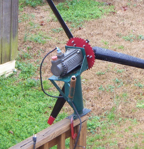

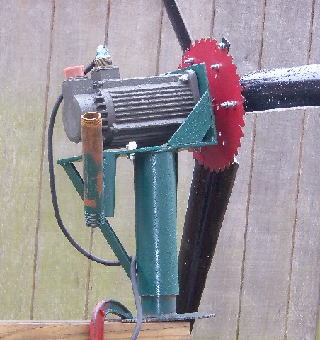

Hey guys....
Just put this on the universal mount yesterday and got it all firmed up.
Put some 6 foot PVC blades on it for a test run on the 25' tower.
This is an Omron Servo Motor, 600w, 253vac, 3,000rpm, ($23. bid and 16.50 on
Shipping-FleaBay)and it should start putting out 15v at about 175rpm.
I can get 3-4vac (unloaded, 1 phase) by just spinning on the mount here.
We've had a storm come through this morning with some pretty heavy gusts
so I didn't have to wait to put it on the tower. That sucker started spinning
right there and almost sounded like an airplane revving up!! Scared the crap
out of me!!
Hey "97fishmt" (Mike), does that mount look familiar? I copied your mount build
and have had 3 motors on this thing so far (Servo, ECM, and DC Scrubber Motor).
Just trying to see what suites me best for my location here in Alabama.
You guys have a great day, eh?
Bill
97fishmt
Joined: 19/04/2010
Posts: 77
Posted: 06:10pm 21 Jan 2012
It looks super nice Bill!
Do you have to add weight to the tail
when changing out motors or blades?
On my mount I haven't even bothered
to change the offset on any change-outs.
The bolt holes have all lined up so far.
The beauty of the motor on top of the mount
and the tail off the other side is it can
accommodate larger and longer motors, even
smaller ones and it's easy changing them over.
I've made my tail vane able to accept rebar
inside the boom pipe to dial in the furling.
Also once and awhile a small tweak to the upward
tail stop if a motor is bigger or longer to keep
it into the wind without adding more to the tail.
Nice job Bill!

wilfor03
Joined: 22/03/2009
Posts: 5
Posted: 06:27pm 21 Jan 2012
Hey there, Mike
I haven't really had any winds that challenge the furling yet, so can't really
comment on the furling (good or bad). But, yes, I can add more weight easily if
I need too.
Yup, can switch out motors (and wiring-ac or dc) in about five minutes time. I've
got several holes drilled in the face mount (where the genny bolts to the mount)
so whatever motor pretty well matches up with the mount.
Also, offset the furling rod a couple inches for adding a longer motor if needed
later on. AND, put a 3-4 degree angle on the mount plate/tower pipe for more clearance
if I was to use longer than 6' props (wood or PVC).
Got all this great info from YOU, and I thank you for it. Just hope I can help others
as you have helped me!!
Bill
