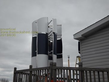

dual blades with transmission VAWT
Dual blades added belt drive. Small blades attached on output of transmission. Large blades attached to transmission input.
Hoping to remove load that the transmission adds to the system.

govertical
Joined: 11/12/2008
Posts: 383
Posted: 09:29am 30 Apr 2013
Video showing side
just because your a GURU or forum administer does not mean your always correct :)

Posted: 12:04pm 01 May 2013
power in the wind
Hi, the above link calculates the power in the wind at different speeds and for different size blades.
Basically I see two areas of power loss, mechanical and electrical. Hopefully the new blade configuration will address the power loss that a transmission adds to the system. The buck converter circuit with adjustable duty cycle that you helped me with solves the electrical power loss at the stator.
This VAWT configuration is low cost, safe, and easy for me to fabricate. The goal is to have multiple VAWTs operating in parallel to produce electricity. Check the CalTech video on VAWT wind power farms.
I am continuing to test and fabricate. I will post results when available. Thank you to everyone on this forum for their help and suggestions.

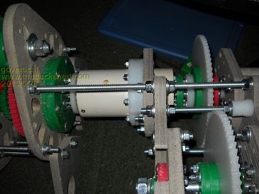

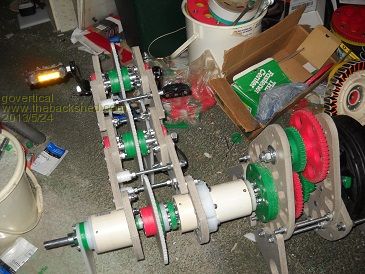

Hi, summer time is a low wind or no wind condition at my location. I fabricated a pedal generator so testing can continue.
Edited by govertical 2013-05-25
govertical
Joined: 11/12/2008
Posts: 383
Posted: 07:01pm 25 May 2013
pedal generator
I completed the pedal generator
Downwind
Joined: 09/09/2009
Posts: 2333
Posted: 12:52am 26 May 2013
I would hate to calculate the loss of energy through the drive chain, it would be huge.
Remember a 1:1 ratio will always be far more efficient than a geared system.
Basically you have taken a poor designed alternator for your purpose and adapted a gear system to make it work, well done on design, but low marks on a efficient use of energy.
Pete.
Sometimes it just works
govertical
Joined: 11/12/2008
Posts: 383
Posted: 01:39am 26 May 2013
CalTech Study
Hi, thanks for the heads up on the efficiency issue. I am working a over voltage protection circuit to prevent damage to the MPPT circuit during high wind condition. The OVP should brake the turbine when triggered by placing a resistive load across the PMA. No wind, no power. The Pgen is just for testing the circuit and maybe burn a few calories. Edited by govertical 2013-05-27
govertical
Joined: 11/12/2008
Posts: 383
Posted: 03:18am 27 May 2013
Pete.
Hi, the F&P is low cost and easy for me to modify. It saves a lot of fabrication man hours. The low efficacy of is the F&P is solved when a power conversion circuit is used. The power conversion circuit can take the form of a MPPT circuit or a DC to DC converter with a variable duty cycle. Earlier test results revealed limiting the duty cycle of the power conversion circuit to under 50% prevents turbine stall. When I compare my test results with the VAWT power calculate at http://usvawt.com/cgi/windpower.cgi?h=5;hunit=0.3048;d=4;dun it=0.3048;Calculate=Calculate , my test results track the calculated values well for the size blades and wind speeds I have measured.
Once a working over voltage protection circuit is created to protect the power conversion circuit, it will be possible operate multiple low cost VAWT in parallel to harvest higher amps at lower wind speeds.

fillm
Joined: 10/02/2007
Posts: 730
Posted: 09:37pm 27 May 2013
As I have said before in this thread , with your skills and obvious access to a CNC router you should be doing an Axial Flux type alternator , wind the coils to suit your RPM range and if it overloads then you can couple the AC with series Capacitors to match the load, if needed at all . No need then for MPPT and all the other Bull Sh!t and quoting CAL TEK and USVAWT every second post .
It would be so much easier than the amount of gearing you already cut out , but you seem to maybe have an aversion to working with a couple of steel plates , most of it can be done with your plastic chopping boards as moulds and templates. You may even be able to get away with ferites if the discs are big enough.
The other thing I can not work out is why you actually need so much gearing , a 60S or 80s F&P will produce 12V easy at very low rpm if wired correctly , a 60 could be as low as 10rpm , you have what looks to be 6 x 3mtr high sails and these can not develop enough power with that much area to get 350W which is about what a F&P is generally good for, then maybe the alternator is not the culprit with the low efficiency problem.
If it is stalling then Glenn explored The staggered stator Mods.
Sure you can try and run the F&P at high voltage / high RPMs with gearing and adding in MPPT extra surface area and all the other mods you have tried and after all that if you are not getting better than 350W then what is the point, so far , and might be wrong you have not given any output figures ?
The pedal power thingy is a work of art but is no different than wackin a F&P on a old scrap 10 speed Bike frame, but nice work all the same ... Are you a clock maker ? Edited by fillm 2013-05-29
govertical
Joined: 11/12/2008
Posts: 383
Posted: 12:15am 28 May 2013
Hi, no I am not a clock maker. The increased cost of the Neo magnets have ruled out the axial flux PMA.
Feel free to fabricate a VAWT 6' by 4' and follow your own advice on what to use for a PMA. Then we can compare results. New ideas take while to catch on. It is ok, you do not have to like them. Remember, it always starts out to a nice day.
I added a threaded rod to reduce the wobble when pedaling. Continuing work on OPV circuit.
