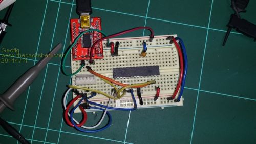

@elproducts:
Is this this usb-converter board you are using?
https://www.sparkfun.com/products/718

Posts: 3368
Posted: 12:49am 14 Jan 2014
  TinkersALot said   This board should work for a beta-bed shouldn't it?
You don't have to get that complicated. I did the whole development on this breadboard.
Geoff

  TinkersALot said   @elproducts:
I actually used the older version of this one.
Sparkfun adapter
But either one will work. Yours is the same one Geoff uses in his picture which allows you to solder pins for breadboard attachment . Mine required wires.

TinkersALot
Joined: 20/11/2012
Posts: 72
Posted: 04:46am 14 Jan 2014
@Geoff and @elproducts -- Thank you both for your feedback. I opted to go forward with the board that elproducts showed us because of it having a "built in programmer" for the device.
