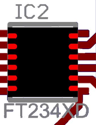

Thanks to the fine work and time that Lou Cassady put in this weekend, I think we can report that the uMite-28 pinner proto-board seems to be functioning OK... I have not tested the Rs-485 transceiver part yet, but hopefully will get this done later in the week... At work this week, we will be finishing the system testing of a 450kw switchmode inverter unit for the company. (Bitrode Corp.) So it going to be a busy week.. (I will try not to get killed off.!)
So, anyway, I wanted to forewarn anyone who wants to get these boards that trying to solder on the FTDI USB chip is going to be a "Royal Bitch"..! I tried to get one soldered on while at Lou's house on Saturday, but couldn't get it done.. I was holding it down with very thin tape and giving it a go, but as soon as I got some liquid flux on it, it would "unstick" the tape..! Damn.. After 2 hours of trying.. I gave up on it..!! fortunately, there is a guy, (Jean at work, who works in the PCB dept.) managed to get 2 of the USB chips on Friday before testing during the weekend... To further complicate this, there seems to be a slight registration problem with the device footprint also that I noticed a Lou's house while looking at it with his video microscope. I had used a DFN-10 footprint I got online and modified it into a DFN-12 package for use in the design. At the time, I didn't have any USB chips to check it with... I will talk with Jean this week about getting more of the USB chips soldered on he boards. He is good at doing SMD work and we have a nice workstation microscope there...
Does the registration problem look like this composite I did from the data sheets and your overlay?
If so I see the problem and the chip is only 3mm square.. Real bummer to do that one.. If you run into strife I will have a go for mine (if you have spare chips to sell) but it would probably make my eyeballs implode even with Maggy light and microscope.. You will need a super pointy tip for your iron.
Dont sweat on it though I am sure we will get over that problem.

Why does that drawing stir some memories......
Happens to everyone i guess.
Nothing to worry about though as it is still manageable.
I got good results by putting a little solder on the islands first, then added some flux and held the part in place while reflowing the solder on two corner pins.
The rest was just a drag along the pins to finish it.
With some practice it goes reasonably quick.

Yes, it does bring back memories... My common mistake is 0.20" spacing on caps that have 0.10" pins and vice versa..
The problem with your solder method quoted above is that the FT234XD chip is a square chip with no pins as such, they are 'LANDS' up the side of the chip and will be quite tough to solder when they are offset..
Tough! Not impossible...
