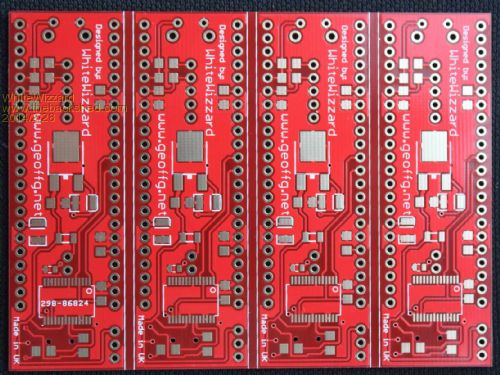

Sorry to say this to you but mine have just been delivered. Happy Days!
Will post photo soon - initial reaction is they look GREAT!
Only problem is that since I panellised them (4 per panel) I now have to pop out to get a tile cutter.
Phil

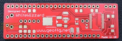

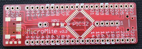

Posts: 2991
Posted: 11:16am 28 Feb 2014
And here they finally are
Chose the red pcb colour option with ENIG finish. They truly look soooo much better in real life than they do in the photos below (apologies about my lack of photography skills. I'm not sure why they keep getting rotated 90deg).
So does anyone have any top tips for cutting panellised PCBs??
I am about to try a tile scorer but am willing to try other methods.
Please do share any experiences (good ones preferably) . . .
Phil
Posts: 2552
Posted: 11:23am 28 Feb 2014
use a steel ruler and a metal scriber to create a deep score down each side, then just snap off - if necessary starting at one end. DO NOT use a non-metal ruler, and DO NOT use a craft knife. either will likely end up in damaged fingers or worse.
it is a bit late now, but all the places i have dealt with in the past have been able to provide milled groves for breaking apart boards at no extra cost.
rob :-)
Posts: 2991
Posted: 11:31am 28 Feb 2014
Thanks Rob. This is what I was effectively going to try with my tile cutter so thats good to hear.
iTead don't let you use holes/grooves when panellising (according to their rules) - only a silk screen line to separate the boards (as can see in top photo).
At least I only have three straight lines per panel to create four PCBs.
I read that using a honing stone is a good trick to finish the edges too.
Posts: 2991
Posted: 12:04pm 28 Feb 2014
Ok. That wasn't too painful
And I've still got all my fingers and thumbs!
Only another 29 scribes to go . . .

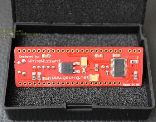

Posts: 2991
Posted: 06:53am 01 Mar 2014
First board successfully assembled and working .

Posts: 2991
Posted: 08:25am 01 Mar 2014
  TZAdvantage said   Sweet!
Very compact and clean design.
I must say your soldering skill is very good.
Thanks TZA Even impressed myself - heres the back of the PCB . . .
Geoff: Hope the silkscreen is ok with your www. I based it on comments you made on Zonkers post and also the email you sent me. Please let me know if you want it changed/removed.

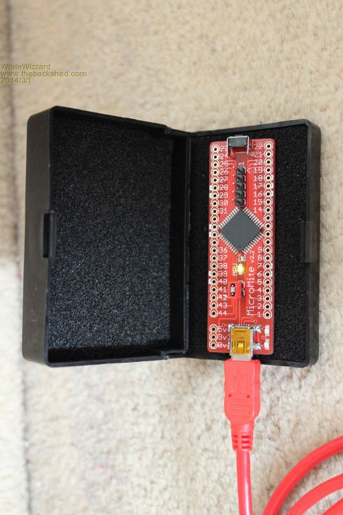

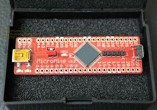

Posts: 2991
Posted: 02:56pm 01 Mar 2014
All,
Thanks so much to all of you that have contacted me regarding obtaining some 44pin TQFP Eval boards.
It is such a nice surprise to know that there is so much interest out there. I promise to respond to all your requests personally by PM during the next 24hours.
To be as flexible as possible I am prepared to initially offer various options.
These options range from PCB only, to kits of components which require soldering, to fully pre-built units.
Options also as to what components are included i.e. PIC (+ICSP + Reset), or PIC+LDO, or PIC+LDO+USB.
Initial Pricing:
£3.00 = PCB only. Need this as a minimum. Then add required Options from::
+£6.00 for all PIC components (includes: 50MHz PIC32MX150F128D, all caps, ICSP header, reset switch, MPU Power Led, all Headers to plug into breadboard/PCB)
+£2.00 for all LDO components (includes: Dedicated 3v3 500mA LDO + caps)
+£6.00 for all USB-to-Uart components (includes full FTDI circuit: Tx/Rx leds, PTC, USB connector for Power+Comms, module Power jumper)
The above are costs for self assembly kits i.e. you will be required to solder SMD components.
For those of you that prefer pre-built units then add the following labour costs:
Costs for assembly of above options:
+£2.50 PIC circuitry
+£0.50 LDO circuitry
+£2.00 USB circuitry
So prices range from £3 for a bare PCB to £22 for a fully assembled 44pin TQFP MicroMite module.
If you already have your own USB-to-Uart module then go for the PIC option (£9 kit, £11.50 ready assembled).
Note that the above options are offered based on feedback already received and offer you choices from as low as £3.
Packaging for low volumes will be charged at £1.75. Shipping extra; will use your preferred method.
As a special offer to forum members, I will do the first 5 assembled units AT ZERO ASSEMBLY COST on a first come, first served basis. This means that a completely built 44pin TQFP module will cost you just £17 + p&p.
Note: Photo does not show header pins - however, they are included in the PIC option.
Any further suggestions or requests are most welcome - simply let me know!
