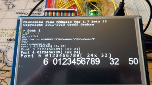

As I am slowly getting my head around the uM+ I have spotted another discrepancy in the Advanced Features manual. Page 17 has a chart listing the six built in fonts but they are in the wrong order as I have shown in this picture. The large number font should be listed as font 6 not font 1 as shown in the manual with the rest of the font numbers adjusted accordingly.
EDIT. Is it intentional that none of the SPI, I2C and ONEWIRE commands are mentioned in the command list of the User Manual, only in the appendix? The serial commands get a mention in the command list with a note to see the appendix.Edited by Greg Fordyce 2015-09-06
