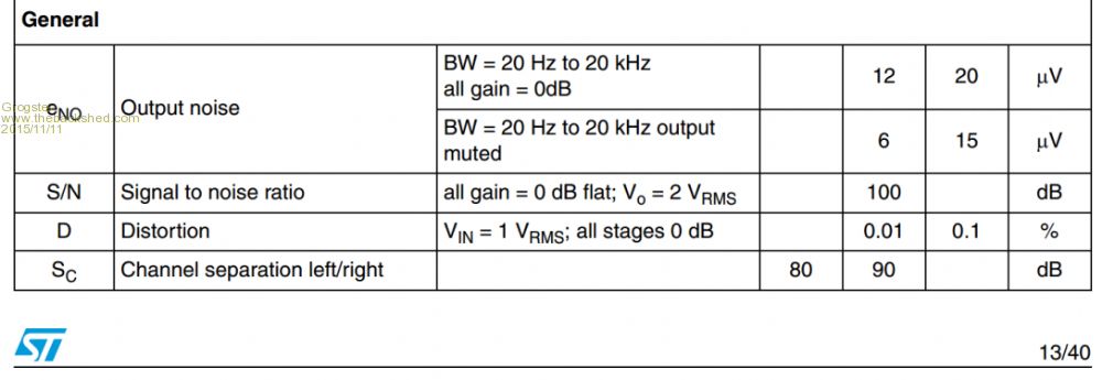

The preamp sounds OK audio quality wise, but the output is drenched in white noise, and unless there is some way to filter that out via the settings, it makes the device practically useless, as you can hear as much noise as actual signal, and this gets worse the lower the volume setting. With an unconnected source selected, the noise is very, very noticeable and prominent. This may be something that can be dealt to in the commands, but if not, then it is new audio processor time. Datasheet specifies a 100dB SNR, which is quite acceptable I would have thought, so it is probably my having set the input gain wrong or something. If I unplug the preamp output with the amps and speakers running, and no audio selected, ALL the white noise vanishes, so it is being generated by the preamp, not the power amps.

Progress. I had the attenuators set to maximum, and the input gain set to maximum!
Setting the speaker attenuators to +15dB does not set them loud, it sets them very quiet. The tinkering continues. I will upload yet another video once I make a few changes to the code. I also found a bit of a byte I need to set to make the hard-mute pin have any effect. If you can soft-mute via I2C, I guess it is not worth worrying about.
Anyhoo, having set the attenuators and input gain to 0dB, most of the white noise has now vanished - progress. Edited by Grogster 2015-11-12

I have found that the subwoofer channel is still drenched in white noise. You canhear it when in mute, so I think there are still some tweaks I need to do with the input and output gain settings.
With a 100dB SNR as in the datasheet, I would have thought it to be pretty clean most of the time, so I guess it is something in my settings - again.
