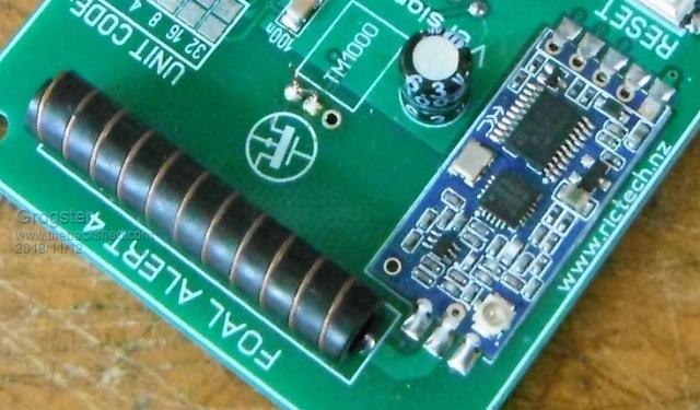

I mention it, as something like a bit of wire on the antenna connector is NOT a good frequency match, as your RF meter would be. Use frequency matched antennas, helical coils, or wavelength matched lengths of wire for the best results.
Generally speaking, I have found the HC12 module to be very reliable indeed, and will run on the smell of an oily rag(read: gives a very good performance) with on-frequency antennas.
The ones that are off frequency are instantly suspect for other issues not yet identified - such as doing odd thing if not correctly matched, or just general impedance matching issues - who knows. When the clones are used with the genuine item, the network becomes as deaf as a post, so there would be major receive sensitivity issues in a mixed-module network. Avoid like the plague, if you value your sanity. Are you using the off-frequency 'Clone' modules here, or have you now sourced some of the authentic HC12 modules? Do NOT mix-and-match clones with genuine ones - but I get the idea from your post above, that you are aware of that. I just want to hammer it home if there was any doubt.

I have never had any issues at all with the genuine ones failing to communicate.
The clones USUALLY work OK, so long as ALL of them are the same clones.
Mix and match them, and you are going to have a hell of a time due to a roughly 37kHz frequency error on the clones - making them deaf as a post to the genuine transmissions.
Yes, the clones are very good. Visually, they look identical, so there is not much you can use to tell them apart from the genuine ones. The clones tend to have a thinner 'white-wash' looking silkscreen, whearas the genuine ones use a thicker, whiter silkscreen. Other then that, the look the same.
Did you look at the thread we had here about this whole issue?
It went on for several pages....
Basically, the only way to be really sure, is with a frequency counter, scanner radio or spectrum analyser. That, or know you have sourced them direct from the manufacturer, and don't get them via eBay or AliExpress as they could well be clones.
EDIT: If you have a read through that thread(see page 6 for a scope image of the clone crystal vs genuine one), you will see that the clones seem to use sub-standard crystals. Apart from having a bad frequency error, they only offer about half the amplitude of the genuine ones. Both of those factors add up to very unreliable modules, and must be avoided at all costs if you value your sanity when using HC12's.

I have always got the expected range out of the modules. Actually, MORE then the expected range, so they must be outputting the power they say. Last time I put them on the spectrum analyser, I was just wanting to look at the harmonics more then anything else, as I expected them to be noisy - for the price, something has to give, and usually it is the output filtering.
But they were surprisingly clean - I was rather shocked by that, as I expected them to be spectrally horrible. I mean, they cost three bucks each from eBay! Because those tests revealed how clean they were, I have now started using them for pretty much everything.
I will see if I can find the time to set one up on the analyser again, and measure it's output power, but with the range I get from them, I fully expect the output to be what they say it is. The RF chip is a 100mW transceiver, so.....
HOW exactly are you mounting your HC12's to the PCB with the antennas?
You seem to know your RF, so I don't expect you have done anything silly here, but I have to ask.
This is how I currently mount my HC12's, and they work very well. Note that I am also using antenna PCB track of 2mm which is a frequency match for around 433MHz. If your antenna is mounted externally via the UFL socket, then you really shouldn't be having any matching problems at all.

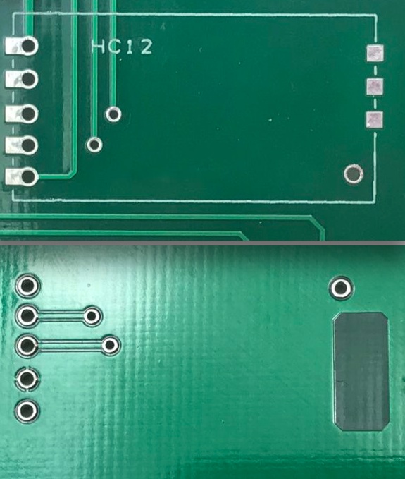

[/quote]
I've updated the info at http://support.rossw.net/hc12/, but very similar to yours.
On the reverse, I removed copper to ensure it wasn't acting as a capacitor shunting signal to ground:
[quote]
Yeah, that's what I figure too. And I've done a DC continuity test from the ant pin on the HC12 to the other end of the cable where it plugs into the SA incase any cable or connector was damaged - and I have DC continuity, and no short from centre pin to braid, so I'm puzzled.Edited by RossW 2018-11-13

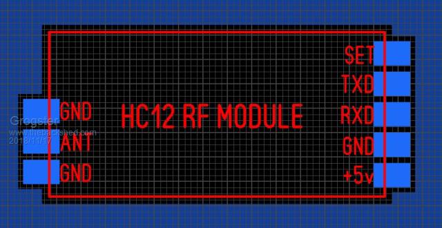

Ross - the only thing I can think that is different to how I am mounting the HC12, is that I totally get rid of any ground-plane around the module on my PCB footprint:
I always try to avoid running any tracks anywhere under this footprint, either on the top or the bottom copper. You use much more copper GP on your footprint, but I really don't see how that could lead to such a drastic drop-off in output power, but perhaps the GP on the HC12 and the GP under the module on the PCB footprint are acting as some kind of ground-coupling capacitor at RF frequencies.
The fact that you get the expected output power with the module OFF the PCB seems to point to some issue with the PCB, if the power drops off when you put it back on the PCB.
EDIT: I assume you have actually set the HC12 to run 100mW output power? I think they come from factory like that anyway, but you CAN change the output power via AT commands in setup mode. I expect you probably know that, but I have to ask to be sure that isn't the issue with your power output problem.Edited by Grogster 2018-11-18
