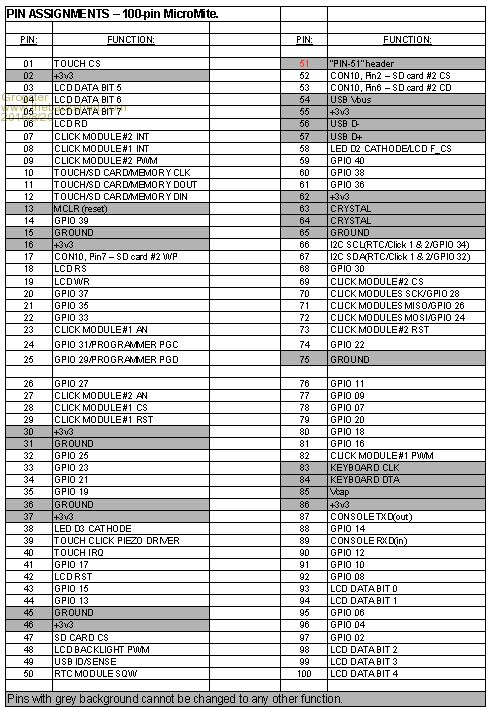

Here is a PDF of the E100 pin-assignments:
PDF: E100 Pin-Assignments, PCB Version 1B (August 2016)
This might help those who are playing with the E100 before it is even published in SC magazine. Edited by Grogster 2016-08-21

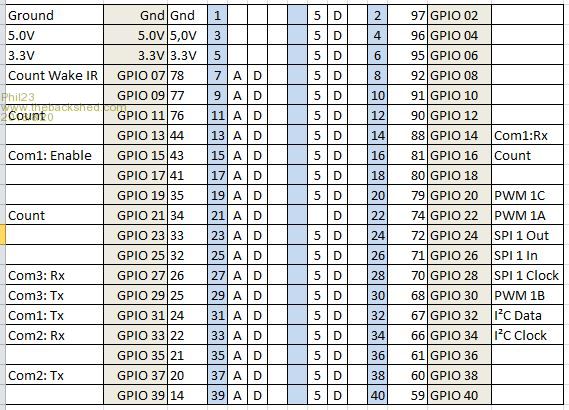

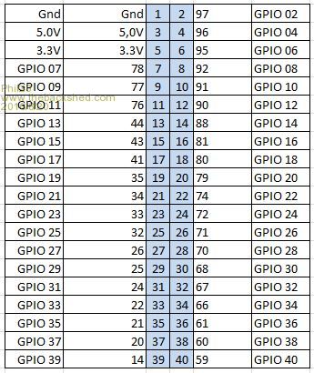

Here's one of Con8.
Please double check before using it.
Might try & add pin functions later.
Phil.
Edit:-
Another with some descriptions.

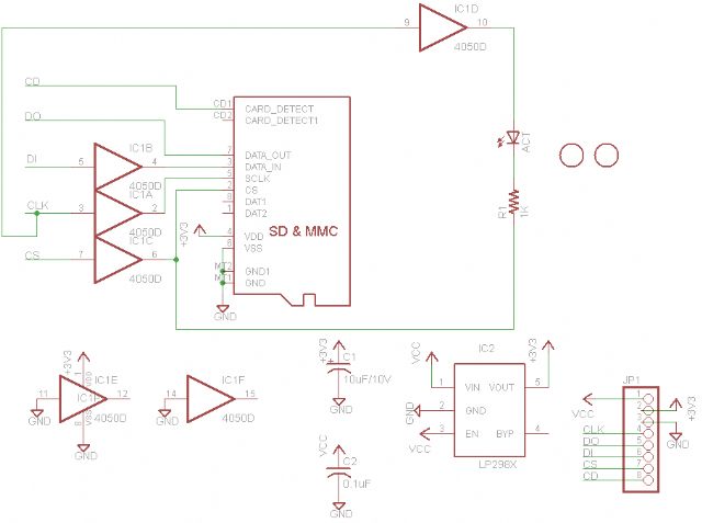

@Grogster
You nearly got the pinout right (CON10)
Has Card Detect AND an activity LED. (Neat way of connecting the LED too).
Schematic available on website.
SD card breakout board (with CD) Edited by mikeb 2016-08-21

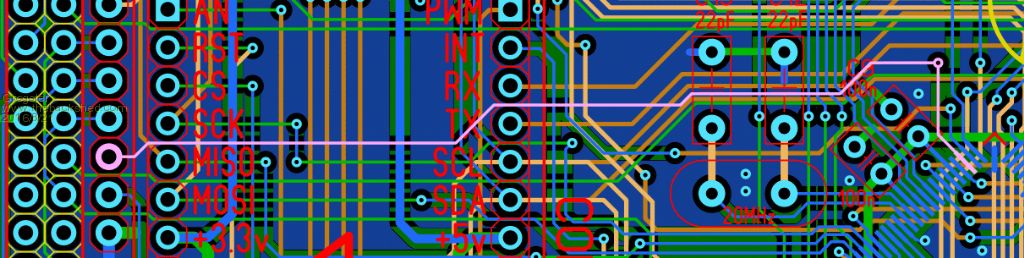

Hi Mike.
Pin-53 is SD #2 CD ONLY:
You are probably thinking of Pin-58, which is F_CS and LED D2 cathode - D2 will light whenever F_CS is pulled low. If there is an SPI flash memory chip fitted to the footprint on the LCD module, D2 will blink whenever you access this memory chip.
In hindsight, it would have been a nice idea to have SD card activity LED's.
This may well be something to add for a 1C version of the board.

@Grogster
I was referring to the LED on the breakout board. Sorry to be unclear.
Re-reading my post I can see how you made the assumption of reference to your board.
I remember a thread, recently, where a user wanted to see card activity.

OH, I SEE!!!!!
Whoops......
Yes, I thought you were referring to an error on CON10 - which could have been the case, but I could not find one, so I put up the image showing the trace.

@Grogster
Nah.....Your board is all good. Sorry you wasted your time. I finally came across a 'breakout' board that actually included the 'card detect' signal (I think it is a critical signal just quietly). Funnily enough it had an 8 pin header on board but the pinout didn't line up with CON10. Just taking the p!5s.
Maybe Ver 1C could include a connector for this board. Although, from what I've seen on the forum so far, many users will 'freak out' at the price. Me personally I'm a big believer in that 'You get what you pay for'. I'm always amused when people say they got something, on eBay, for next to nothing (with free shipping) and are then 'putout' cos it turns out to be dodgy.

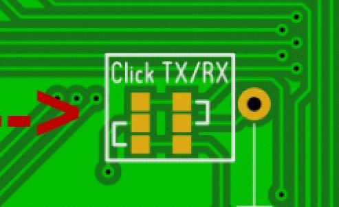

Quick question as I skimmed through this thread and couldn't see the answer
Can anyone tell me what the 6 pcb squares marked click TX/RX means and how to use these?
I presume they are solder points for jumpers for something?

Thanks Palcal, I know what the click boards are, it's the 6 solder "squares" on the Explore 100, what they are for and how to use them I would like info aboutEdited by lew247 2016-10-25

Geoff mentions these in October's Silicon Chip.
They allow you to reverse the TX & RX pins on the Click board sockets.
Both sockets use Com3, pins 25 & 26.
The brackets show which pads to bridge to have them in the normal configuration.
Cheers.
Edit:-
I overlooked them when I built my E100's, so I guess they won't work yet.
I also found some 3x7cm proto boards on eBay that are ideal for connecting a few components to the sockets.Edited by Phil23 2016-10-25
