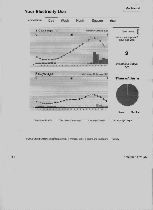

My energy supplier makes hourly blocks available via the internet.
Wednesday was pretty typical, but Thursday was serious airconditioner weather, and after the sun set my grid consumption soared to just over 1Kw, so I could get a decent sleep.
The upper curve with the blobs is the average household consumption in my suburb.
You can see during daylight my grid consumption drops to zero 7am to 7pm, and at night there is not usually much running, only the refrigerator.

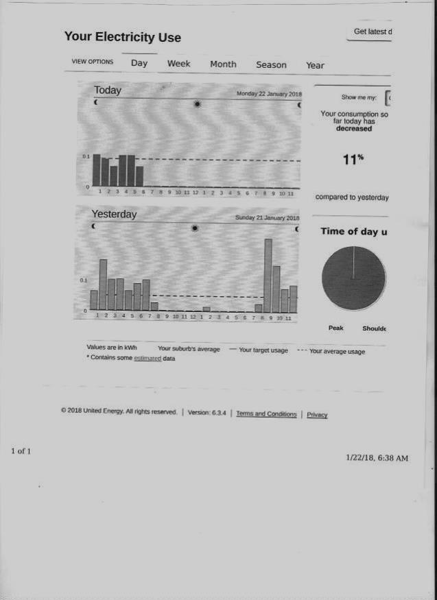

And being retired I am home all day. Here are the numbers from my smart meter right up to this very minute. About 100 watts at night typical, and almost nothing during the day. If its cloudy sometimes just a tiny bit during the day like yesterday.
At this time of year its about 50 watts average per day {1.2Kwh)
