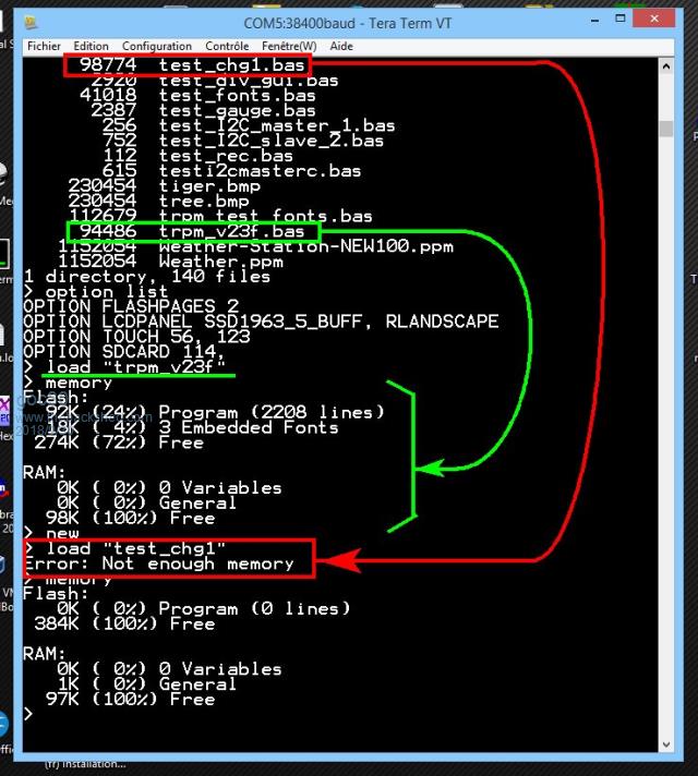

Before completing my problem, I wanted to check more precisely. I tested with other programs, always the same. then I tested with or without loading fonts: always the same.
I tested with version 3.7.0 and 3.7.3: always the same
the problem does not exist with a micromite+ that can load 1049 blocks (but with a message "not enough memory", which is normal)
here is an example of a program that cannot load completely and that bug all from block 767 (it is the "Weather station" exemple with 1 font loading)
2018-09-29_111427_test_chg1.zip Edited by goc30 2018-09-30

goc30,
How are you loading the file? Are you using 'load and run' or the file manager?
If you are loading it into memory, you can also do a 'LOAD' from the chat window. This uses AUTOSAVE instead of XMODEM.
I tried loading your program onto my armite and it got past the 767 block point OK

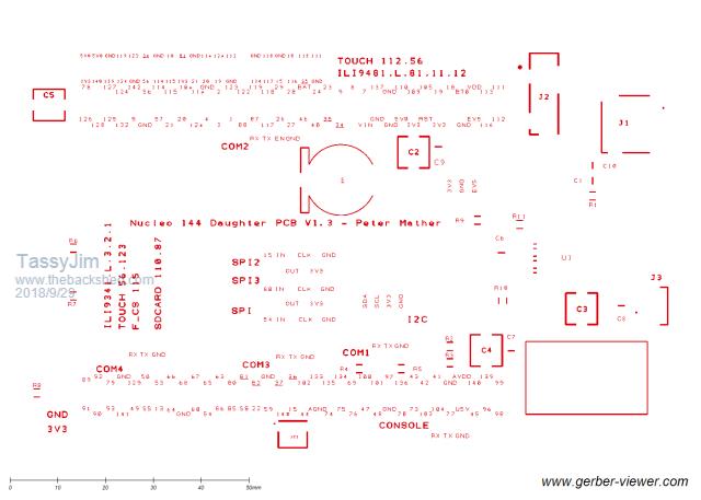

Can anyone tell me what pins are used for T_IRQ and T_CS on the v1.3 backpack boards?
They are listed as configurable in the manual, I assume they are set for the backpack boards?
Mike.
Posts: 6606
Posted: 02:52am 29 Sep 2018
My version 1.0 board has
OPTION TOUCH 56, 123
I expect the later boards are the same.
Edit: it will depend on the display you are using.
Edited by TassyJim 2018-09-30

  TassyJim said
Your code has HTML code in the cfunctions. That would really annoy the armite (and any other micromite)
programm is not important. I have same bug with my programme who has not Cfunction
As I said you, I can't load prog. If i delete downloads fonts, it load and after work correctly
I put here my screen save. You can see that the ultime block is "loaded" many times befor it stop
2018-09-29_183424_screen_mmedit.zip

Posted: 07:31pm 29 Sep 2018
  matherp said   Try setting OPTION FLASHPAGES to 2
it is one of the first things I have tested, and it is same
here you can see my teraterm screen
I begin to understand the problem
1 - ram memory free is 98k. That mean that you can't load file more than 98k byte long (have-you an other way to load??)
2 - option flash change only flash memory not ram
3 - when you write "98k" that mean 98 x 1024 byte (100352 bytes), but file 98774 bytes can't be loaded, why?? Edited by goc30 2018-10-01

Posts: 6606
Posted: 07:07am 30 Sep 2018
@goc30
I see that you are using
OPTION LCDPANEL
SSD1963_5_BUFF
That is where your memory has gone to.
  Quote  Selects 16-bit bus operation of the 5” and 7” SSD1963 displays
using a memory framebuffer for improved performance. This
uses 400K of memory leaving 98K for user programs
Without the video buffer
> LOAD "temp.bas"
Error: Not enough memory for Cfunction
> option flashpages 2
> LOAD "temp.bas"
> memory
Flash:
136K (35%) Program (3992 lines)
248K (65%) Free
RAM:
0K ( 0%) 0 Variables
0K ( 0%) General
498K (100%) Free
Plenty of flash and RAM available and a large program loaded without any problems.
Posts: 11881
Posted: 07:40am 30 Sep 2018
  Quote  I begin to understand the problem
As Jim says the issue is the driver you are using. Unless you specifically need the buffered driver use SSD1963_n_16
If you really need this driver then disable it, load the program and then re-enable it. That way all the RAM will be available for program load.
The code reserves some RAM for housekeeeping so you can never use all the RAM available during program load
