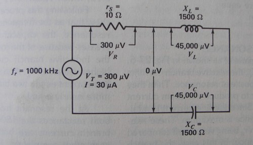

[quote]What happens to the AC voltage across the capacitor at resonance? [/quote]
Well, it gets kinda high, in fact. Multiply the impedance and current through any specific capacitor for the voltage drop across it. Since the impedance of the capacitor increases, but the current goes down, it's anybody's guess whether the voltage goes up, down, or stays the same once resonant frequency has been exceeded.

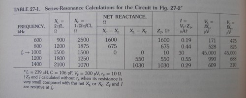

Gordon,
To put some perspective on cap voltage at resonance.
reference circuit.
values at Fq.
text excerpt.
Cheers Gill _Cairns, FNQ

Posted: 06:46am 01 Oct 2008
Hi Steven
The units are synchronous slip only occurs in induction motors we are not driving a mechanical load. Motors that have magnetic poles such as these are used and called synchronous motors these have no slip I was once commisioning a 1400hp unit that did slip the noise was unbelievable.
The answers to your input power will take some time as some need us to go deeper into generator theory. At this point time I do not have the time also I think we need another topic as I would like to get the basics cleared up before delving into Caps.
