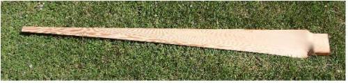

Hi kiwijohn,
The travelling mechanisms are like the way a lathe bed and the cross traveller work. I have not made any reference to rotation of the work, if this is what you are implying. I had looked at rotating the work, but decided this was too hard, and I was not too keen on making a roller stylus and the hardware to mechanise the rotation. I am not keen on unattended operation. The linear design is good enough.
Hi phill,
Yes, this is a finished blade. I am presently reinforcing the trailing edge with carbon. This is <1mm thick, so the wood by itself, may be prone to chipping. I am using low viscosity 2pak for sealer.
The jigging system will simplify things, so all blades should end up close in weight and profiles. I will be removing gross excess timber with a table saw on future blades.
I will be using helicopter leading edge tape [polyurethane sticky tape] on the outer section of the blades, to reduce erosion. I have this on my older mill, and have no signs of wear after 2 years.
Gordon.Edited by GWatPE 2008-12-30

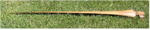

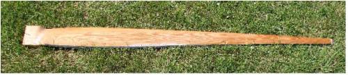

Here are some pics of a blade so far.
This blade has a carbon fibre reinforsement,[just visible in pic 2] along the trailing edge.
The blade has a high aspect, with a thin section. There is ample thickness at the root end for strength and mounting. I was able to maintain the airfoil section all the way to the tip.
These blades are still a work in progress, so I will make one set and test, and then adjust if needed. This is the benefit of making templates, and not just copying from an existing blade.
Gordon.

Posted: 11:43am 29 Dec 2008
Hi windman,
the templates allow me to cut the wood very precisely. There is no deflection in the template, so I can hold the stylus on the template with a lot of force, and this allows the carbide tool to replicate to a high accuracy.
I have made 2 blades and have decided to first cut only one side of a blade set, and then change the template and repeat for the other side of the set. This will allow me to keep the stylus setting constant and this will improve the precision of the cutting.
There was a bit of a difference in the weights of the first 2 blades. I would like to be able to replicate to within about 10g difference in weight.
I am surprised at how the blades look. If they work as well as they look, then they will be great. I have reinforced the thinnest section with carbon, and will probably continue to do so with all blades. The sealing will take some time. I am thinning the 2pak and this is soaking in well. The wood finish looks good, but I will spray finish after testing.
I hope to test fly the first set in a few days.
Gordon.

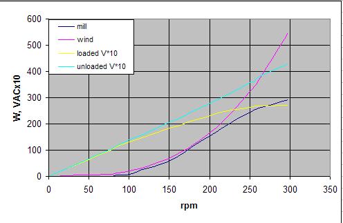

I remember you asking for some loading and rpm figs from my setup with a doubler. The wind is not so good, so the test rig will have to do.
I have set up my test with a cap doubler from my windmill. This was one with 330uF 450VDC back to back caps, as in a photo I posted a while ago. I have tested with a single phase. This gives 1/3 of total output, so I have multiplied the currents by 3 and by the battery voltage to give effective power output. This test was with a doubler and normal rectifier connected to a series80 7s2p. This is very close in specs to the 100S.
the battery voltage was 27.8V.
I have included on the graph, curves for cubic wind energy, calculated alternator output power, loaded AC voltage and unloaded AC voltage without doubler.
There are several aspects to consider. Without the doubler, there would be no output below 145rpm. With the doubler, there is power output that follows the wind energy curve quite well from approx 75rpm. This is at power levels from 1-2 to 40-50W. The exact benefit is difficult to calculate, as the mill spins faster without the doubler, but this produces little power, until the rotor is loaded, and the tsr is brought back to optimum.
There are many tests that can be done, but this test demonstrates a lower cut in with 300W achievable at 300rpm. The series80 are common, and this rewire is just as good as the series100. I doubt that any of this would be of benefit on a stator that was not decogged. My stator has the poles twisted a measured 10 degrees.
There are no switches or relays, or sensors or microprocessors. The additional top end power matching reigime of my windmill requires full AC coupling of the windmill to the loadings. I am not recommending this at present as sourcing caps seems to be a problem. I have not been able to achieve full power range alternator loading to the wind energy with a single stator and single loading, with series caps, or a doubler. The low power levels are accomodated very well though with just the doubler.
Additional complexity of mill head components, with split windings etc would probably require rectifiers and caps on the mill head.
Gordon.Edited by GWatPE 2009-01-13
