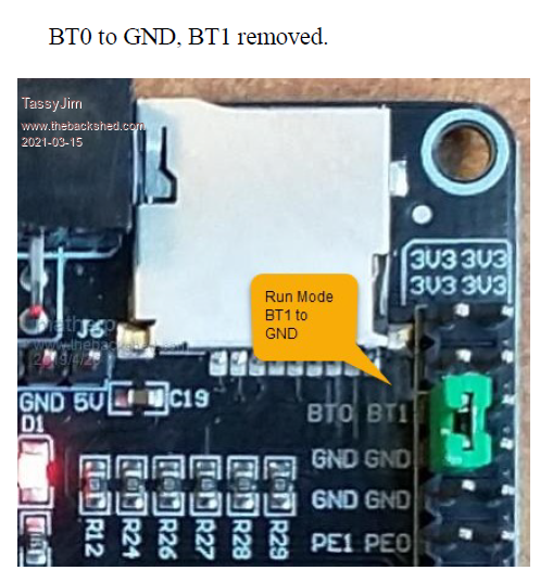

I went through my small collection of F407 boards.
The ones with STM32F4VE and Ver: 2.1 on the back work as expected with one jumper required for flashing and all jumpers removed for normal use.
I do have one board that has STM32F4XX and V2.0 on the back.
It does definitely have a STM32F407VET6 processor.
On that board, I have to have the two jumpers in place for flashing and the BT0 to ground jumper in place for normal use.
In other words, that board does NOT have the pulldown resistors shown in the circuit diagram and mentioned in the manual.
If you are having trouble getting the serial to work once flashed, try with a jumper from BT0 to GND
I don't have any jumper on BT1

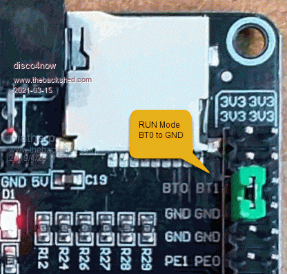

The text on the photo (taken from the manual) is incorrect. It should read BT0 to Ground

Posted: 10:59am 15 Mar 2021
Fixed next release.

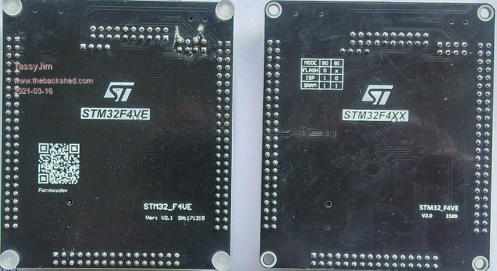

Posts: 6604
Posted: 08:43pm 15 Mar 2021
  lizby said
There must be some variation. My V2.0 boards run with no jumpers at all (flash as per normal).
I checked my V2.0 board and it does have R7 and R8. I will do some measurements when time permits. Perhaps the value is wrong or just marginal. Either way, the board I have definitely needs the grounding jumpers in place for correct operation.
The boards I have were all purchased 18 months ago.

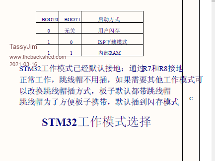

Posts: 6604
Posted: 12:17am 16 Mar 2021
This is the rear of my two versions.
The V2 board one requires the jumpers in place for firmware programming and also normal running.
I measured the resistors and that ARE in place and the correct values. Something makes the jumper to ground required on that board.
Note that the jumper settings on the silk screen differ from the jumper settings in the circuit diagram supplied here.
I believe that the circuit diagram supplied here is wrong.
I have a Chinese version of the circuit:
I have some more units on order. It will be interesting to see what revision board they use.
If your V2.3 board doesn't work with the jumpers set as per the images in the manual, I don't know what else to suggest.
Having the jumpers on will not cause any problems on the 'good' boards.
While BT1 shouldn't need a jumper for normal running, I would try both positions.

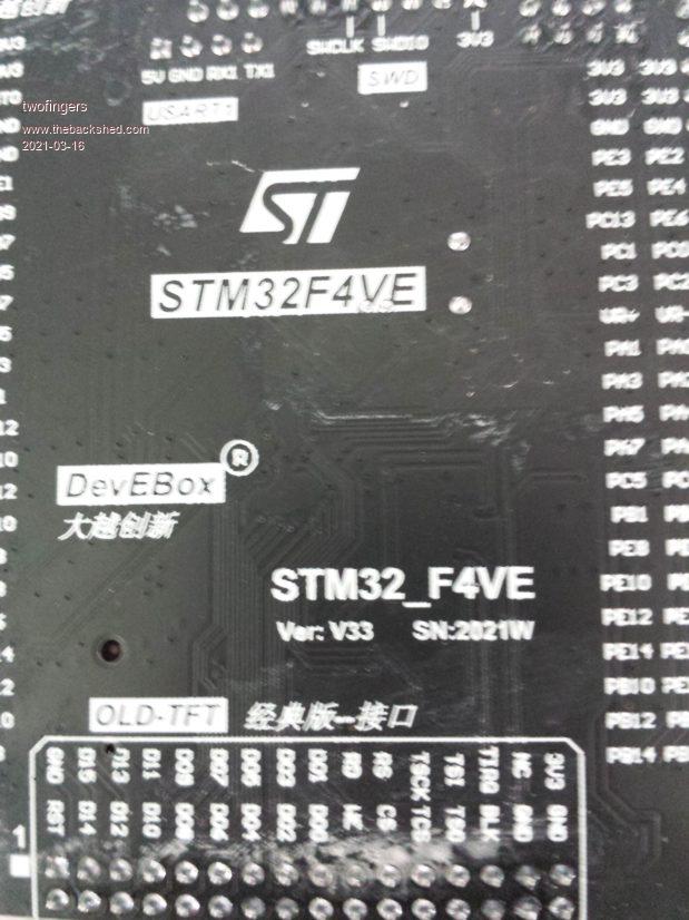

Posts: 3380
Posted: 03:24am 16 Mar 2021
Re SD Card issues.

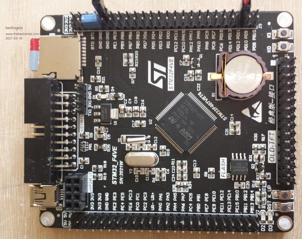

My board (STM32_F4VE Ver: V33  SN: 1911Z) reads some cards and not others. Even for cards it can read odd things happen. Eg the FILES command lists up to "Press any key to continue" then locks up, but only when OPTION LCDPANEL CONSOLE enabled.
TassyJim's photo a few posts up shows 6 10k pullups connected to the SD card socket. R12, 24, 26, 27, 28, 29.
My board doesn't have them, nor pads to fit them, relying on weak pullups in the chip. I think that could result in slow rise times and/or crosstalk between PCB tracks.
I will order some SMD resistors an try fitting them directly to the SD socket pads.
If anyone with SD problems and resistors on hand could also try it and let us know what happens.
Pins 1, 2, 3, 5, 7, 8 use pullups.
EDIT
Salvaged an 8.2k X 8 SIL package from a dead motherboard and connected it to the SD socket and +3.3V and now all SD cards work error free.
The schematic PDF for the board shows pullups all over the place that my board does not have. If any one has issues with any hardware compare your board to the schematic, it could save a lot of head scratching. Cost cutting gone too far I think.
Edited 2021-03-16 17:01 by phil99

  phil99 said  Re SD Card issues.
Thanks Phil, good to know. Same issues here (with V33) ...

The SSDcard must have pullups on the 4 data lines but not on the clock and doesn't matter on the CMD pin. The ST recommendation for pullups is 47K
twofingers. Please could you try the attached on your board as-is and let me know if any different
ArmmiteF407.zip

I tested 6 SD cards:
Not working (Files: Error : SD Card not found)
1 GB FAT32
2 GB FAT32 (* was responding once, then: SD card not found)
8 GB FAT32
Working (at a first glance)
2  GB FAT
32 GB FAT32 (Sundisk Ultra)
32 GB exFAT (Samsung EVO)
BTW.

Posts: 3380
Posted: 11:42pm 16 Mar 2021
SD card update.
As pullups should only be required on the 4 data pins I disconnected them from CMD and CLOCK. Reading SD cards became unreliable again. Reconnecting CMD fixed it. On my board I need pullups on pins 1,2,3,7,8 but not 5 (CLK).

  matherp said  Please could you try the attached on your board as-is and let me know if any different
ArmmiteF407.zip
I have two of the V33 boards with no pullups.
I loaded this version into 1 and files command works on about the 5th go and then seems to keep working. Remove and replace the 16M SDCARD and it needs a few repeats of the command to get it going again. The other one with older software does not see SDCARD at all, so maybe its doing something?
Are SDIO-1,2,3 used, if not could they have internal pullups so you would only need to add two resistors?

Posts: 6604
Posted: 06:53am 17 Mar 2021
I couldn't find a circuit diagram for the V33 boards but I found this reference to another difference:
  Quote  Important:
Since in this case the STM32 acts as a USB host (in HID mode), the pull-up resistor R21 (1.5K) must be unsoldered on the STM32F407VET6 blackboard labeled "V2.0". Otherwise the USB keyboard will not be recognized.
In the meantime there are also black boards with the identifier "V33" on the back. The resistance circled in the photo is no longer there. There is still a resistor R21 elsewhere, but it has a different function. In this case, therefore, no intervention is necessary.
Unsoldering is not at all tragic, since the external resistor is superfluous in the STM32F4XX family even when used as a USB device (and not USB host). In the case of operation as a USB device (and not as a host), the internal pull-up of the STM32F4XX provided for this is automatically used.
We are only using the USB as a slave so may not be an issue but the lack of the D+ pullup should be noted.
The V33 is a very different beast. Provided it is only a few pullups missing (and they have pins on the IO), it is not a show-stopper. Putting the pullups at the socket is the correct place but I would try the easy way out first and try the IO pins instead.
Edited 2021-03-17 16:55 by TassyJim
Posts: 11867
Posted: 08:13am 17 Mar 2021
One more minor tweak for the SDcard. Please report impact (or not)
ArmmiteF407.zip

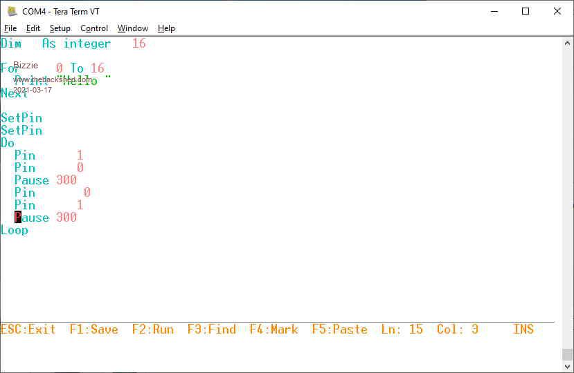

Bizzie
Joined: 06/07/2014
Posts: 194
Posted: 09:49am 17 Mar 2021
Hi All,
I took delivery of an F4 (STM32_F4VE) today Ver: V33 SN:2021W, loaded it with the bin above put a Transcend micro 2GB card in and files worked straight off. I do not have any other cards to try at this stage.
A problem with the editor in colour mode though. See below
I am using Tera Term so assume all should be OK.
