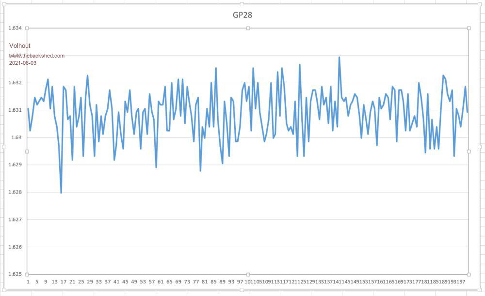

Posted: 10:39am 03 Jun 2021
Thanks Peter,
That worked. Using a14. All 3 channels are independent now.

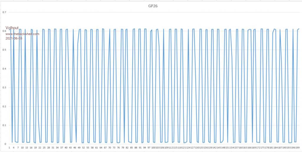

The ADC is not bad. Midrange noise level is +/- 2.5mV. That is 5mV/1600mV = 1:320 => 8.4 effective bit. At full speed. And no special precautions like low pass filters.
When sampling a single channel in a for-next loop the 80us conversion time is not met. That is proven when a 0.6V 2kHz signal is measured. It is closer to 100us.
I will see if I can improve the effective bit a bit more with HW means.
Edited 2021-06-03 20:40 by Volhout

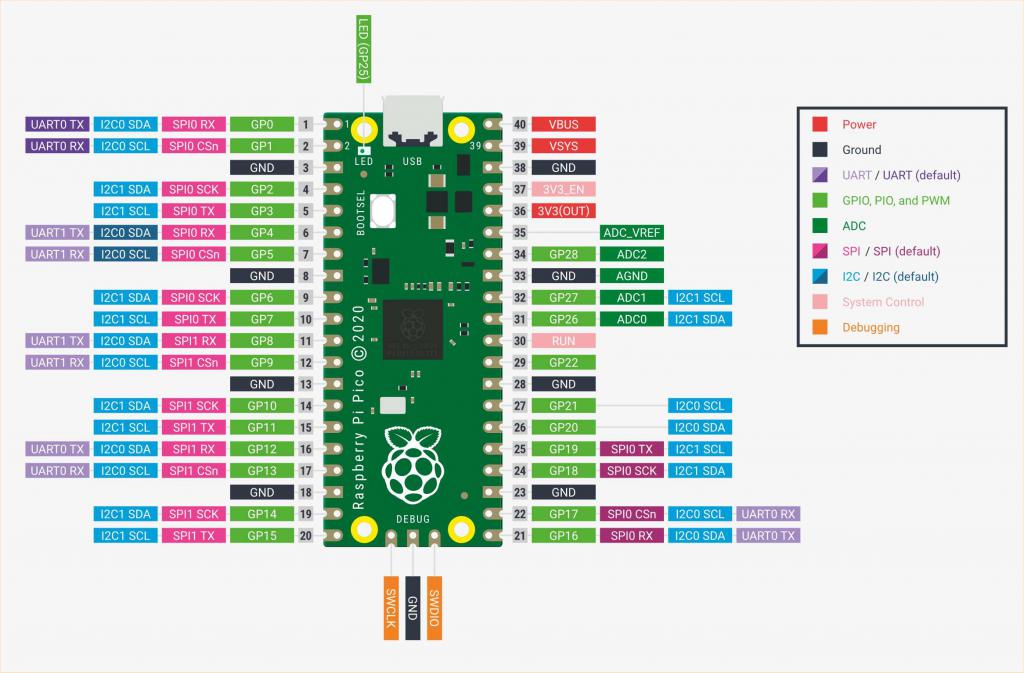

Posts: 11873
Posted: 03:10pm 03 Jun 2021
Proposal
The Picomite has more flexibility over which pins are used for what compared to the STM32 or PIC32. In order to make use of this I propose as follows:
Special functions will not be directly assigned to pins, instead SETPIN will be used to associate a particular function with a pin
e.g.
SETPIN I2C0 p1, p2
SETPIN PWM1A p1
SETPIN SPI0 p1,p2,p3
This will mean that the use of setpin is mandatory before using things like I2C OPEN
Overall the flexibility is as follows:
Up to 16 PWM with up to 8 different frequencies allocatable to any pin
1, or 2 I2C allocatable as per pic
1, or 2 SPI allocatable as per pic
1, or 2 UART allocatable as per pic
4 Count pins allocatable to any pin (could be more than 4 if there is a requirement?)
1 IR pin allocatable to any pin
PIO functions to be allocated to a pin in the same sort of way - mechanism TBD
I don't know at the moment if I2C etc. have to be allocated in the logical groups on the chart - will see when testing.
Thoughts?

Posts: 6116
Posted: 05:54pm 03 Jun 2021
@matherp
The flexibility on some is overwhelming. Is this the pin mux that is that flexible, or are they using the PIO sequencers for the peripherals.
In the first case (pinmux) I would default pins, but leave the flexibility to change. In my experience (*) many will use the defaults anyway.
If the latter is the case (PIO sequencers), can we check if they use both groups of sequencers (2x4=8 sequencers). I would prefer if we decide on a subset of variations that leaves a one sequencer free for experiments.
(*) I once bougth an RC transmitter that had total freedom to choose what channel you would use for what function. And what happened... I used the default that all normal RC transmitters use. And still do, after all these years. Keeping to the standard makes life easier. You know by instinct where to look for what signal, without diving deep into the configuration.
Posts: 11873
Posted: 06:01pm 03 Jun 2021
The "standard" I/O functions are completely separate from the two PIO groups which are just another "special function"
