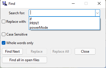

I have updated the MMEdit5 files on my website (except RPi)
I will get my RPi sorted out again soon..
There are a few small tweaks including one for Brian:
Find searches are now remembered between sessions.
I am having trouble getting baud rates higher than 115200 on Linux. I know it can be done but I still have more work to do.

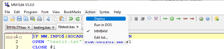

Kabron
Joined: 30/11/2017
Posts: 65
Posted: 06:14am 22 Apr 2022
Hi there,
with the fresh version 2022/04/19
I do not see MMB4W option in Action menu.
Sorry, solved
Edited 2022-04-22 16:17 by Kabron
Posts: 6603
Posted: 06:17am 22 Apr 2022
  Kabron said  Hi there,
You have to add it.
MMEdit has no idea where you put the exe.
Kabron
Joined: 30/11/2017
Posts: 65
Posted: 06:20am 22 Apr 2022
I have to launch mmb4w via cmd file, containing mmbasic.exe 0.
How in this case to pass file argument to mmb4w?
Solved:
mmbasicw.exe 0 %1
Edited 2022-04-22 16:28 by Kabron

Posted: 11:36am 27 Apr 2022
Hi Jim
Remembering the file searches in Find is great, but out of interest, how do you clear the list?
Brian
