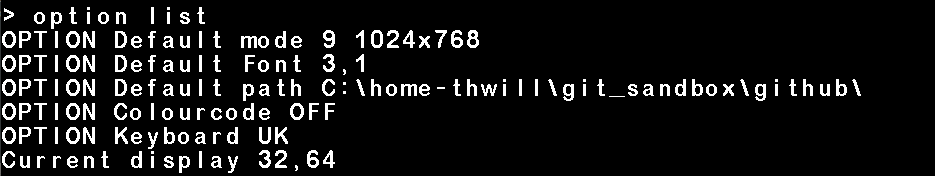

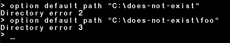

Posts: 4398
Posted: 09:59am 22 Feb 2022
Here we go then:
1. LS as an alias of FILES is not supported, is this intentional? I don't object since it was an anacronysm on the CMM2. I might even remove it from MMB4L since I'm intending to allow access to all the Linux console commands simply by prefixing them with a !
2. It's a damn nuisance when it comes to bug reporting that I can't copy from the MMB4W console.
3. OPTION DEFAULT PATH error handling would benefit from improvement:
4. OPTION LIST uses an exciting mixture of cases :
5. Are you going to provide compatibility with the CSUB structure being (mis)used to include binary blobs in MMBasic files? If not then is there an alternative other than DATA statements ... I seem to recall something about misusing fonts ?
6. MM.CMDLINE$ is not supported !!!
That's me out again .
Edited 2022-02-22 20:08 by thwill

Posts: 11854
Posted: 10:26am 22 Feb 2022
  Quote  LS as an alias of FILES is not supported, is this intentional?
Yes. I don't currently intend to include the CMM2 "FILES" command as it seems unnecessary on an operating based system but I'm open to thoughts
  Quote  OPTION DEFAULT PATH error handling would benefit from improvement:
Done
  Quote  Are you going to provide compatibility with the CSUB structure being (mis)used to include binary blobs in MMBasic files? If not then is there another option other than DATA files ... I seem to recall something about misusing fonts ?
Given no significant limitation on program memory I think using DATA/READ is the correct "Basic" approach so don't intend to include CSUB. You can't use a font because I'm not allowing peek/poke access other than to HEAP, VARIABLES and PROGRAM space. You can use LOAD DATA to load a data file direct into an array
  Quote  MM.CMDLINE$ is not supported !!!
I'll look at it
  Quote  Could you (temporarily?) provide a flag/option to duplicate all console *output* into the "DOS Window" so I can copy error messages out of there ?
I'll set all errors to duplicate on the console window permanently - no downside I can see
Edited 2022-02-22 20:31 by matherp
