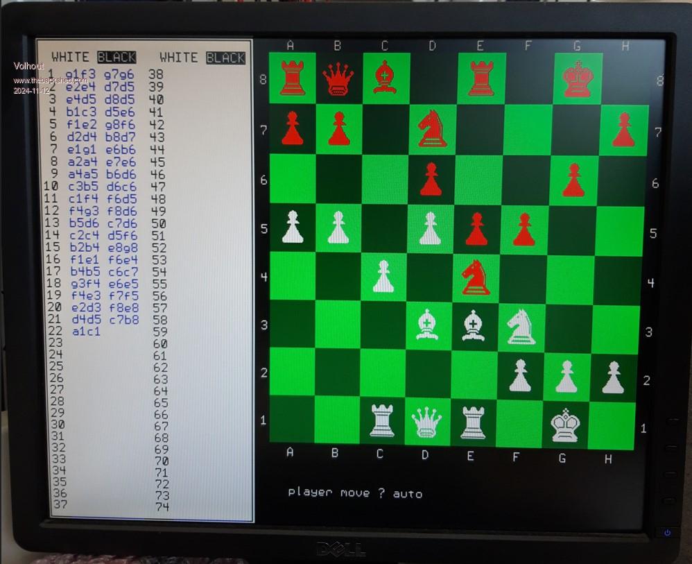

Posts: 6195
Posted: 09:40am 12 Nov 2024
Kevin,
Finally picked up the dual pico chess project again.
It is far from finished, but can play a decent match already. Runs in 640x480 on the PRP2040 VGA.
The second pico runs Peters compiled TSCP (2 posts back). Its useds UART at GP0/GP1, and is wired to the UART on the first pico at GP4/GP5. Since this TSCP pico is very sensitive to typing errors I pre-process every command in the first pico.
In auto mode it plays itself.
Edited 2024-11-12 19:45 by Volhout

Posts: 6195
Posted: 06:48am 13 Nov 2024
Peter,
The earlier code does not echo.
When I get home this weekend I will have access to a pico2 again. I will try it.
500 MHz…?
But honestly, the earlier version was pretty fast already, a 70 move game lasted 2 minutes, that is 1,7 seconds per 2 moves (black and white). I may have trouble keeping up with displaying the board, which is quite clumsy currently, because the sprites are smaller than shown.
