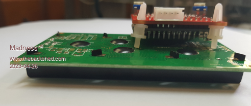

In case anyone else was looking for Poida's serial LCD conversion using a nano - here's the link:-
https://www.thebackshed.com/forum/ViewTopic.php?TID=13650&PID=194228#194228#194228
rather handy as i have a few old LCDs to reuse; two 20x4 and two 40x2 which you don't see too often.

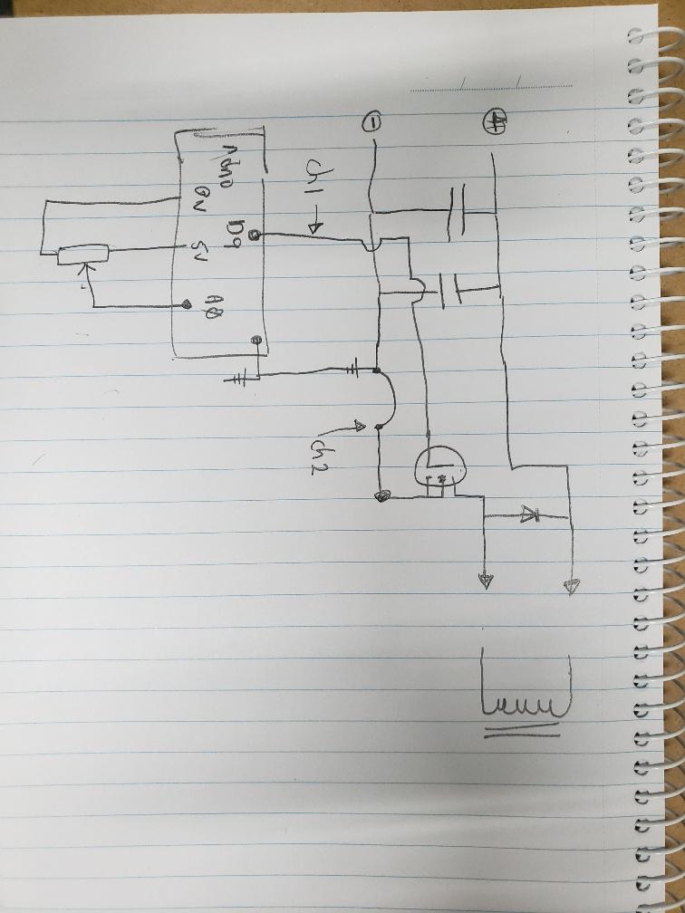

  Cobbler said  .. I have a pretty capable power supply that can handle up to 14A at 50V and all I need is a few large caps, a LEM and a HY4008 to get started.
Any FET will do, choose low voltage, for lowest Rds(on)
There must be something lying around.
A lot of FETs will nearly fully conduct from the 5V driven by the nano.
Maybe you have a dead UPS. Inside will be some 50V FETs with a good low
ON resistance.
And you can do it without a current sensor too.
I got very useful results, that let me finalise the inverter choke
I used for the house inverter by using a single strand of about 1mm
copper wire as a current sense. It was about 30mm long.
You first determine the resistance (put 10 Amps through it and see the voltage)
and then use 1x gain on the probe, turn up the vertical gain on the DSO
and it works.
Put the wire on the ground connected lead that goes to the inductor.
All probe connections must use the same ground point
Edited 2023-04-06 08:32 by poida

  poida said  A lot of FETs will nearly fully conduct from the 5V driven by the nano.
I have a few IRFB3006 which will hopefully work well enough driven by the nano.
Thank you for the sketch and wire shunt suggestion. I will start experimenting as soon as I get a chance.
Cheers Michael

here is the "serial LCD" I refer to
https://www.thebackshed.com/forum/ViewTopic.php?TID=13650&P=9#194228
Easy to build and so useful for my experiments and builds.

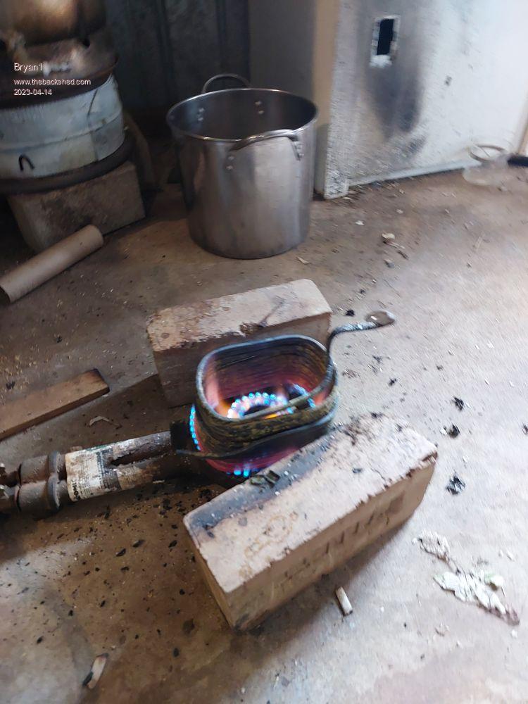

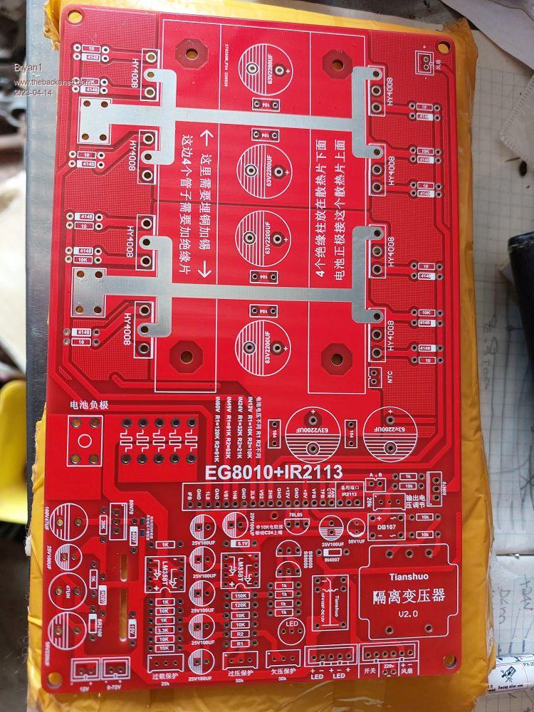

Mike came for a drive up this morning to get that tape and connectors and kindly brought up an aerosharp for me to play with
We talked about that 6.5X4mm(not 5 Mike) is 26 mm squared so it should be good for my first inverter. Now this wire came out of that E-core and in order to use it I had to anneal the wire first using my 2 ring crab burner and using a HP reg to get the right flame and left it heating for about 2 hours turning the core so all sides had a chance to get that red colour which what we want.
We did work out for that 15 turns we talked about for 24 volts I'll need over 5 metres to get the turns. I found atleast 5 metres of heatshrink to insulate the copper wire so the primary will be a few colours
Now as I have a heap of fets I reckon it reckon I'll be doing everything I can not to join that blown fets club
I do have this board
I do think I have seen this type of board used before and the best part I reckon I have all the components here to make it and any help will be nice as no info came with this board.
Cheers Bryan
Cheers Bryan

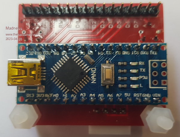

Sum of the Arduino Nano clones are just rubbish
I just loaded up a nano clone with the MPPT code and plugged it into the brain board
and was greeted with a LCD of random characters & symbols .
So i loaded up a simple little " hello world " program using the standard serial libraries and still junk.
So after lots of fluffing around the cro came out and the serial timing was up the sh**t
it was around that time that i realized the CPU had no markings and the 16mhz xtal was missing from the nano.
it turns out the chip was running at 5.3 MHZ
so if i set the baud rate to 28800 i get a serial port that runs at 9600
i haven't bothered seeing what else is wrong with it.
so if all else fails throw away the nano and get another one

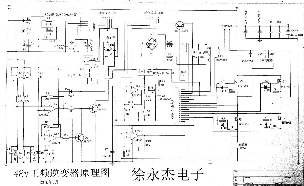

Bryan1:
here is a schematic of something close to what you have.
It will help you understand the various functions
(low voltage shut down, over DC voltage shutdown, the two
current limits etc)
That board you have uses the EG002 module to provide FET Gate drive
and so it is prone to out of spec. voltages appearing on the
IR2110 outputs. This can cause blowups.
You could build a minimal version of this, without all the
above functions. That is what I would do.
Just put the AC voltage feedback stuff in, a 5V supply,
a 12V supply. Put a socket where the EG002 module goes too.
Disable the over current stuff on the EG002.
This will be educational and be fine for low power tests.
5V supply to the EG002 will start the inverter.
No 5V will stop it.
If you want to do high power, I would want some TVS Diodes on the 4
Gate drive outputs, located close to the EG002 and mounted such that they prevent negative voltages reaching the EG002 outputs (1LO, 2LO, 1HO, 2HO)
The high outputs 1HO and 2HO are NOT referenced to DC ground. They are referenced
to respectively VS1 and VS2.

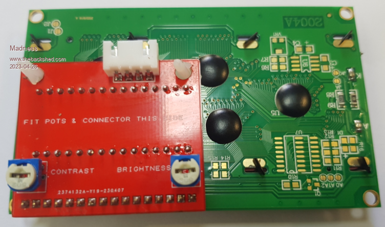

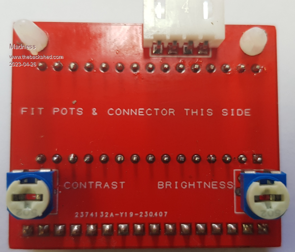

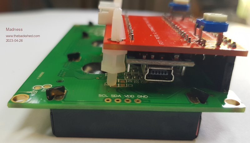

Some of you may find this useful, it works with the Nanoverter serial display. Poida might confirm if it is compatible with the Picoverter. It is much simpler to put together than just using wires and hot snot. It includes brightness and contrast adjustments and looks more pro too I think.
Madness Nanoverter LCD piggyback.zip
