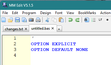

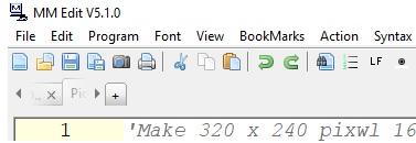

Posted: 07:08am 07 Jun 2023
G'day Jim,
I trust all is well? I've been distracted so this is an overdue question.
For the last two versions the tabs across the top (that normally show the file name) are very compressed in size. How can I widen them?
Cheers,
Andrew
Posts: 6603
Posted: 07:16am 07 Jun 2023
  Andrew_G said  G'day Jim,
Cheers,
Andrew
Can you post a screenshot?
The last few versions were compiled with an updated PureBasic and I think there were a few changes with high DPI handling.
My laptop runs at 150% and doesn't show any problems.
Andrew_G
Joined: 18/10/2016
Posts: 891
Posted: 07:19am 07 Jun 2023
Hi Jim,
That's service
How is this?

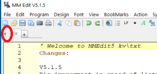

Posts: 6603
Posted: 07:34am 07 Jun 2023
It looks like the tab-bar has shifted off screen.
How many files do you have open?
What happens if you click on the small left arrow on the tab-bar?
If all else fails, send me a copy of MMEdit5.inf
Posts: 3378
Posted: 08:20am 07 Jun 2023
  Quote  What happens if you click on the small left arrow on the tab-bar?
Hi Jim, Very little.
I have 2 files open but it only expands a few mm.
Andrew_G
Joined: 18/10/2016
Posts: 891
Posted: 10:22am 07 Jun 2023
Phil,
Thanks - yes my screenshot above only had one file open and the tab is miniscule. Multiple files and the tabs stack on each other.
Jim,
I have a test match to win so no pressure . . .
Cheers,
Andrew

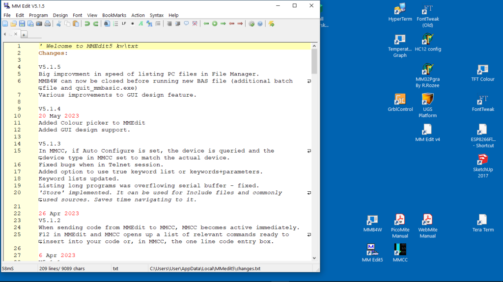

Posts: 6603
Posted: 09:28pm 07 Jun 2023
With a new (portable) installation I see no problems.
You should get the same by deleting the MMedit5.inf file to reset everything. Just doing an update keeps the old inf file.
But PLEASE, send me a copy of your existing MMedit5.inf file first so I have a chance of working out what is going on.
Posts: 3378
Posted: 10:14pm 07 Jun 2023
Yes, deleting the old .INF fixed it. I imagine it was carried over from V4.

Posts: 6603
Posted: 10:52pm 07 Jun 2023
Thanks Phil.
The V4 inf file is totally different and in a different location.
The main window coordinates don't look right ( shouldn't be negative):
; Main Window
MainX = -31995
MainY = -32000
MainW = 0
MainH = 20
But I have code to trap that.
It looks like The tab-bar uses the default Windows font and that got lost somehow.
I will try changing to a defined font to see if that is more robust. I can also set a minimum size.
I just don't know why it happens to you and Andrew.
Posts: 6603
Posted: 02:54am 08 Jun 2023
Phil and Andrew,
I think you both have been using multiple monitors.
My window recovery routine was not making the main window wide enough.
I think the attached will do things better.
The zip contains the MMEdit.exe which you replace in the program folder (with MMEdit shut down).
MMEdit.zip
Posts: 3378
Posted: 04:57am 08 Jun 2023
Thanks for that. Only using a single TV as a monitor though the PC has 3 video ports, 2 HDMI and a VGA that can form a single desktop or 2 can mirror the first.
Andrew_G
Joined: 18/10/2016
Posts: 891
Posted: 07:10am 08 Jun 2023
Hi Jim,
Thanks for that. It does the trick.
I'm only running my laptop and its monitor but I do have the hotel TV plugged in via HDMI - but not turned on.  But wait . . .
OK I see. Having run the new version I moved it out of the way and then used the old version - it worked too. So your clever new MMEdit version corrected one of the configuration files.
I'm now back onto the new version (with multiple tabs with 'changes.txt' on them).

Problems occur when you run MMEdit with the second monitor attached and then run it with only one monitor.
I was catching this but not giving the editor a big enough window for the tabs and it started to sulk.
I have also noticed that my W11 system has a habit of stuffing up the size and position of a lot of programs (not just mine) when it's display goes to sleep.
Very annoying when the email program needs to be resized multiple times during the day.

The editor tabs got confused when the window had to be recovered after going off screen (dual monitors etc)

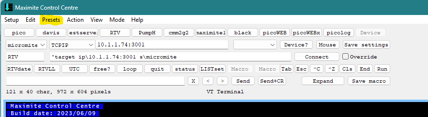

MMCC has a row of 12 'preset' buttons to easily switch between devices.
I ran out of buttons so MMCC now has a 'Presets' menu.
The first 12 entries are duplicates of the 12 buttons but you can have a total of 30 devices. That should keep me happy for a while.
If you are short of real-estate, you can hide the buttons and rely on the menu. Handy on laptops.
